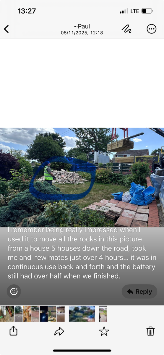

See below re battery life

Thanks for this. I did notice Lumags were no longer listed on the Sandhill site, that makes sense.
Interesting info in @doobin 's latest post re: battery life being much better than expected.
This is a great reference thanks. Seems given the price point that it's a good option.
It'd probably pay for itself relatively quickly for us, but out of interest, do you know how long he's had it? If so, is it still running? I think they've been available for three or four years.

He must have had it a year or so.
