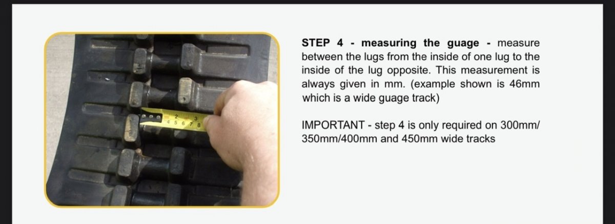

ALSO after the pitch size is either a K or an N .... what does that refer to ?
Not sure about K, but I`m fairly sure N is for narrow, and you can get a W for wide.
