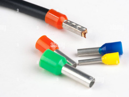

Last one I used was dead from new.
Pulled it apart and the wires used were so fine it's doubtful they'd carry enough current and two had been sheared when the screws were tightened.
Screws bearing directly on multi-strand wires are exactly why trailer wiring is unreliable
Bootlace ferrules pretty well solve the problem

the 'real' crimping tool does a nice job, but I've never bothered - they work well just giving them a squeeze with pliers.
Makes a big difference the real tool though especially in tight connectors . And plenty of cheap copies about now rather than £120 from knipex 🤣
got a set and work really well for the amount i use them (y)

I like the bootlace variety because you can get them in the correct size to suit the cable.
Also, each size is available in different colours so can be used for identification (if you are prepared to carry the extended inventory).
I buy them out of china where 1000 costs the same as 25 locally.
