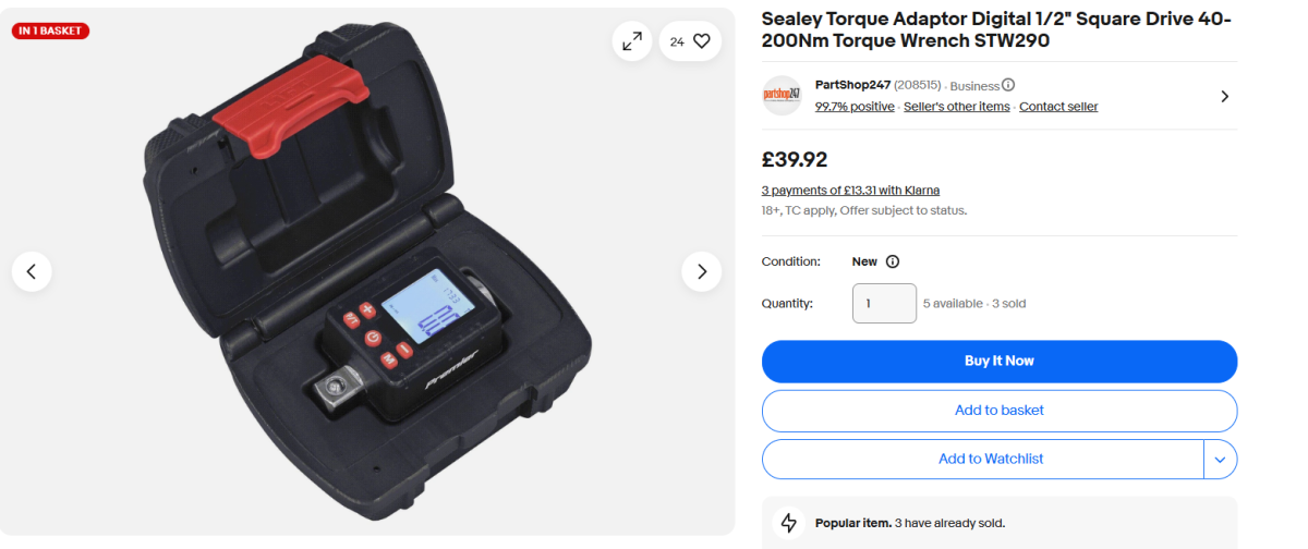

thats neatI got a different type of torque wrench the other day. It goes between the socket and 3/4 inch rachet and has a digital display. No idea how accurate it is .
It was 160 when i bought it.
also do a 1/2" one toothats neat![]()
whats the snag do you think ?also do a 1/2" one too
View attachment 78748![]()
Sealey Torque Adaptor Digital 1/2" Square Drive 40-200Nm Torque Wrench STW290 | eBay UK
Proven Reliability: With a rich history of excellence, Sealey tools are trusted by professionals worldwide. Large LCD display with LED/audible alarm indicating achieved and target torque levels. 1 2 3 4 5 6 7 8 9 10 11 12.www.ebay.co.uk
have given some thought as to their use at the top end of an extension and can't see that it'd be an issue as the same torque would be transferred down the length of the bar - I think?whats the snag do you think ?
access ?
I think the extension would twist to a degreehave given some thought as to their use at the top end of an extension and can't see that it'd be an issue as the same torque would be transferred down the length of the bar - I think?--- 's an interesting conundrum
's what I'm trying to decide, but'd need the same level of torque to do that - can't get my head around it TBHI think the extension would twist to a degreeso wouldn’t give a true reading
maybe
Definitely. Low torque it’s negligible but when you start pulling 200+ Nm on foot of 1/2” extension it does make a difference. We tried it at work to settle a discussion. It’s when you’re getting near to the point where the extension physically can’t handle the torque and is getting towards its elastic limit.I think the extension would twist to a degreeso wouldn’t give a true reading
maybe
was thinking more along the lines of a stumpy 2" or 3" extension to get the unit away from the socket ... a 12" would without doubt flex big timeDefinitely. Low torque it’s negligible but when you start pulling 200+ Nm on foot of 1/2” extension it does make a difference. We tried it at work to settle a discussion. It’s when you’re getting near to the point where the extension physically can’t handle the torque and is getting towards its elastic limit.
