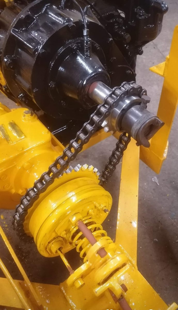

Hi all, new to the forum and wondering if anyone knows if the large clutch spring for a Thwaites Nimbus dumper is still available? Ive relined the clutch but its still slipping and the spring seems quite weak.

MikeE
MikeE
Yes its the brake shoe and drum type.

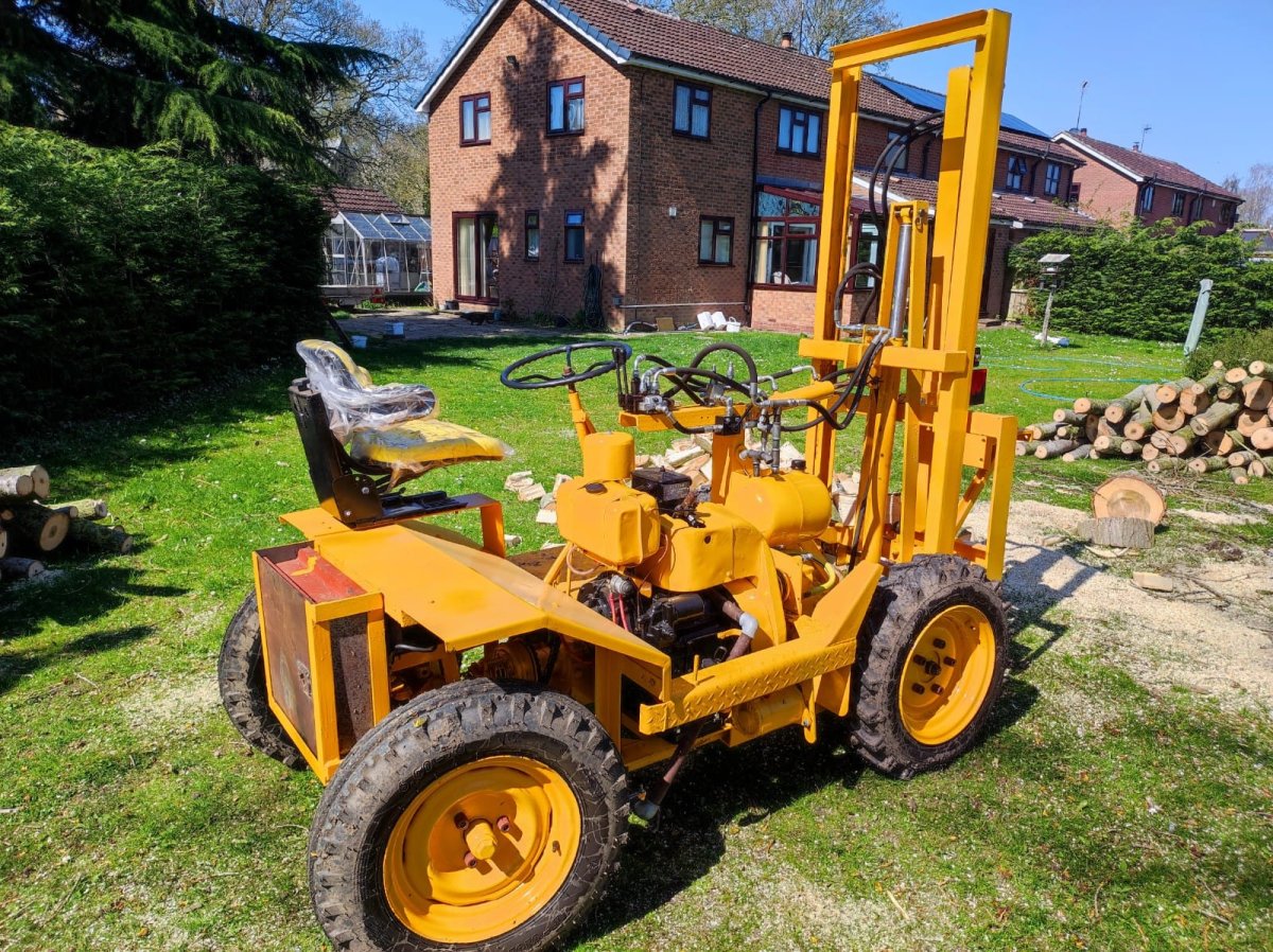

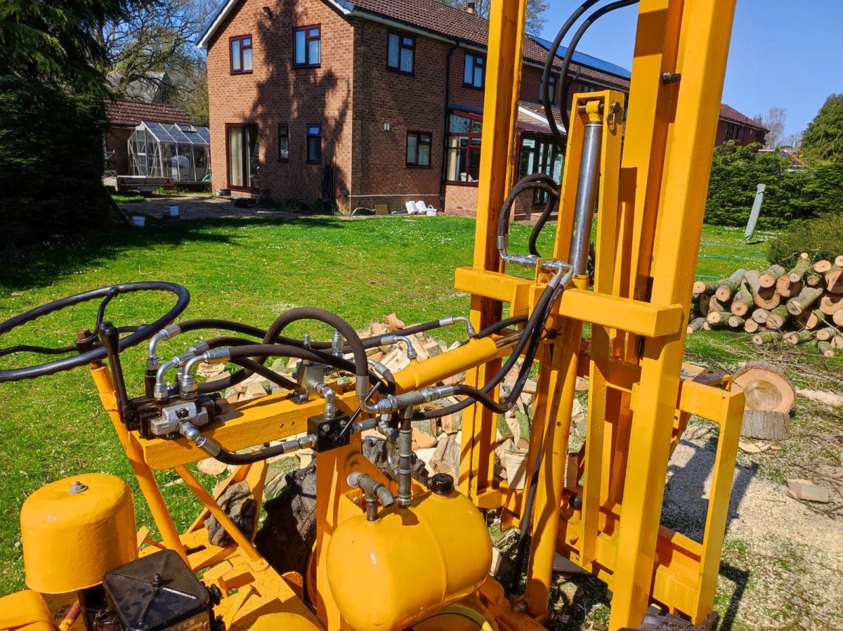

I converted a knackered dumper into a small forklift and Ive just made a log splitter to attach on the front.

Is the brake adjuster free, working, and adjusted up?
I did one with the adjuster damaged somehow and not working, can`t remember what now, but it needed a replacement, just the pull on the rod wasnt enough to get enough to drive without slipping.
Funnily enough I was speaking to my plumber on Wednesday, he’s currently doing up the same dumper - got talking etc and he said all the transmission parts are still available from a barge building company somewhere as they still use the engine/gearbox in them today! Might be worth a Google of some part names etc?
