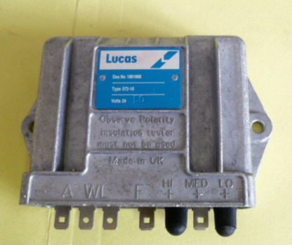

some alternators had separate remote regulator packs -- all my cranes did, but were 24v -- part no 1861668

Thanks V8. Judging by the extra wires with spade terminals, it's my suspicion there may have been something like that fitted at a time.
