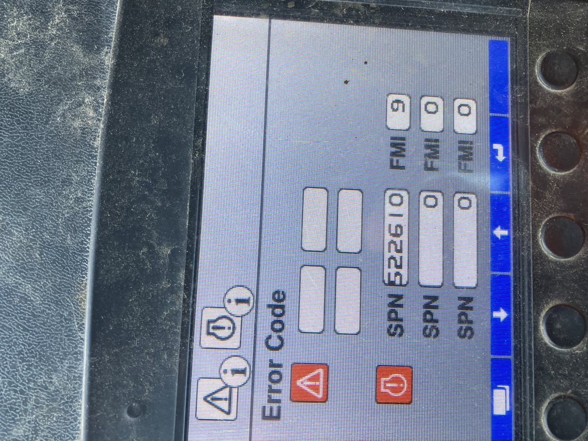

Does anyone have any idea what resistance there should be across the terminals of a egr valve on a Yanmar TNV98ct engine, as fitted to my Takeuchi TB280fr ?
i've had a egr related fault code come up, dealer (helpfully) sent over a test procedure but its for a 6 pin plug and the one i have is 4 pin, I've had a fitter test the resistance which was well above the 15 ohms required in the test procedure but I'm not very confident he tested the 4 pin plug correctly ? as he said it was 31 and 40 ohms ?
I'm trying to avoid spending £650 on a replacement egr valve unnecessarily but at the same time getting the machine working again asap.
The DTC code indicates - lost communication with egr module.
Sprayed some egr cleaner through the inlet which has cleared the fault a couple of times, which i didn't expect ?
