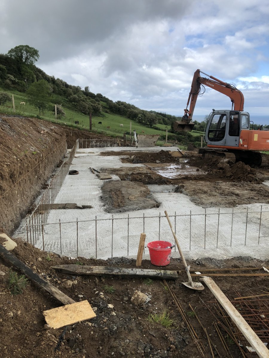

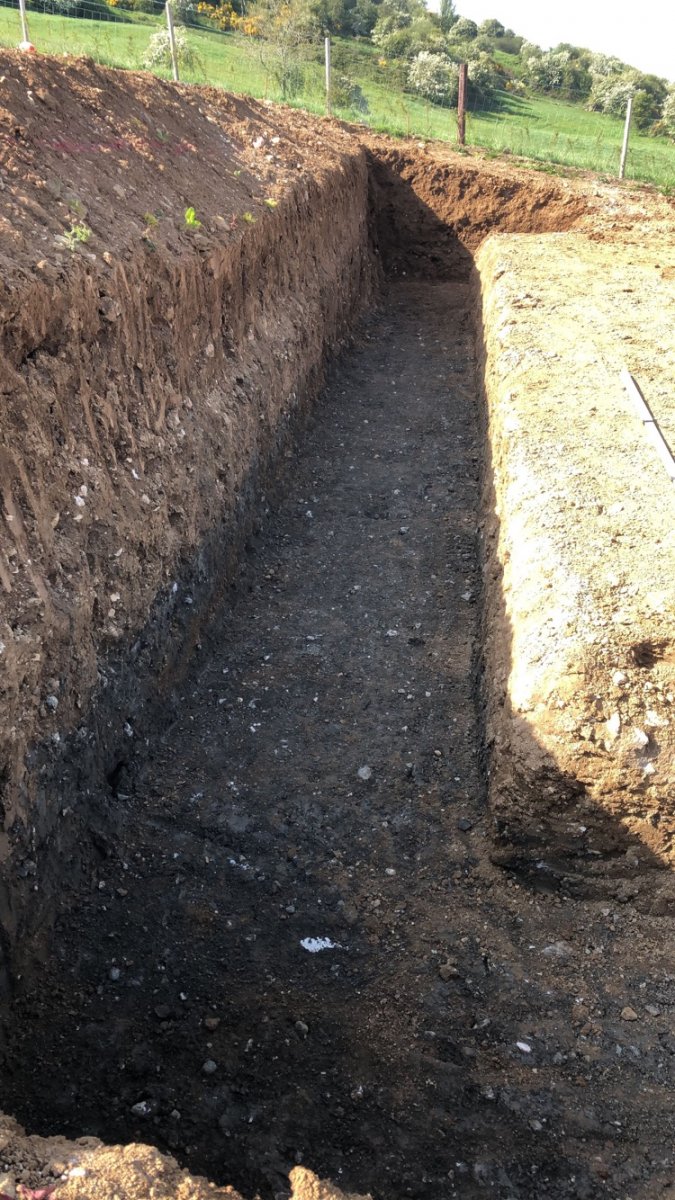

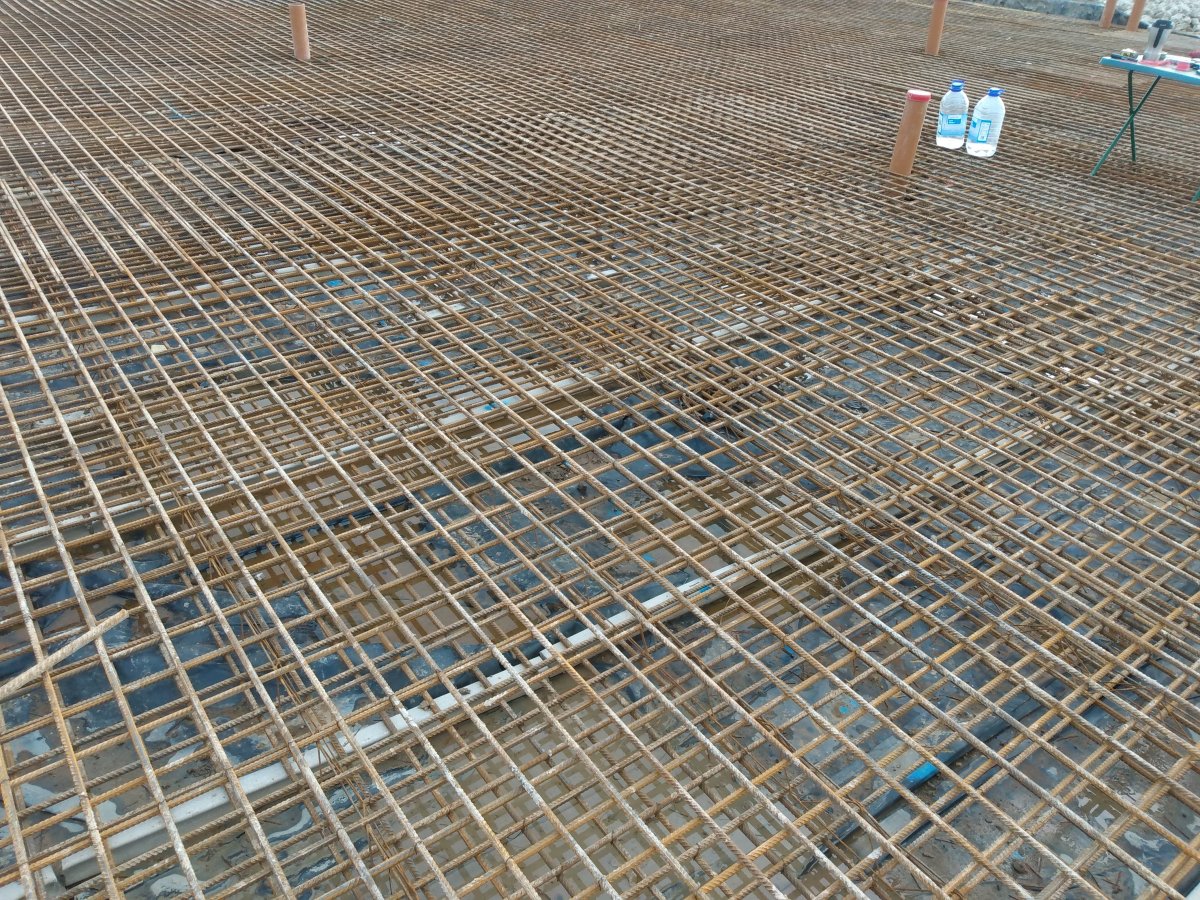

My latest query on a job.
Pure sand to 2/3 meters deep as right next to a beach - structural engineer specified - dig to 1m125, .225m of concrete no mesh in the foundation 900mm of blockwork and then concrete slab
Just goes against anything I've ever been taught
I’ve come across 2 jobs recently where the SER specified no steel mesh in the found .
I did query it but they said it was fine . First time in years I’ve seen something not actually over engineered

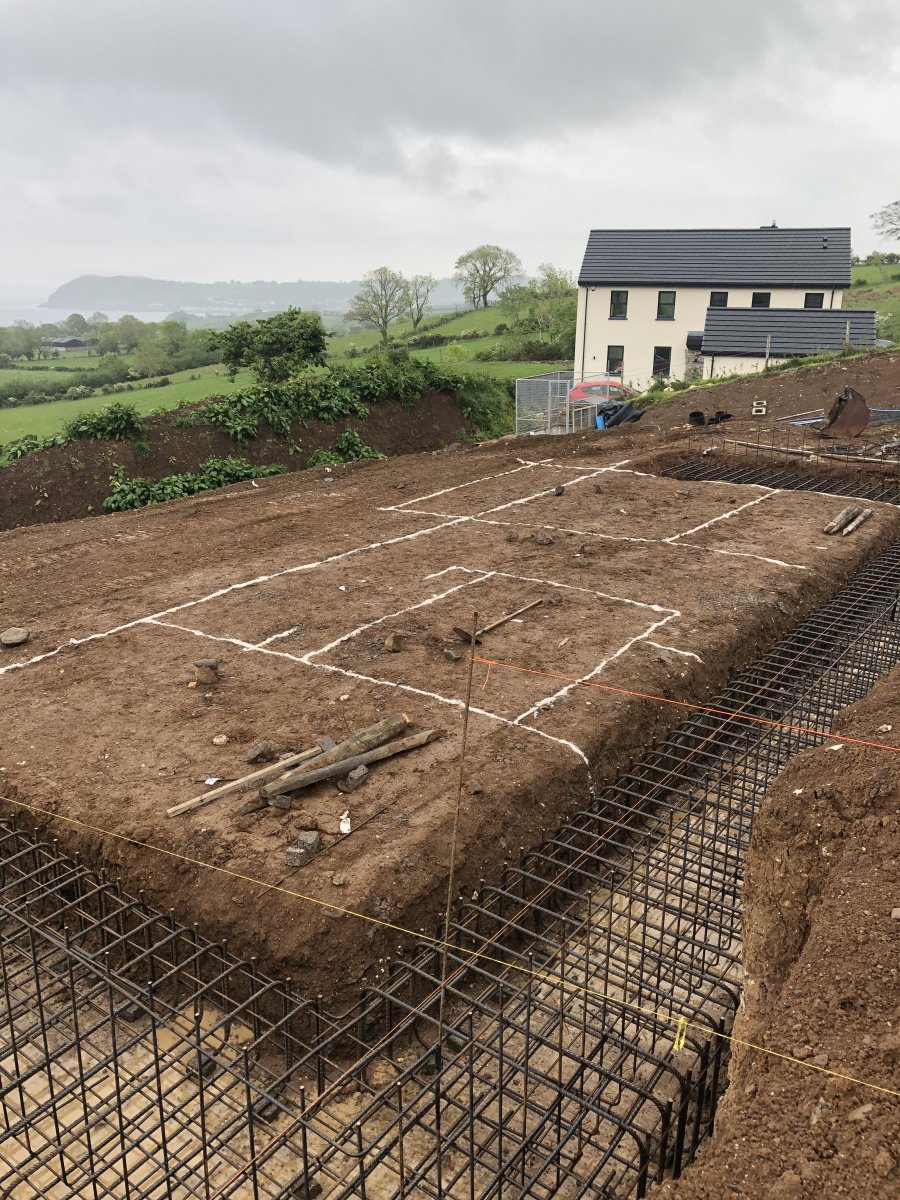

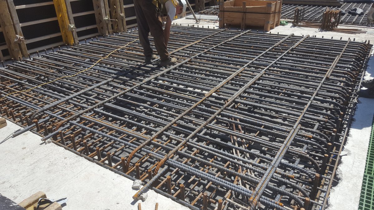

WTF were you putting on top of that lot :oops::oops::oops:
4 of these babies
on bed rock were they ? :ROFLMAO:

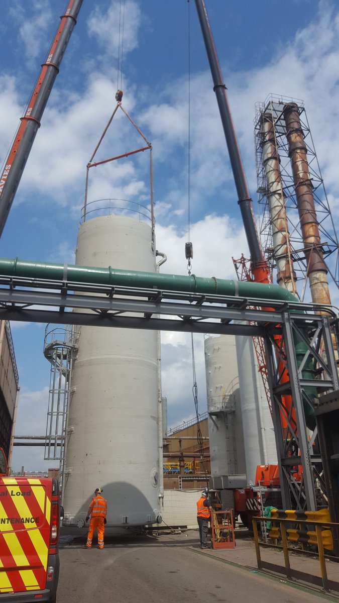

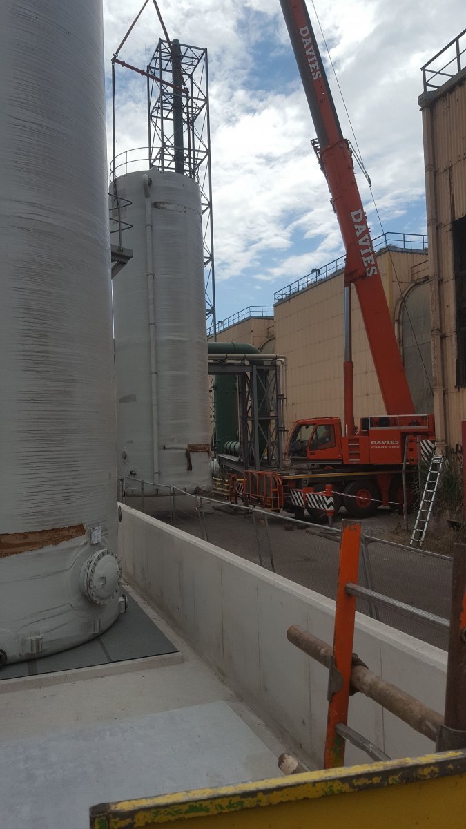

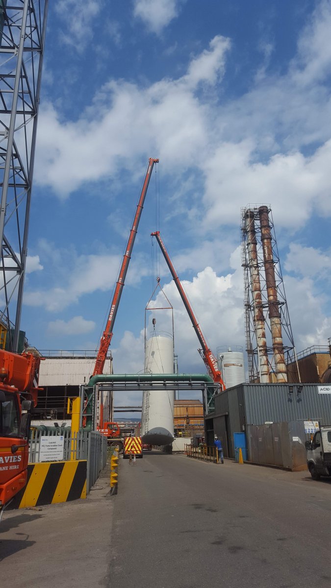

can't place the site, :unsure: but Carmarthen based Malcom Davies's cranes ;)
Yes I think 17 cranes in total on that job, because of the ineptitude of certain people, thankfully I only paid for a few of them!
