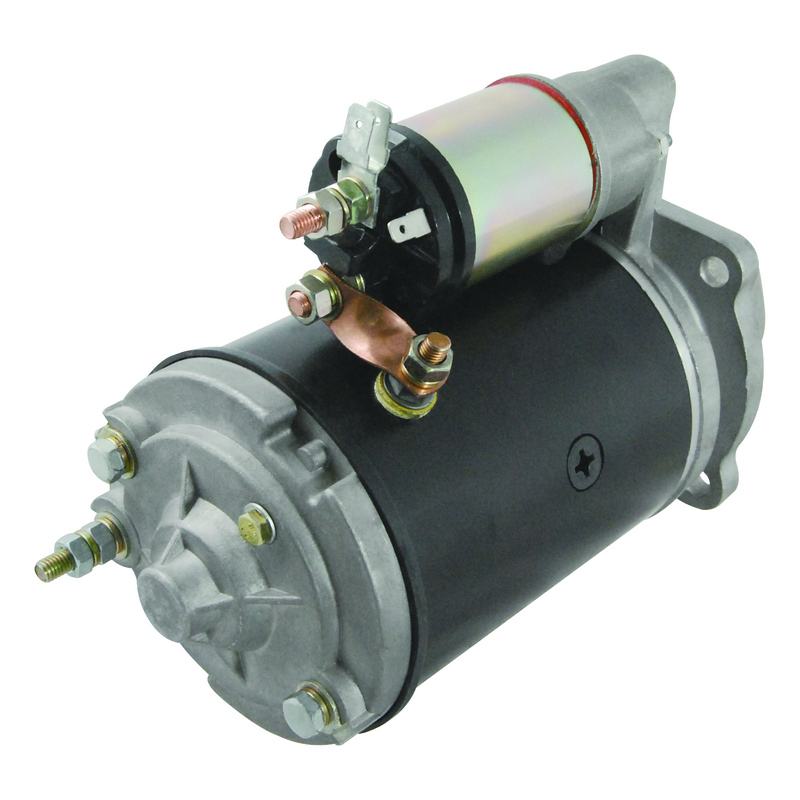

Anyone on here got a project 8 3CX, i had a friend helping me (think) at the weekend my machine would not always start, so i noticed the positive battery lead was going verdigris, i fitted a new one also removed the earth and cleaned it, i also had a spare good starter motor in the workshop which is where my mate helpfully removed it but did not note the layout, i cant workout which cable goes to the casing on the back of the starter motor, i have a wire with spade terminal which is for the starter solenoid, then i have a bunch of all yellow wires wired into one ring connector, also a second bunch of wires on another ring connector and lastly the positive lead from the battery, i looked at the starter on my project 12 but its totally different to the project 8, i hate wiring diagrams too which does not help matters, so my question is where the the 4 connections go to. Pictur of starter attached showing the connection at the back of the starter casing. Thanks in advance

mine stopped starting a long while back ... that was an additional earth on ring terminals on that post ... you'd think it was adequately earthed, bolted to the engine block, but that post must earth summat inside ??? not had an issue since .. would make for a good immobilizer :unsure: who'd think of those earths ;)

Thanks for that i wonder what my additional bunch of wires do, i will get a meter on them and see if they have any current running through them, I think i will run an additional earth from the back of the starter to somwhere on the engine block an additional earth wont hurt. (y)

Got it all sorted today there were a buch of wires that went to earth on the starter everthing else cleaned and done up tight and she fired up straight away, Happy days.
that's the ones, had me foxed too :rolleyes:

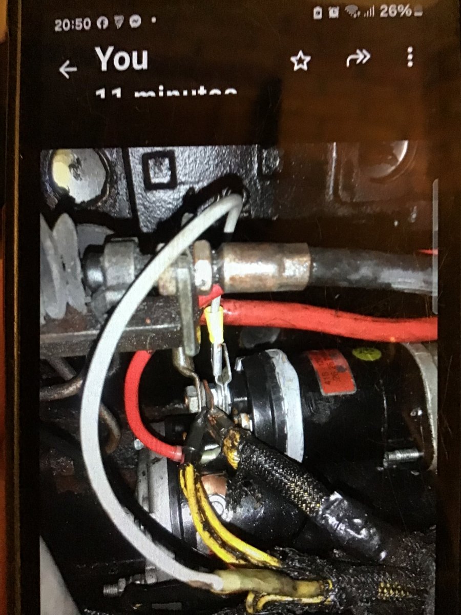

Remembered to take a pic of my starter solenoid. This is a late P8, which probably explains the differences

Hi topkit I have same issue pulled dash half apart changed ignition etc if you could send me a pic of your starter that would be great

Thanks all got sorted as ye said had a bunch of yellow earths in wrong place
