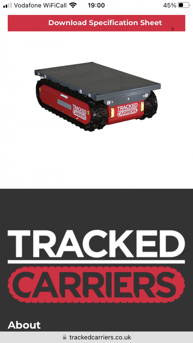

What tracked carrier have you got?
Grahams
Grahams
