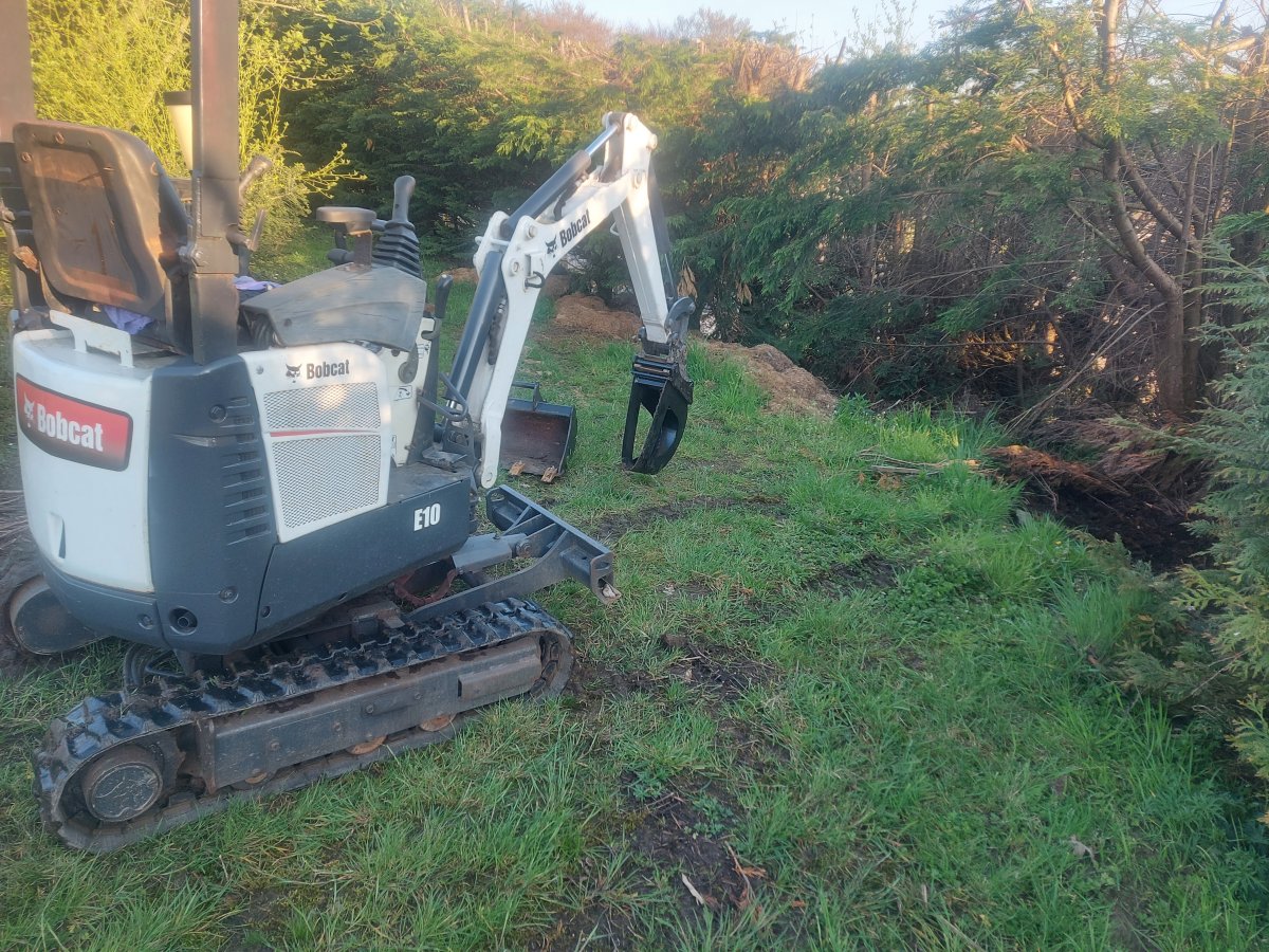

So I got some 60mm drain pipe for the garden, was meant to be an Easter Monday job but with so much rain on Easter Sunday it was put off.. a few evenings during the week before Scotplant and we are almost sorted.

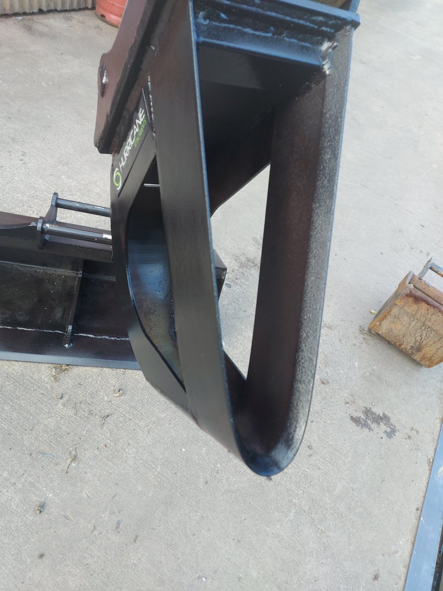

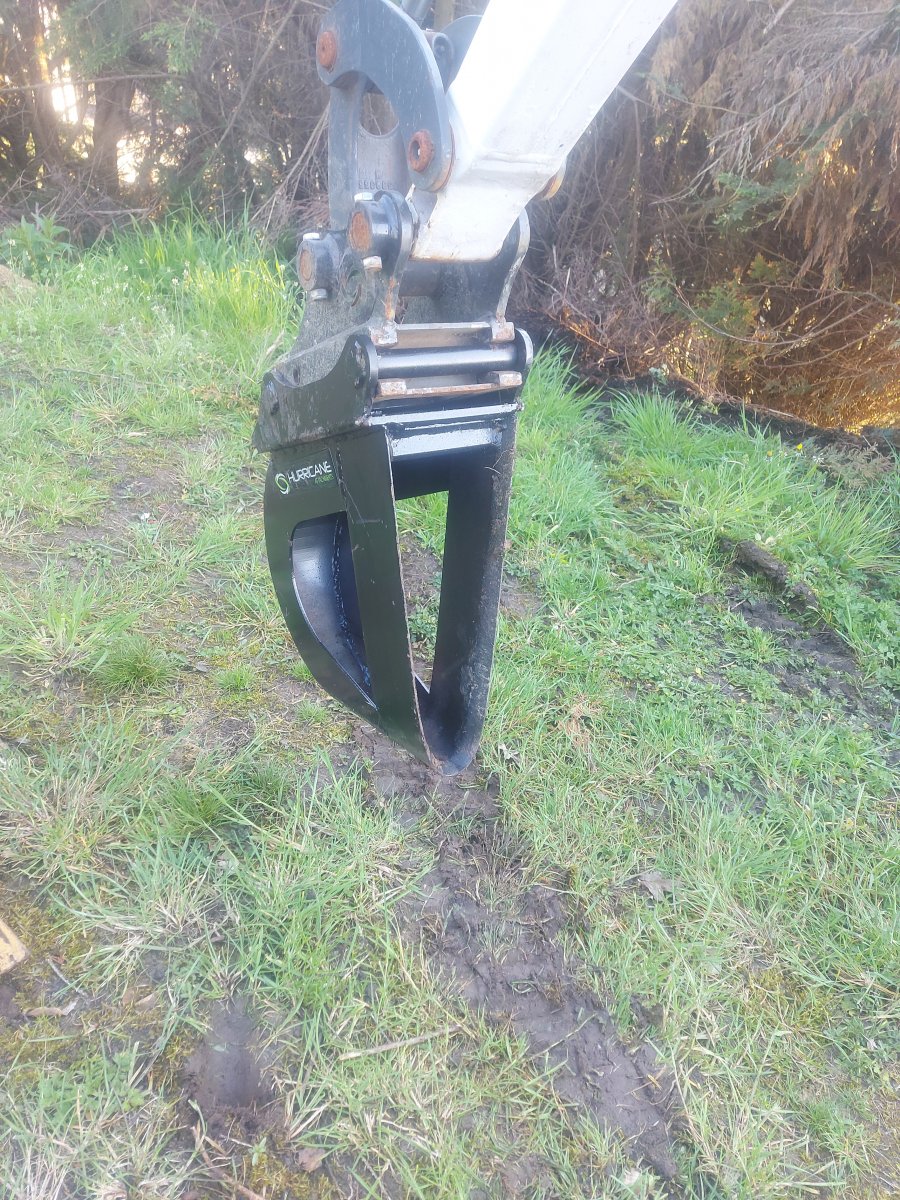

Built a shoring bucket (drain bucket to most of you😁) with a nice round bottom which the pipe sits in nicely.

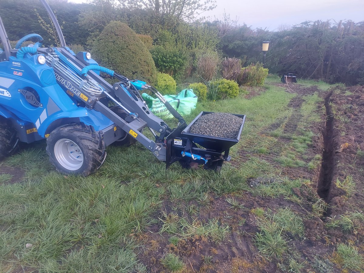

Then with our custom built band drainer run a few drains around various bits of the garden. Worked well but the stone I got was too big, I left it till Easter Saturday and was all I could get, some nice round 4-5mm pea gravel would be perfect.
