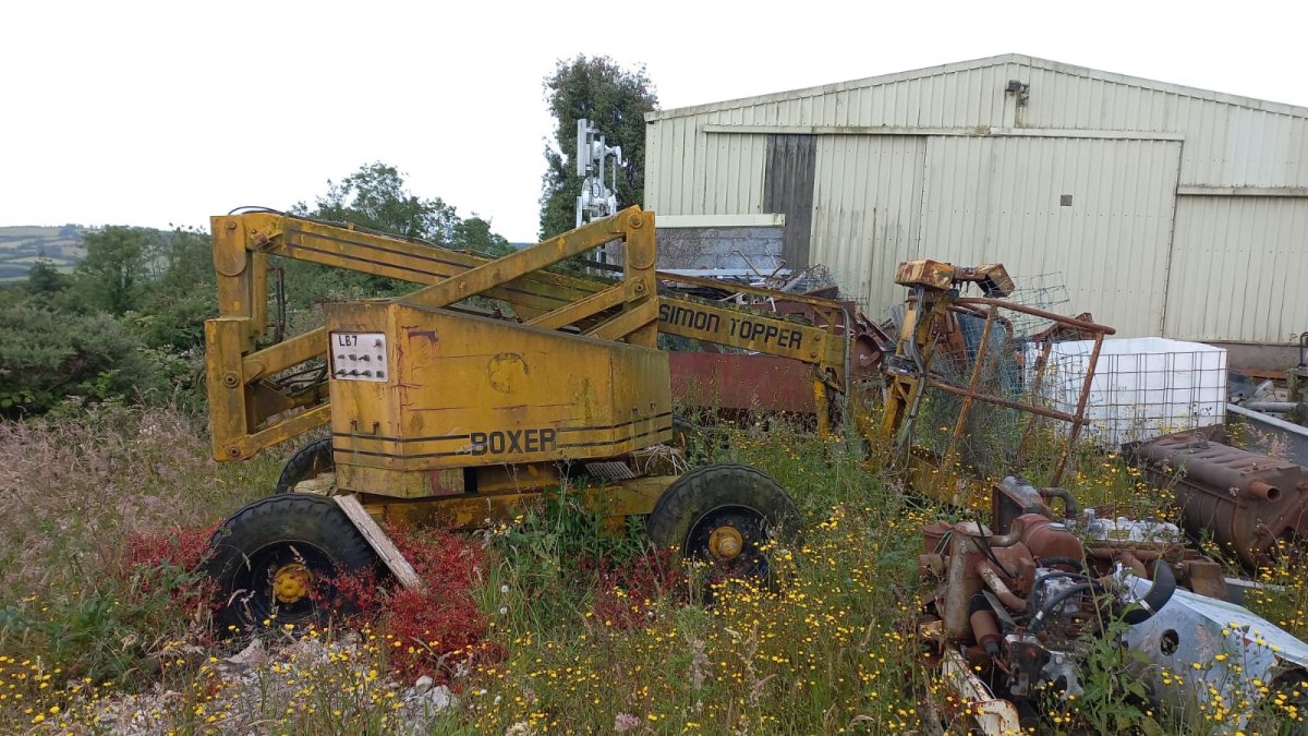

Simon Topper Boxer cherry picker .

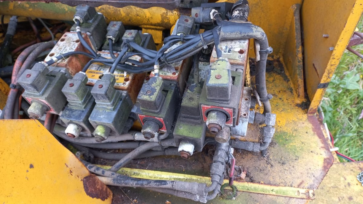

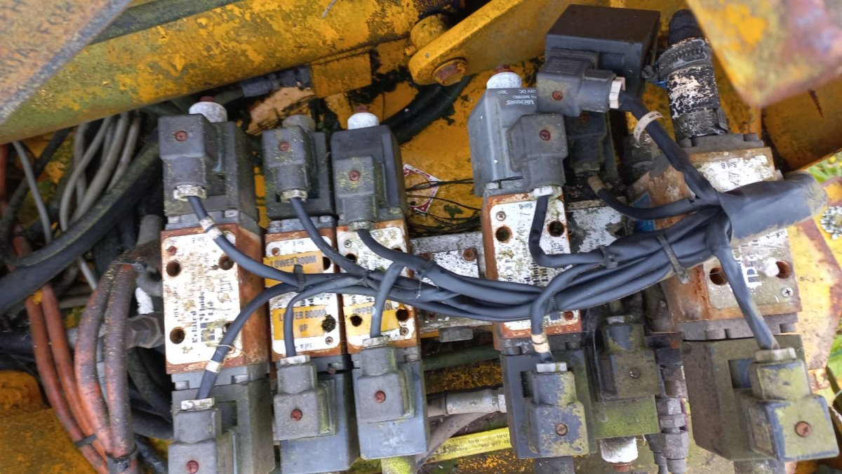

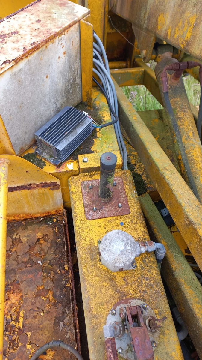

Ah I see the cetop link now. I’d say the plug tops and coils will be the issue, but we’ll see.
almost certainly ...
as I said to Aiden earlier, be cheaper to replace the whole cetop valve blocks on the manifold, than try to source replacement coils, unless you strike real lucky on
(a) finding them
and
(b) at a decent price ......
hence the link .......
no such thing as a std coil on these things ...
getting the right physical size and wattage can be a nightmare.
replacing the DIN plugs is the least of the issues
