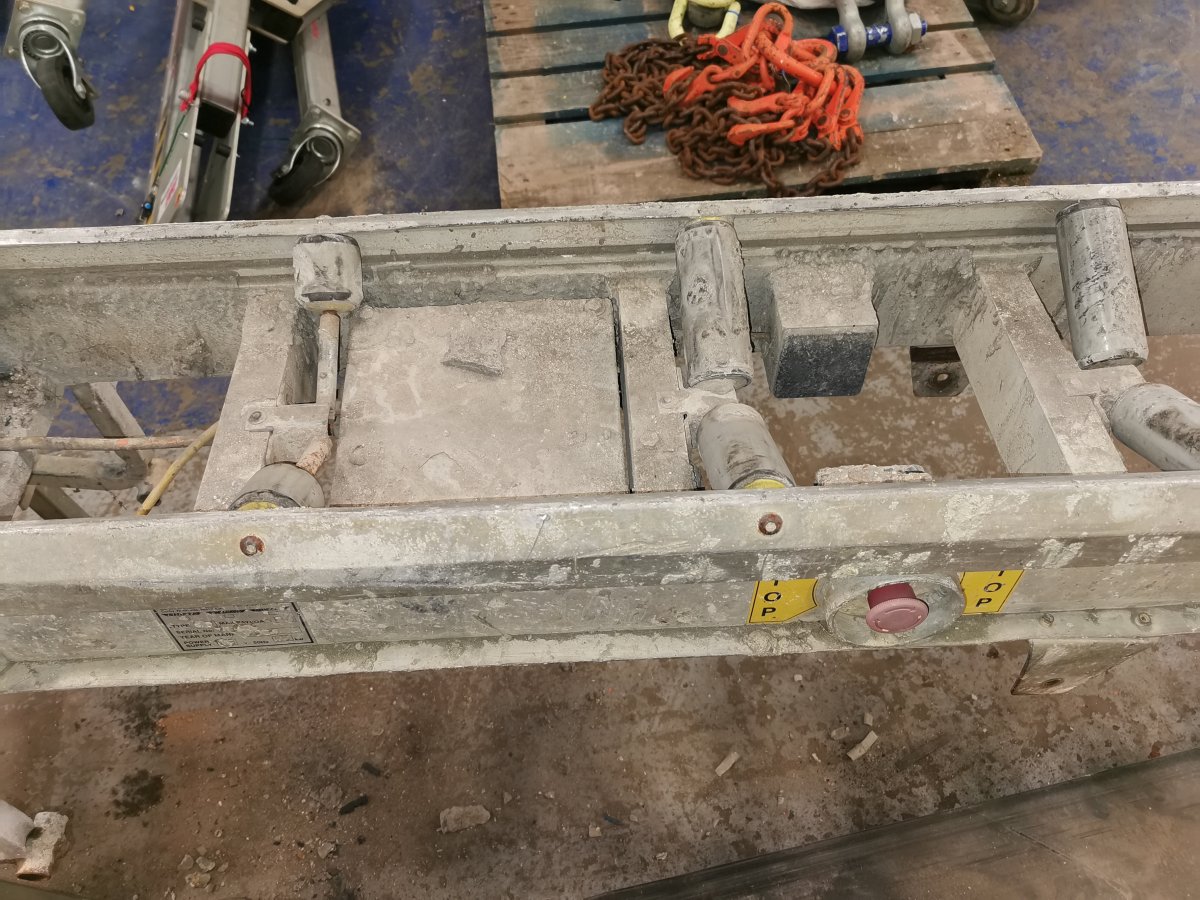

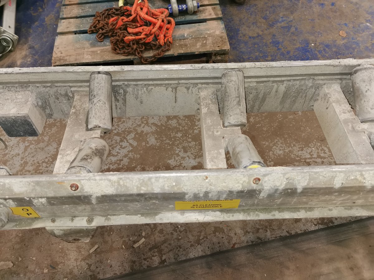

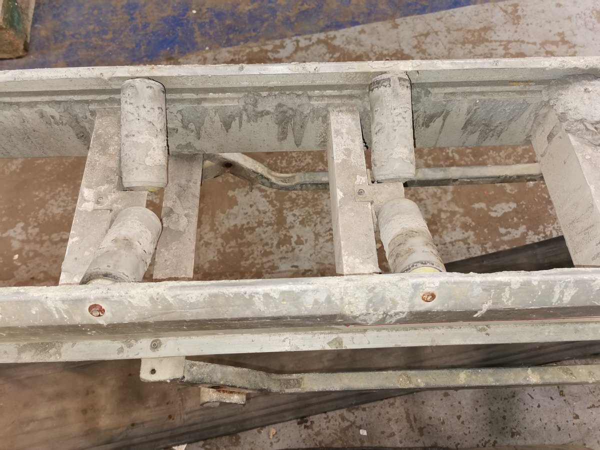

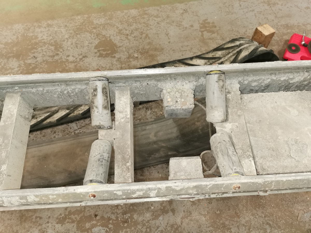

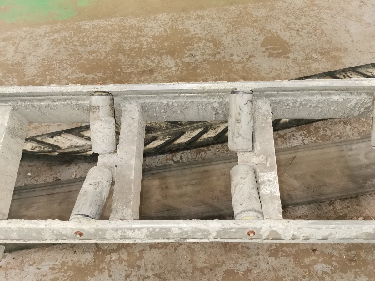

Been meaning to start a bit of a blog on here so you can see some of the fun stuff I get to deal with as a lifting fitter. Most of the time it is dull boring stuff like a bent hook or a stretched chain leg but some times you get the odd job that makes you think WTF and this will be the thread for them lol. Will start off with this little beauty a few of you on here might recognize this already but for those that don't it is a mace shifta basically a 4.5 metre conveyor for rubble muck and in this case cement. It was brought in to me by one of our customers who had it out on hire to a few of there's over the year or so. Apparently it had been though a few of there hire yards and never cleaned before it got to the one who brought it in to me. to get it to this state so i could quote for the parts I would need took over a hour as the bolts had seized and my little impact wouldn't budge them and also had to cut the axle off the sodding thing as it had been mushroomed before i got to it. So far with out labour it is will be around £900 in parts as needs a new belt all new rollers new axle and all the nuts and bolts replacing have told my governor it will be at least another 2 hours labour maybe more depending on how nice they want it in the end

Cleaning is chargeable :LOL:
If someone was charged for cleaning they where ripped off,
or got away with returning it caked.
Most probably let off with the old well we got it like this so you cant charge us line to be far that is the worst one i have ever seen and should think it is a few time out on hire and just left each time
