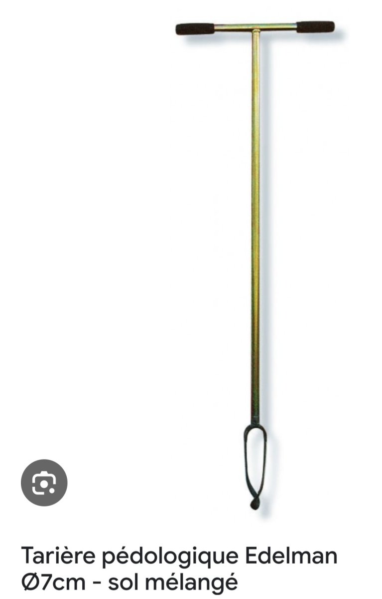

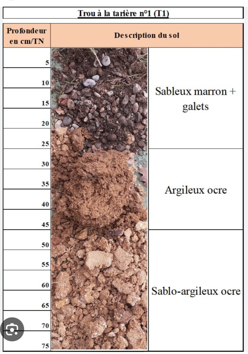

Occasionally I go with a mini for the guy I use but most of the time done with a hand tool and the report contains samples from around the site like so.
