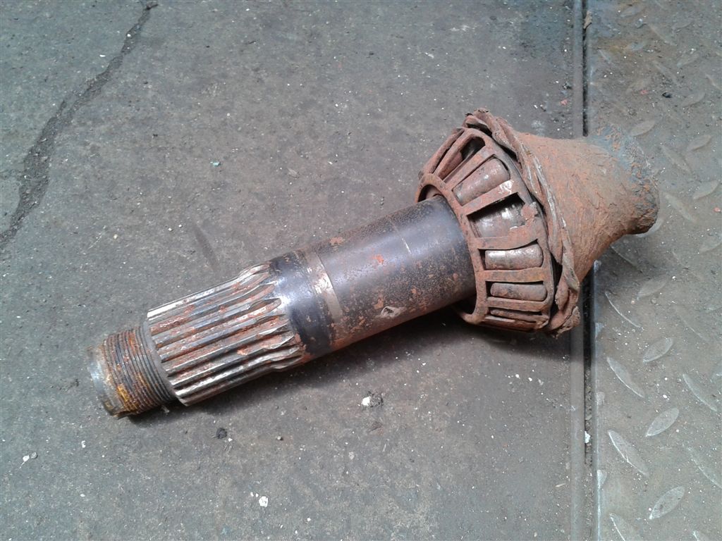

pinion from a mates' Iveco recovery truck:oops: ..... had to be recovered :LOL: taking a customer's vehicle back to them .... tin plate oil pan on the back of the diff had rotted to tissue paper and let go on a long run ..... driver with radio on - usual thing ... noticed sod all 'til he started slowing down despite giving it more bell oil .... diff must've been glowing by this point :eek: ... those teeth are 'melted' into a burred mess :(

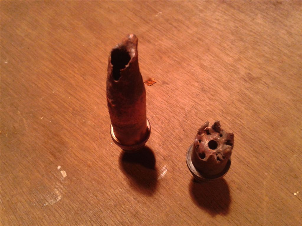

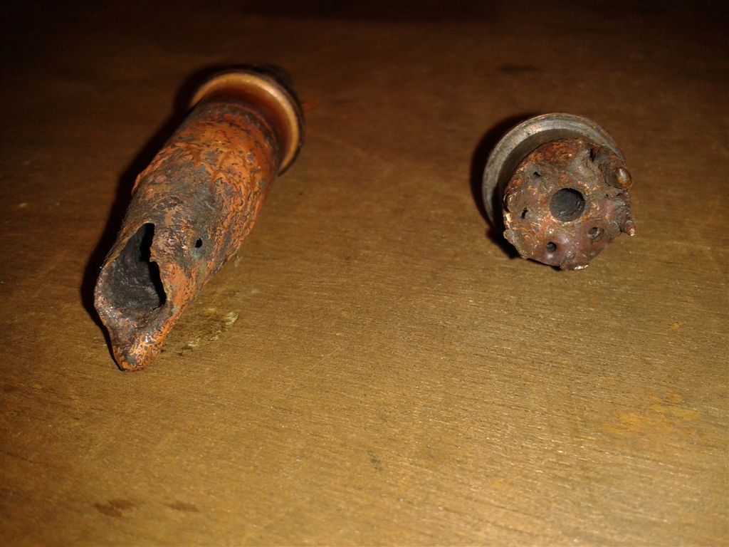

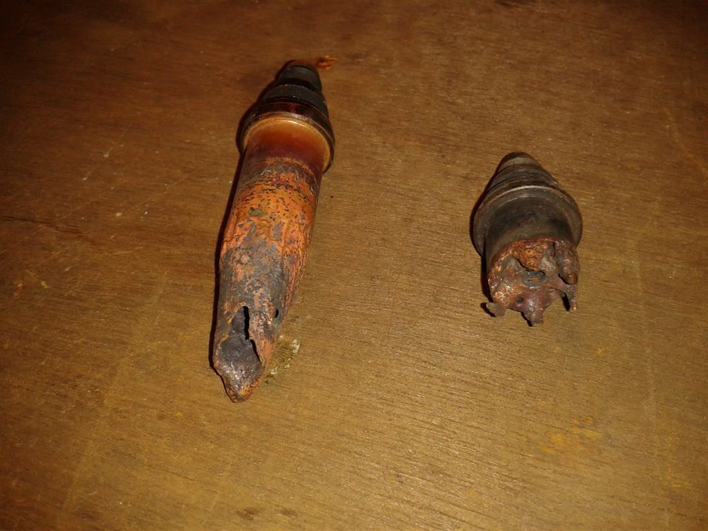

customer comes into me one day asking if I kept Oxy/DA nozzles :unsure: ..... and could I sell him a new one of these, as he was struggling to cut summat with them ..... :eek: ........ very lucky he didn't blow himself up with them :rolleyes:
