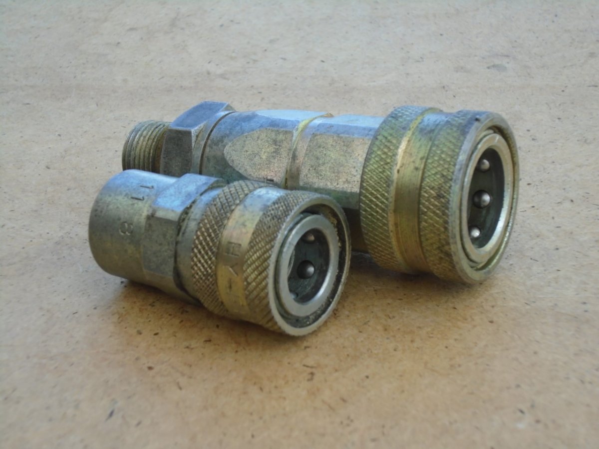

I have some of the above on my machine, two are leaking, have sourced some suitable O rings. Inside is both the O ring & the white nylon back up washer. Looking from the outside end the back up washer was furthest in - with the O ring nearest the open end.
If this was a ram gland it would surely be the other way round - the flat back up washer being there to prevent hyd pressure extruding the O ring through the clearance between the piston rod & the gland housing.
Has anyone got one of these to have a look in & see which order these two parts go in - the last owner of the machine did various amateur 'repairs' - so I am by no means sure he got this right.

Truth is it is a very old & small machine - a 5 Star Gopher as seen at base of this page http://www.oilyhands.co.uk/gopher_towable_diggers.htm These allow the drive wheel to be removed. I have sat on it for some years, it has other issues to fix. I do not want to spend too much on it till I know how viable it is going to be for either use or sale. I resented throwing the whole coupler away for what is a perished O ring. I looked into the whole 'o' ring sizing thing - % of compression or interference, & tried to identify what was there (though damaged) Got the rings from Leominster Hydraulics - sadly they have since gone out of business. My idea was to have spare rings to re seal for an instant fix - if others go.

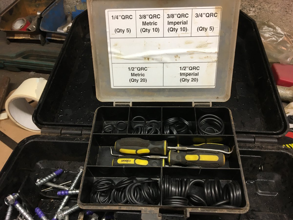

I’ve had this kit for years everything you need

Mog, I got some O rings a while ago, I made a ring removal tool from an old screwdriver - got the ring out - difficult to measure as the 'male' coupler part is 'oversize' (creates an interference fit) so I slid the ring gently up a morse taper end of a drill. Using an Aldi digital Vernier I got the 3/8 QF ring to be 17mm I.D. x 2.5mm thickness. This checks out with info I found on the net concerning gap width & dia, & % oversize of the male shaft. The nylon washer I have found should be nearest the open end.
The 1/4 QF takes as far as I can tell an 11.6mm I.D. x 2.5mm thick (no nylon washer present perhaps too small to need one). But this ring had a split through it - & I had a spare of this size coupler.
I did not have access to an 0 ring sizing gauge - it would be interesting to measure the sizes in your kit as a reference for future use of us all.
Maybe a hyds place would measure them in return for the info on what fits what.
Also would like to know where the kit can be bought in case I am wrong. I am about to start clearing junk from around the machine (it has been dry stored). So far I have re sealed a 3/8 - seems a good fit but we will se if it works when on the machine. The kit does show that the QF's can be re sealed. - I have 6 in total, & also a pair of flat faced on a hyd PTO - to run a jack hammer / wood splitter. Thanks anyway for the interest, would love to know if these kits can still be got.
Where are you based @Old Operator, the label on the box has long gone

The O ring sizes are correct! 3/8 ISO QR = 17mm x 2.5, 1/4 QR = 11.6 x 2.5 I am now leak free & have spares for 'in the field' repairs if needed. More importantly the machine is mobile again & can be towed locally if needed (via switching some valves - makes the motors free running). Machine is dry stored but stood for 6 yrs - Honda GX 140 started 3rd pull !! I am having to wrap a rope round - as last owner caught the pull start on a low branch - money saved on couplers will buy this part (Chongda clone spare). Thread coming on Vintage page on the ongoing restoration of Gopher.
Mog - it would be interesting to borrow an 'O' ring sizer gauge & identify the rings in the kit - that way we would have a resource of knowledge on the bigger sizes - not that it affects me at present.

Pm me your address (y)
