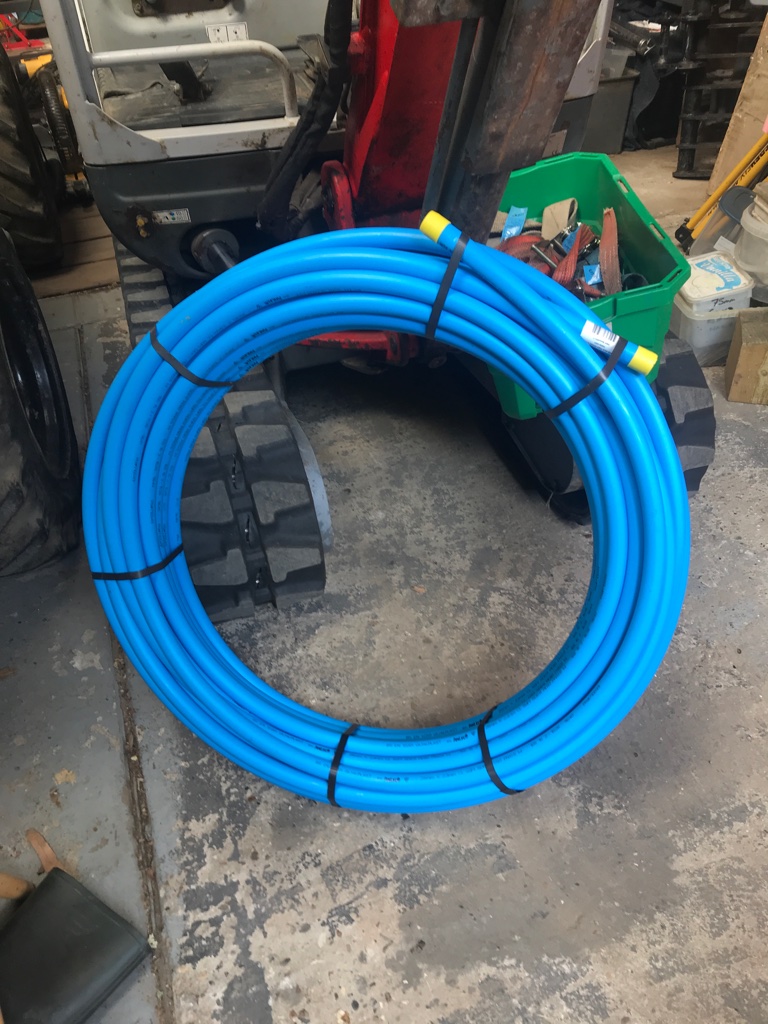

However, the next one that I planning to do requires only 18m off me 50m roll and is causing me a headache:unsure:

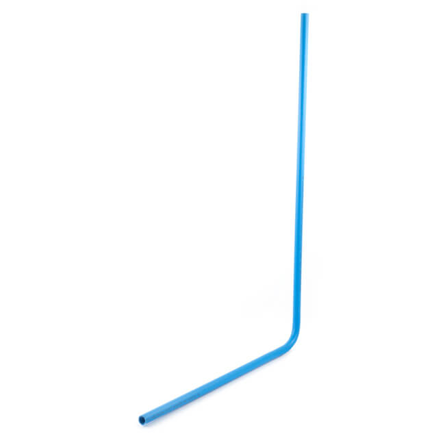

On an existing house, the easiest way is an Insuduct Kit up the outside of the brickwork
Then add a nice hockey stick
Got these in stock from BES
Done a few now - makes the connection part easy:ROFLMAO:

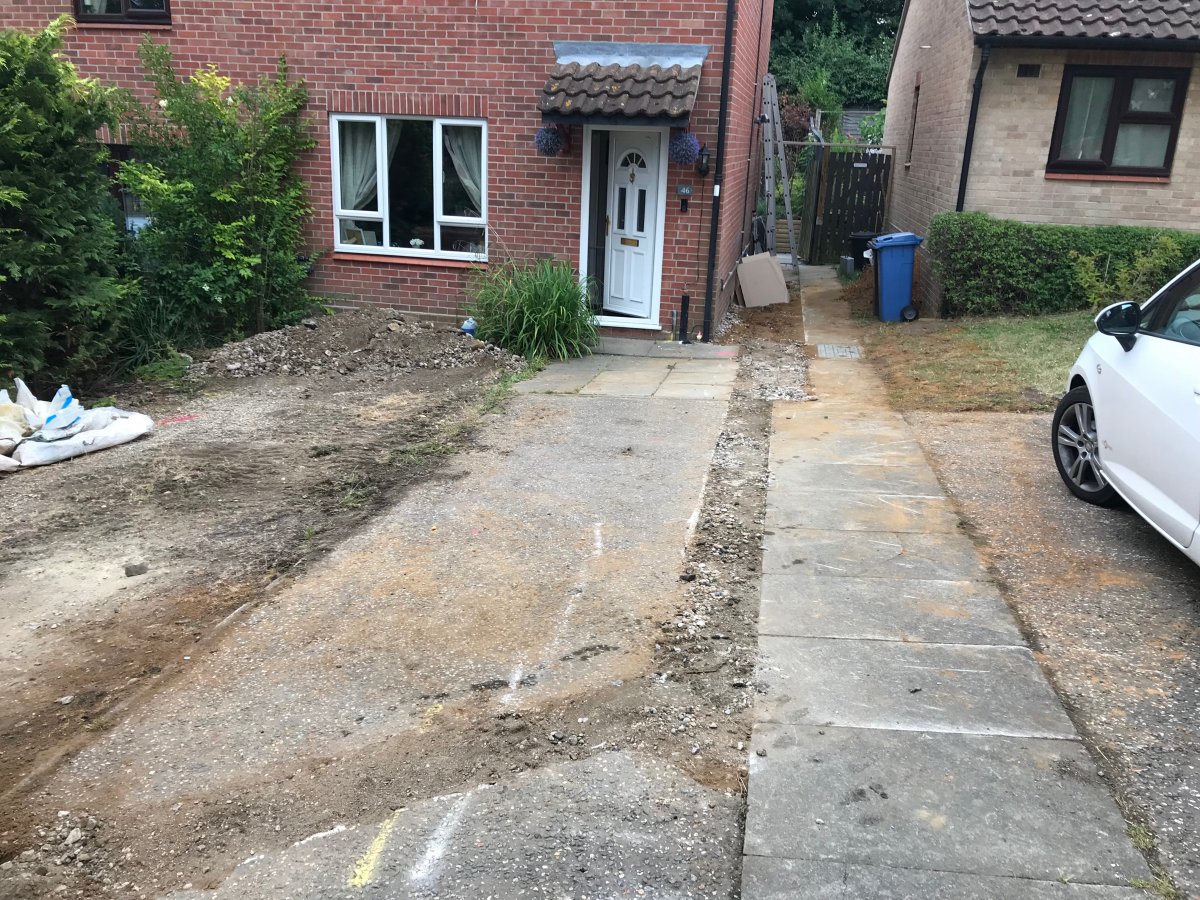

So we made a start today....
....it soon reached 28c - too much for safe digging around cables :ROFLMAO:

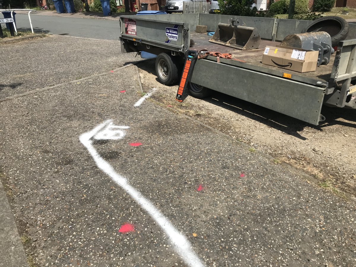

That red line is where my old Mk2 CAT was saying the mains cable went to the neighbours :rolleyes:
No cable in this section :oops:
The mains is PME with 2 cables looping in at the main fuse. This is where I induced the 33kHz signal. Stronger than plugging in :unsure:
After we clipped on to a spare pair on the BT cable it was obvious where it was :p
The red dots show the rough path of the PME cable with sensitivity on max and speaker on my ear - faint signal at each dot :rolleyes: more or less where we expect it to run back to the plans sent to us:geek:

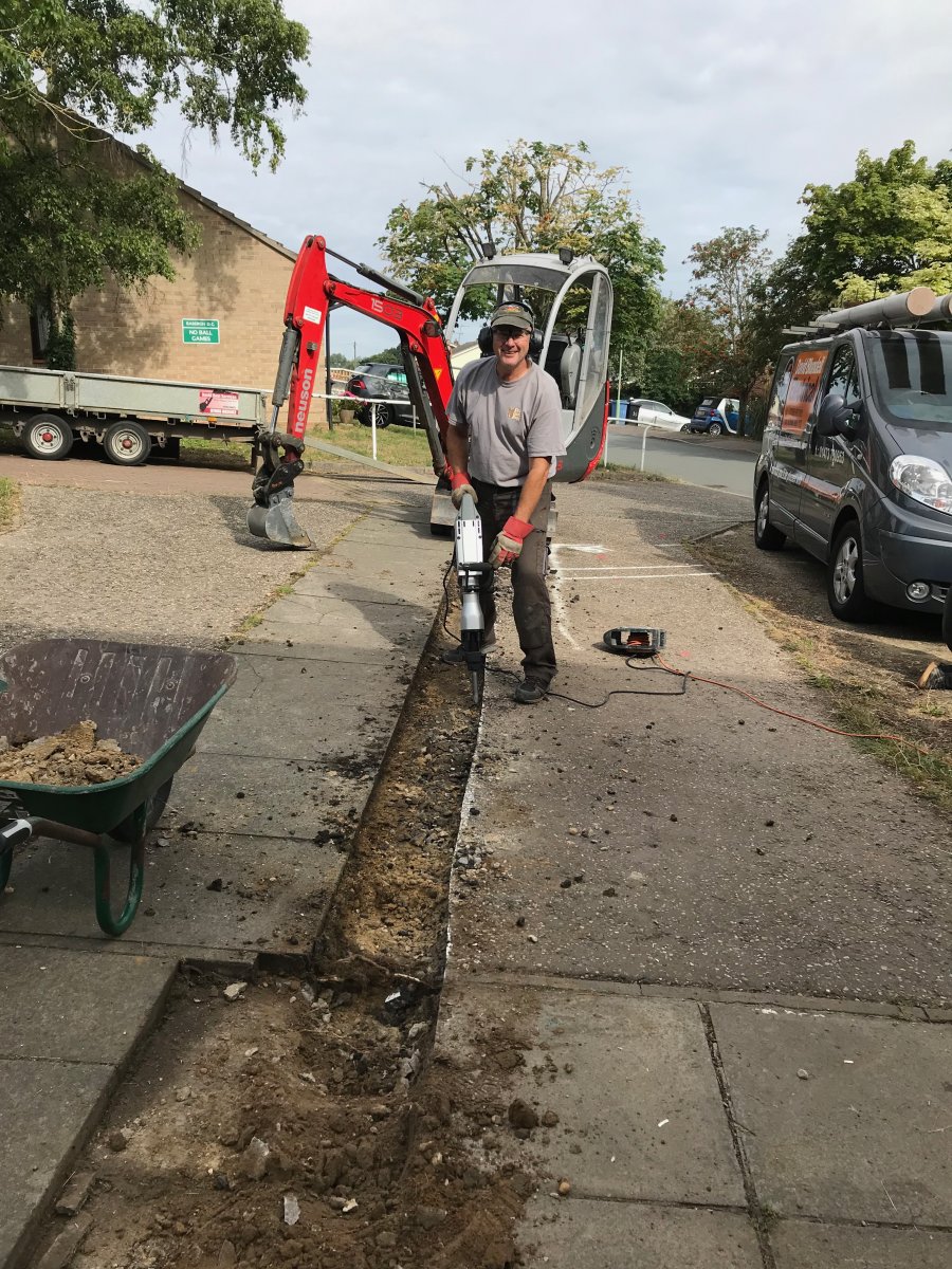

That's me with my brand new Titan 15.5kg breaker :cool: It was absolutely superb for first breaking out the tarmac then secondly breaking up the dry lean :D
And yes my 9" has it's teeth on for ripping up the break out stuff :p

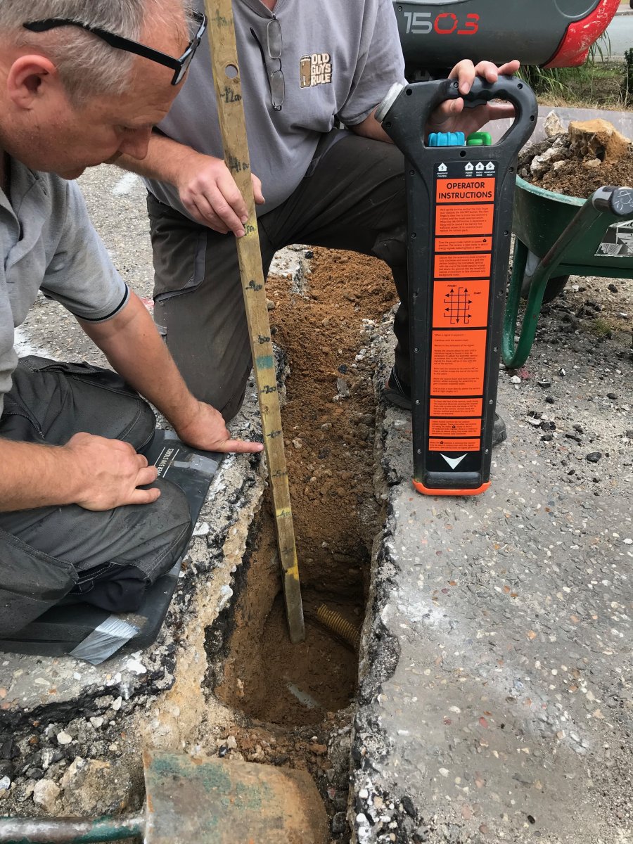

So, I said we must do 'safe digging' until we find each of the services. This hole revealing the grey BT duct and a yellow surprise :eek:
Yes the gas was running where its shouldn't have been :rolleyes:

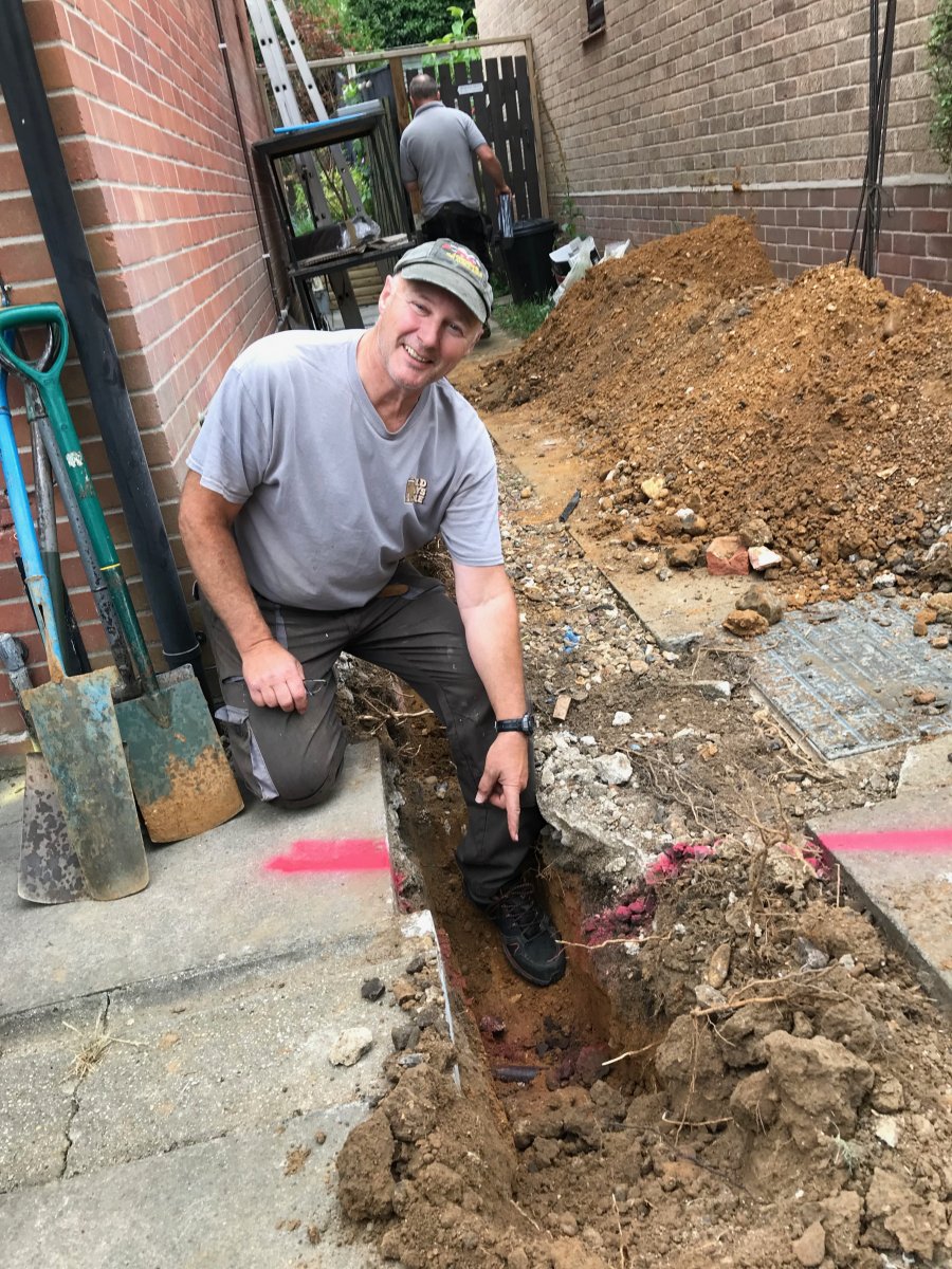

With the teeth of my 9" digging the main trench to 750mm resumed with all of us watching like a hawk :unsure:
Found the PME mains duct where it shouldn't have been according to UKPowerNetworks plans :mad:

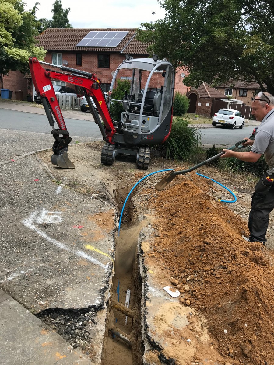

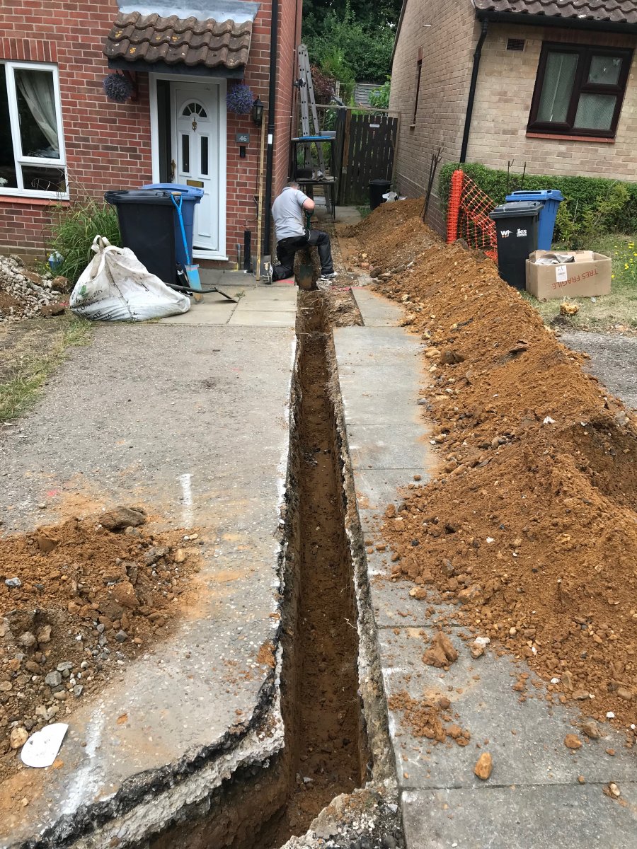

We finally got a nice trench dug out without damaging the services and drains :ROFLMAO:
Nice blue MDPE in with a generous covering of soft sand and blue marker tape :LOL:

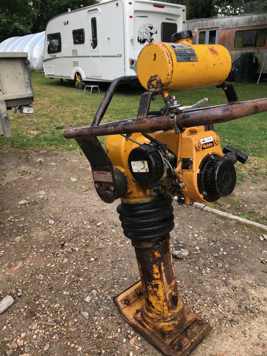

Fired up this old beast which paid dividends getting it wacked down :LOL:
That pecked out tarmac and dry lean was wacked nice 'n' tight on the top!

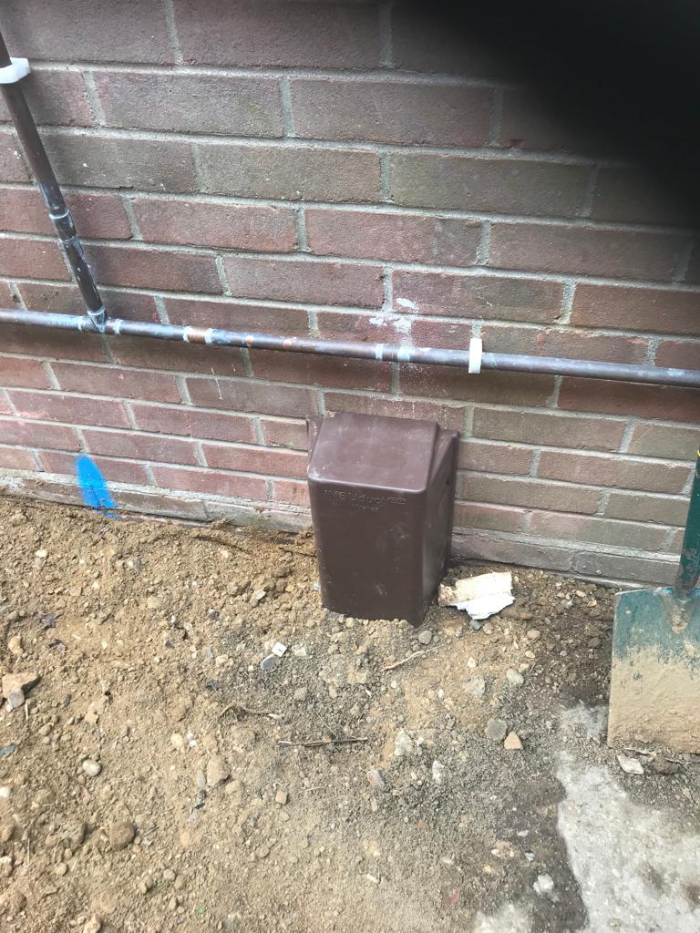

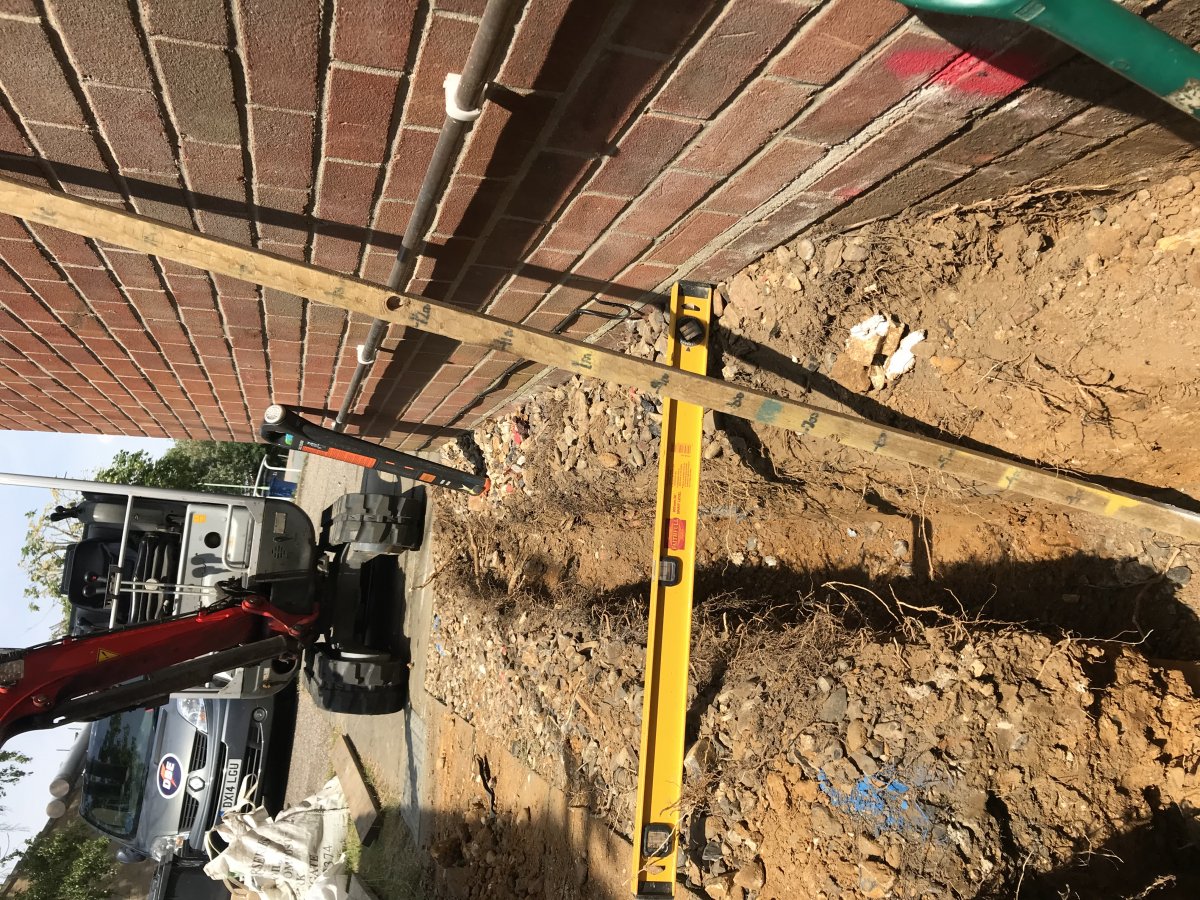

Nice neat entry to the side right beside the old alkathene rising main. These Insuduct boxes with a hockey stick are great for getting the job done and complying with WRAS :geek:
