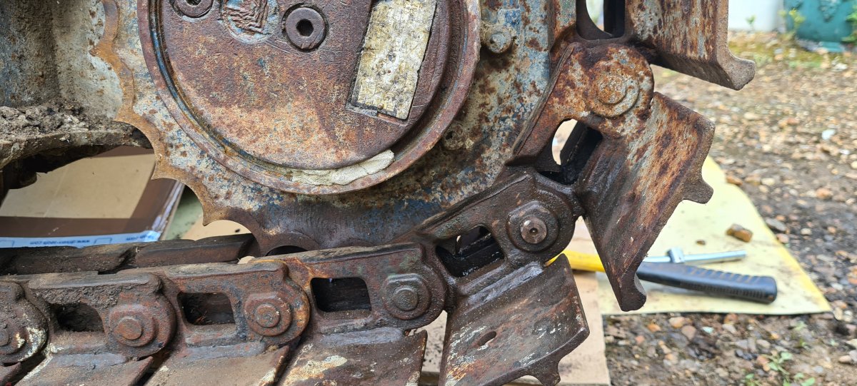

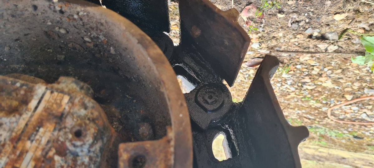

OK so have loosened of the track, and found the retaining bolt, does not look to have a retaining spring so... I am assuming it should just hammer out? Any tips? And which way? I assume the head shown is the thick end so I knock out from the inside of the track?

What are you going to do with the tracks once off? Looks to me like some new sprockets would be a good idea!

Yep new sprockets and new rubbers, removed the tracks in one unit, so looking to sell.

So if you unbolt the sprockets, slide the whole lot off in one go, roll the tracks up with the pin still in situ! Fit new sprockets, while tracks off slide out the idlers, clean all the crap out, release all the grease fit new rubbers, any help?

That's exactly what we did lol, gave up removing the pin. So now have two steel tracks for sale
