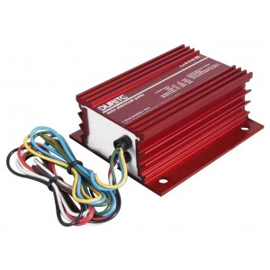

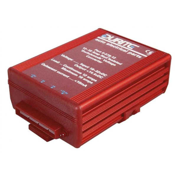

your dropper is going to drag your battery down though if energised all the time to supply it with 12 volts Vin
is it summat like these ?

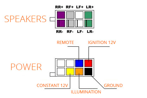

Yellow wire on radio are usually a feed for electric aerial maybe your back feeding power into radio and its cutting out after a few seconds
Standard Aftermarket Car Stereo Head Unit Wire Colors​
The easiest way to wire in an aftermarket car stereo is to look at car stereo wiring diagrams for the specific vehicle and head unit, but it's actually possible to get the job done without any labels, adapters, or diagrams. Unlike OEM head units, which are all over the place in terms of wire colors, there’s actually a standardized coloring scheme that most aftermarket manufacturers stick to.
Although there are exceptions to every rule, most aftermarket car stereos use a standardized coloring scheme for the power, ground, antenna, and speaker wires. If you have the pigtail that came with your aftermarket head unit, and it uses the standard colors, then the wires will have the following purposes and colors:
POWER WIRES​
  • Constant 12V / Memory Keep Alive: Yellow
  • Accessory: Red
  • Dimmer/illumination: Orange w/white stripe
GROUND WIRES​
  • Ground: black
SPEAKERS​
  • Right front speaker(+): Gray
  • Right front speaker(-): Gray w/black stripe
  • Left front speaker(+): White
  • Left front speaker(-): White w/black stripe
  • Right rear speaker(+): Purple
  • Right rear speaker(-): Purple w/black stripe
  • Left rear speaker(+): Green
  • Left rear speaker(-): Green w/black stripe
AMPLIFIER AND ANTENNA WIRES​
  • Antenna: Blue
  • Amplifier remote turn on: Blue w/white stripe
How to Identify Aftermarket Car Stereo Wire Colors (lifewire.com)
View attachment 22146View attachment 22147
I’ve not seen the dropper , It’s part of the machine electrics . I appreciate what your saying about the draw from it pulling the batteries down but this machine can sit for months and still start which makes me think could the permanent live be a very very low draw just for a memory only ?
