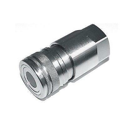

Yeah, just swap connectors. If you have different size ports on your machine I'm guessing it's single flow (not double acting)?
If your couplings are flat face, then for half inch you want a DN06 female coupling. Make sure you get the right thread on the end- they come in both 3/8" and 1/2"

Thanks all for the help. Flowfit threw me saying they would be different but the look just like that link. I'll swap the attachment coupling as I'm super wary about pressure on the digger side.
