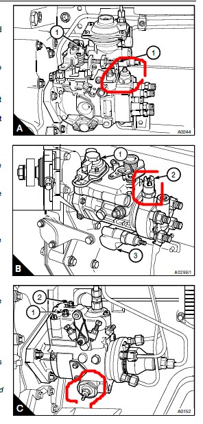

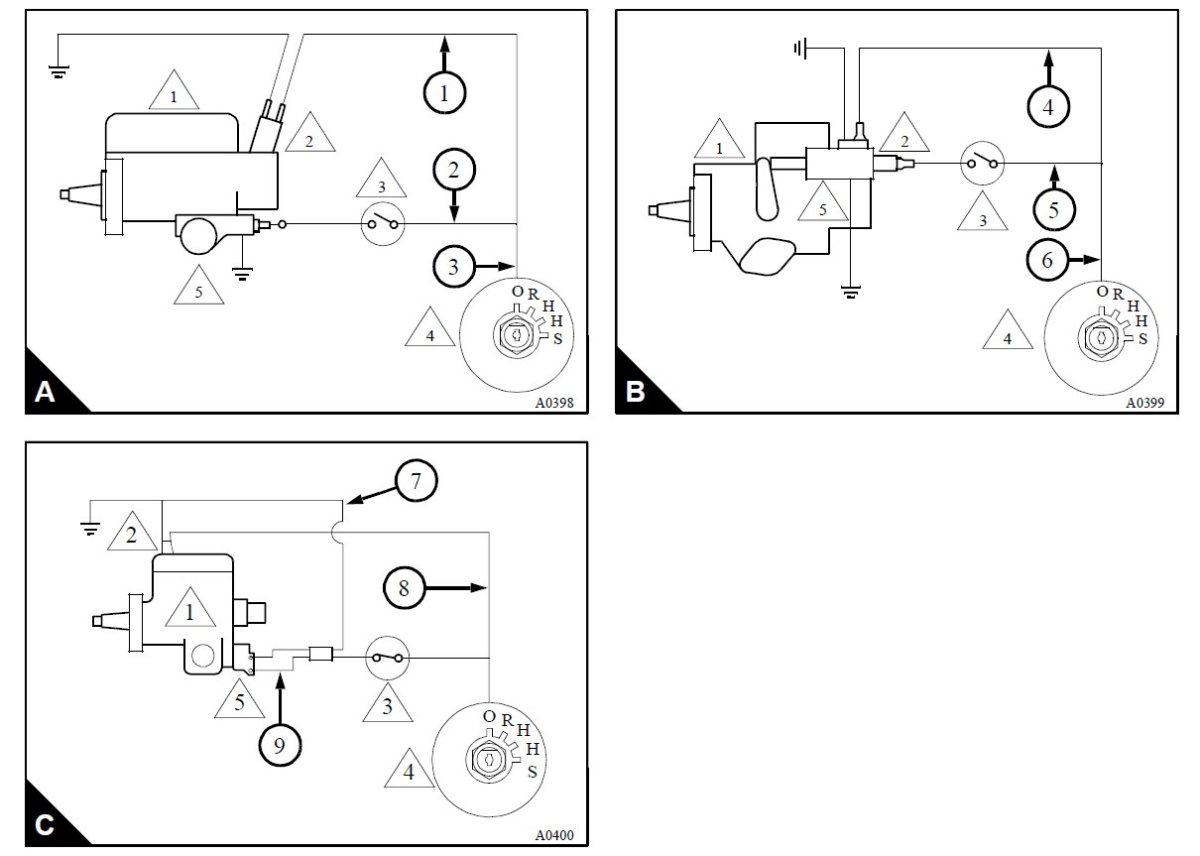

Would you know if that is the correct solenoid for the injector pump on my machine ?
There is more than one pump used on most perkins engines - usually Lucas / CAV & Bosch. First you need to identify your pump.
My 3cx P8 has a 1004 fitted with a Lucas/CAV pump.
The P8 manual lists three different pumps depending on the AA/AB block and power output.

Have a look at your ID plate and see what letter you have in "Position E"

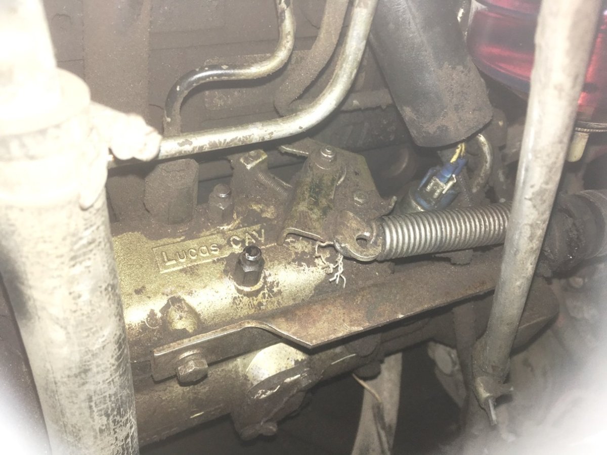

UPDATE
I have been able to take some photos. of the injection pump today but it isn't easy since the digger frame and other things get in the way. Firstly this is an image of the plate on the pump :
Because the details can't be seen I have put them into a diagram that hopefully shows everything :
Is it possible to tell from this which solenoid I need please ? Any help gratefully received. Thank you.
