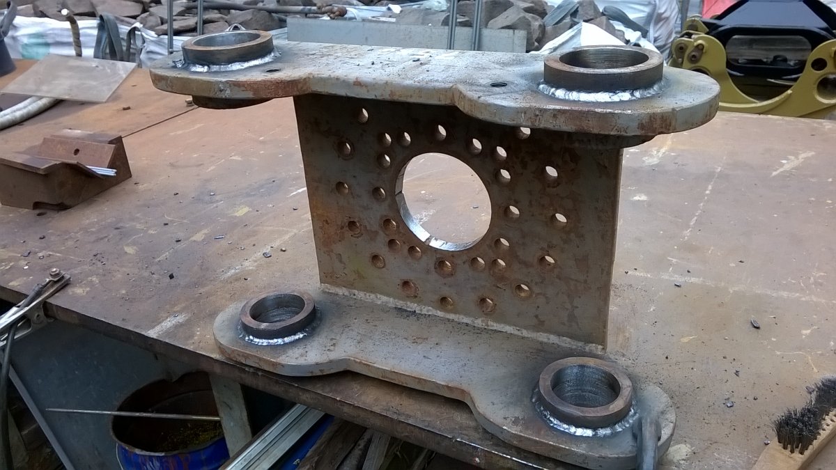

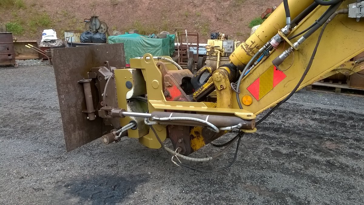

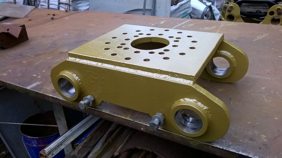

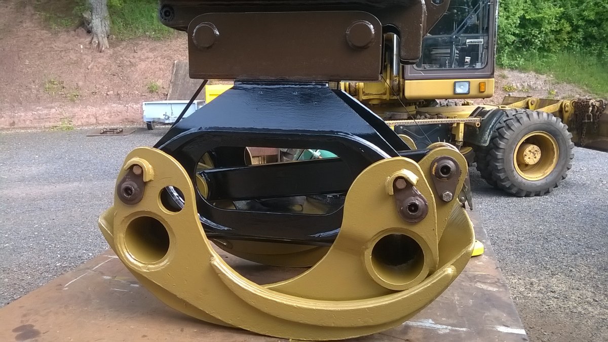

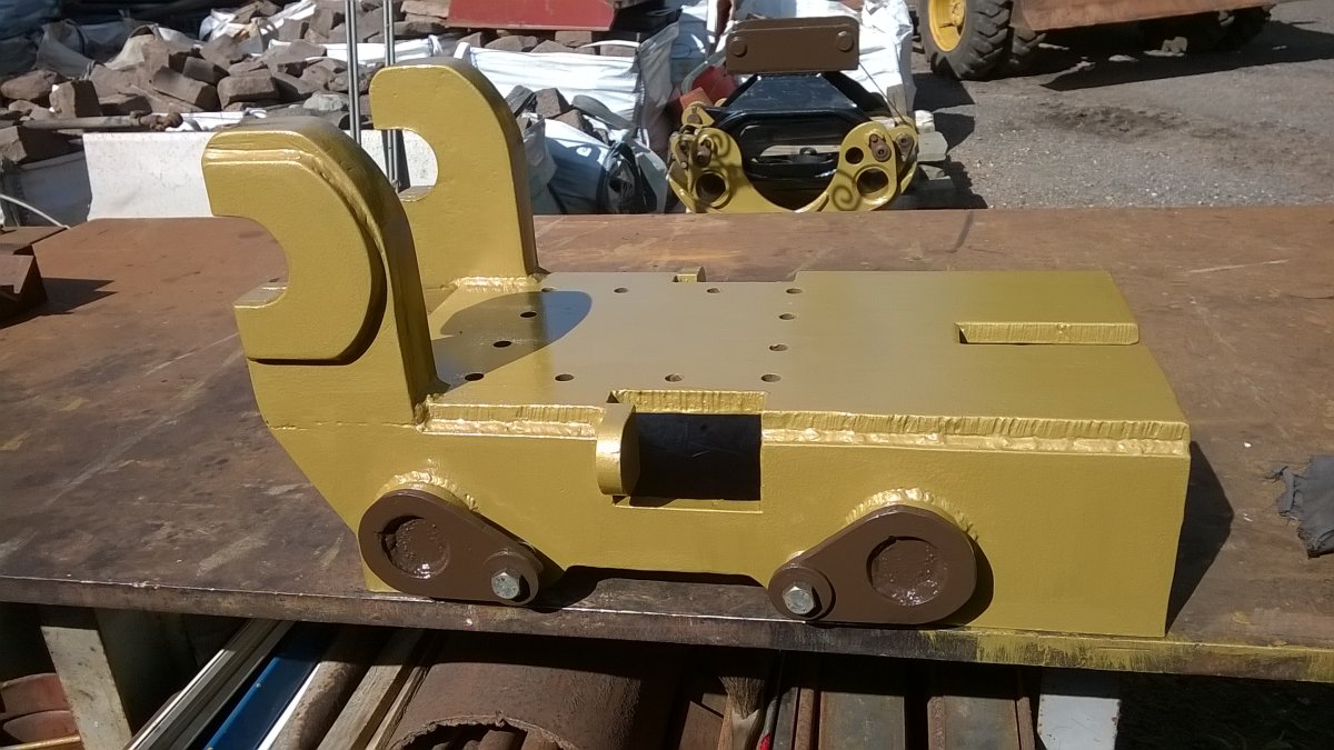

you can all laugh but that Firwood hammer finish I use is a very long lasting coating ..... couple of coats at least a week apart is some coating ... Me VA-r survived 6 years out in all weathers 'fore it got a repaint earlier this year and had just lost its colour ... was still protecting just fine
ditto this
and these had a first coat which'll hopefully be fine for a while
when it's gone off it's bloody hard
available in all colours .. well a lot of colours anyway

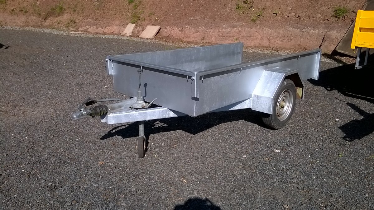

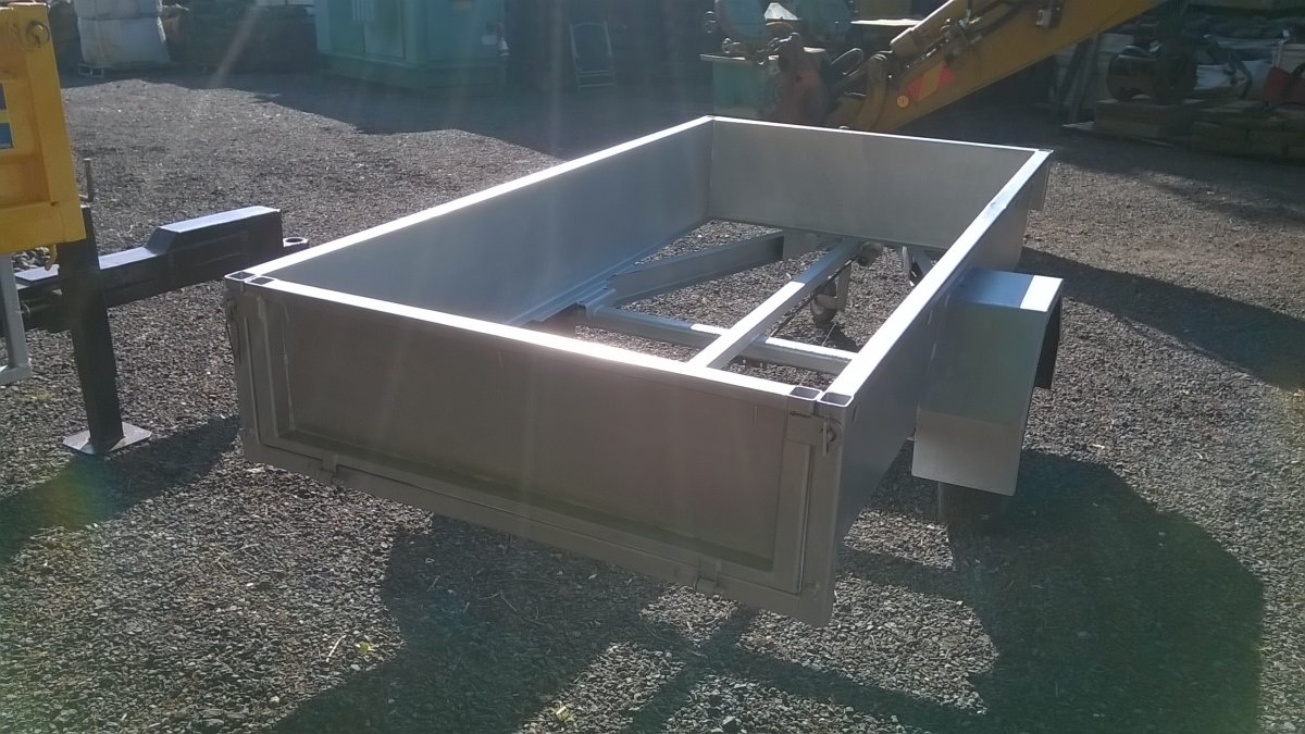

this is also a good coating
Firwood 193 Aluminium Paint | Firwood Paints Ltd

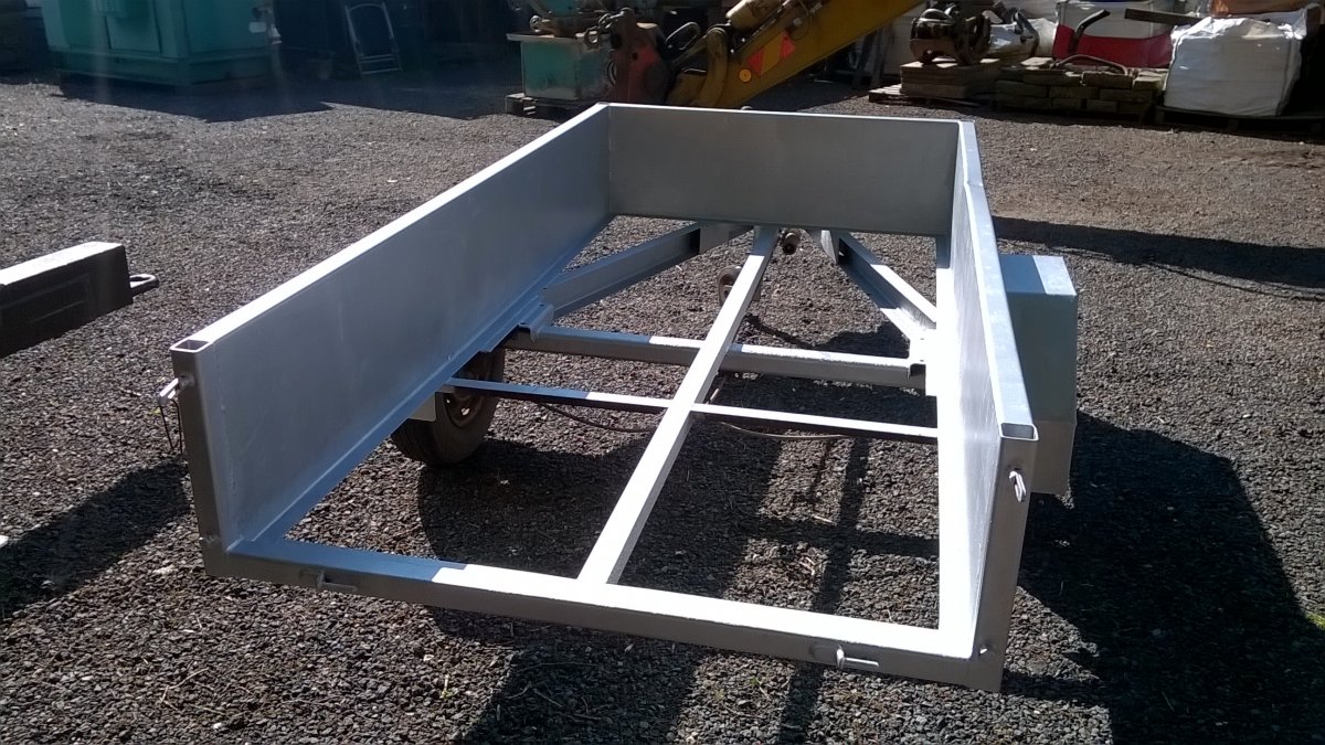

this had a second coat .... in over ten years earlier this year .... doesn't get used a lot and stands in the weather day in day out
seriously good rust preventer ... a couple of coats is some cover
