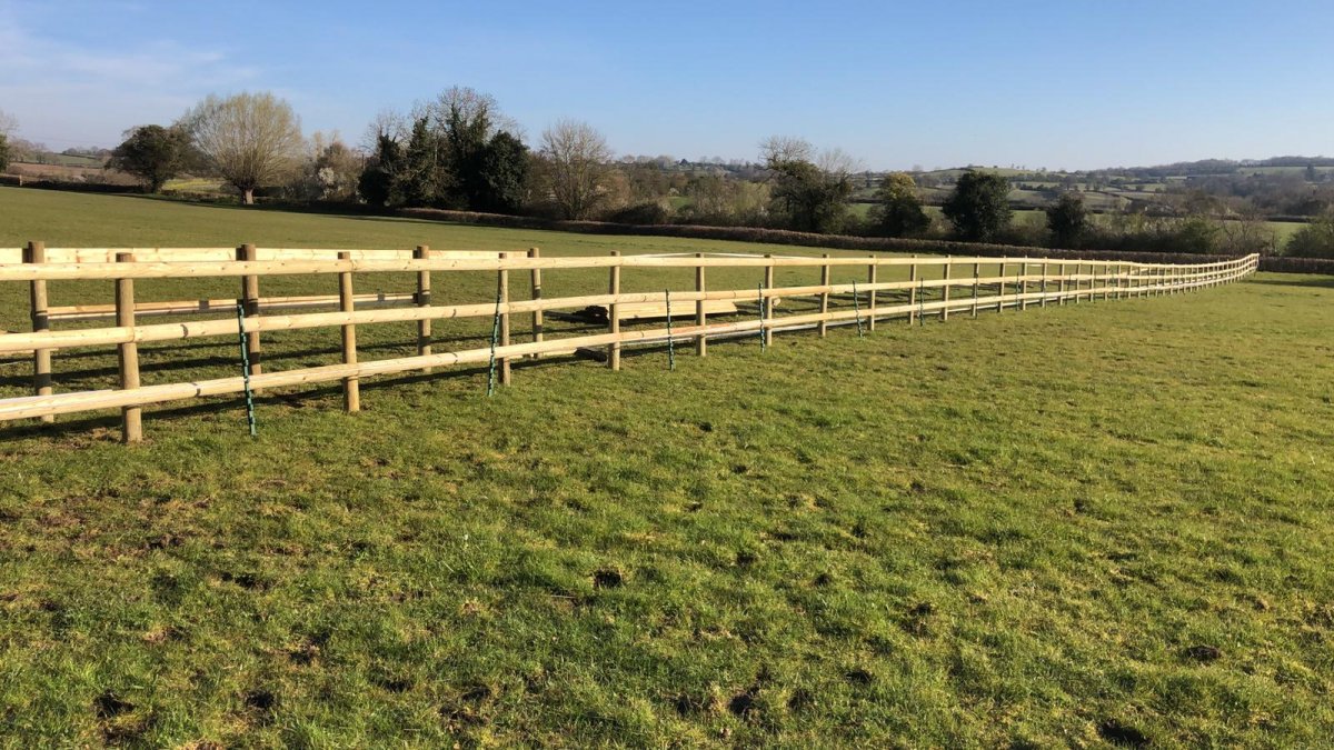

Did some with a local guy who had a knocker mounted on his 8t jcb. We did a fair distance on his fields once posts were laid out.
Yesterday’s effort
