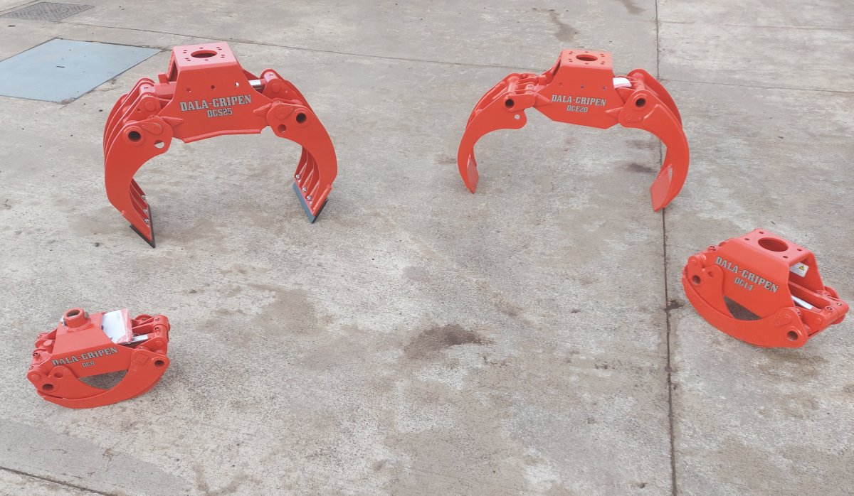

I keep looking at the JB web site. The bear claw looks to be exceptional value for money and could be half the price of some manufacturers.
Hg2702
Hg2702
The intermercato is well worth it ! Can’t comment on the jb stuff as haven’t seen it about or in person
looks a weapon .... can't see WTF rigid rotation is but it's 1200 quid :oops::oops::oops:

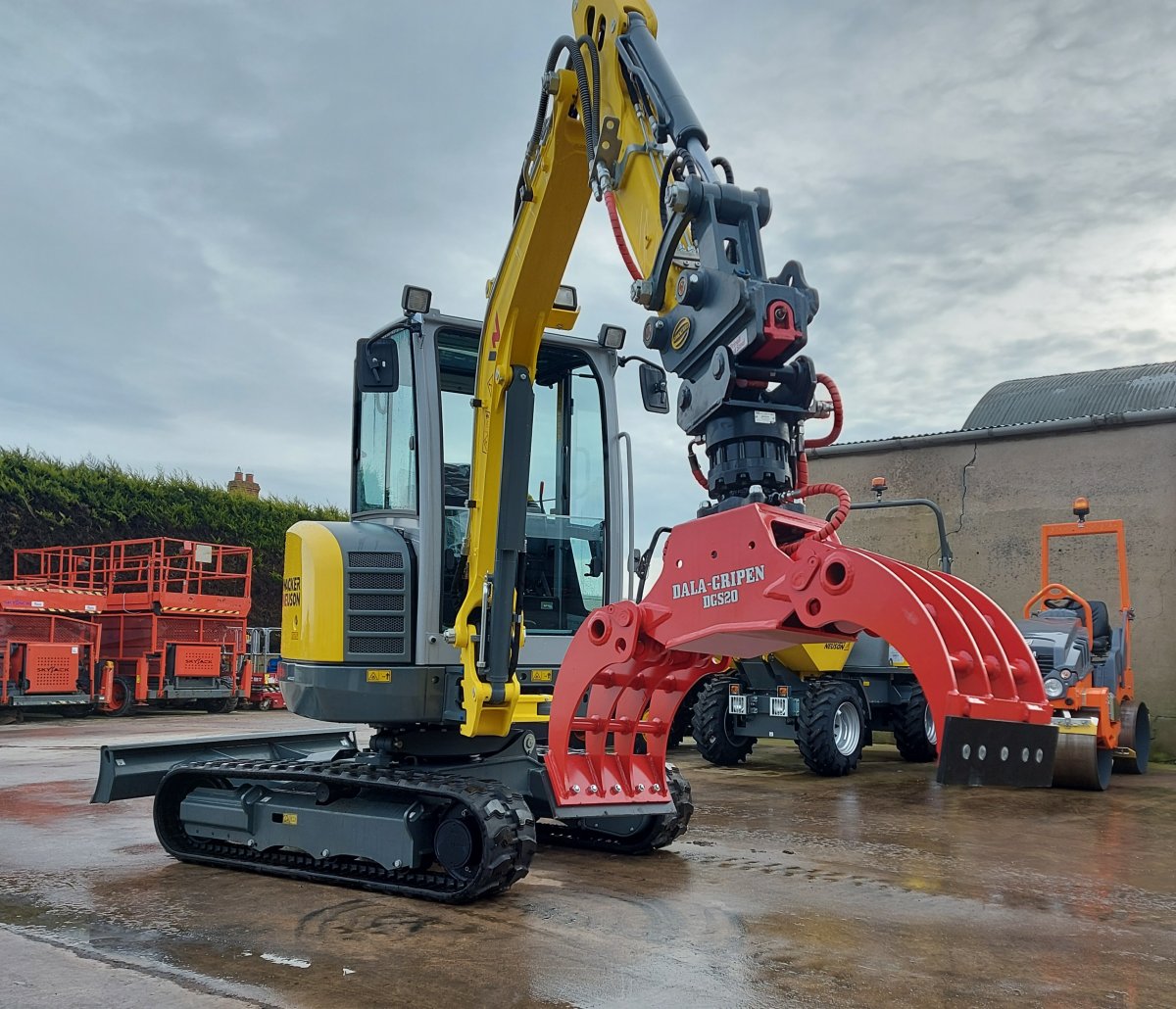

I'll have to have a play with the E10 and see how well it handles 150kg odd at full stretch.
Has anyone seen extra counter weights for a e10?
It does it but very limited. You're better off with a grapple, with hydraulic back stay for more versatility. I have both, and the only time I ever mounted the Tigergrip was to carry out a load of bamboo vertically, which it managed. But I'd never use it for general jobs.
You simply don't have the loadover height or lift capacity to use a Tigergrip style grab plus headstock on an E10. A grapple is different, it holds the load more under the stick (at least it does with the stay set right, easy if you make it hydralic). It's 30-40kg of grapple and the weight in the right place, vs 100kg plus of grab and headstock as well as the leverage and stack height of the headstock.
Grapples are cheaper too.

Just checked- they mean a rotator. Guessing rigid means one rated for axial load, rather than a dangle mount. If so then not a terrible price.
I`ve just read the advert myself and come to the same conclusion.
