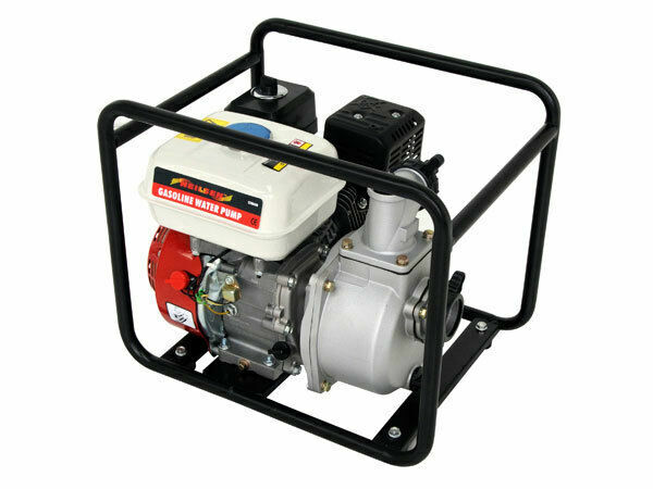

bought one with a Loncin engine on several years ago ... Hodna copy basically and it's been great .. starts everytime and pmps like **** .... IIRC was 130 quid with 20ft pick up and 60ft discharge, with fittings, but I bought some of the 2" QCs for it -- 1000ltr/m ... Ebay .. too far back to look at my history, but did find summat similar a while back when pumps were discussed then and had gone up about 20 quid
there's this one, but not Loncin and only 600ltr/m

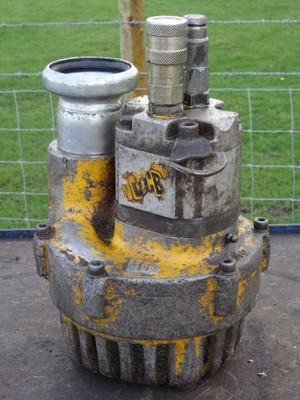

Was gonna mention submersible and genny myself. Ok you won't be able to pump as much as petrol pump but with a 2" submersible you won't spend half your time priming it just drop it in the hole and away you go.
