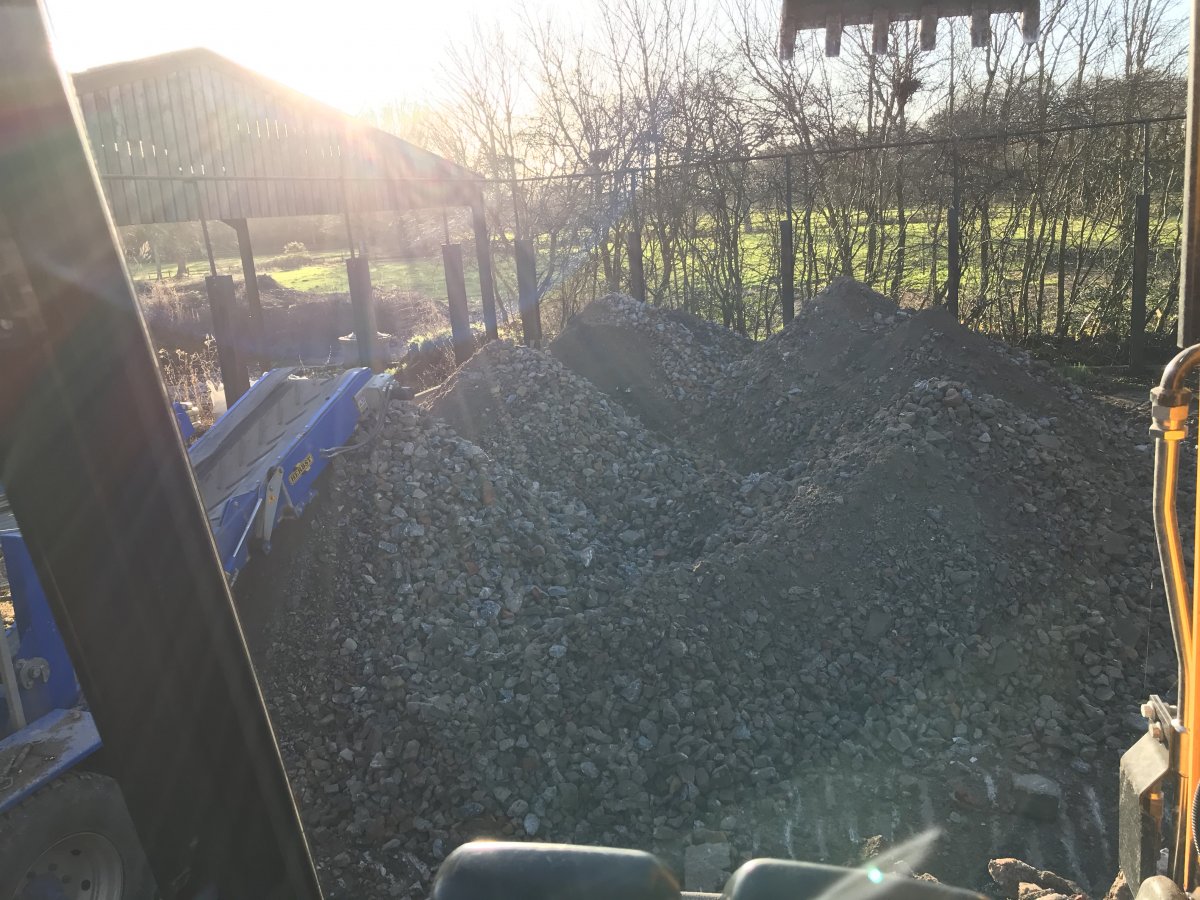

Perfect thanks for that, I conveniently only have a stockpile of 199 tons. It was the noise that was the issue With working on bank holiday.. not something I had really considered (i hate bank holidays!) Wife is more caring than me 🤣
Opted for sunny Wednesday instead, sun in the eyes all day! 199tons(to the gram!) through before tea time, little 6ton earned it’s money that day!

To be honest there isn’t enough space to do any more than that in one go, it’s a very long term job , just doing bits to it as we go.. handy to have a stockpile of decent 6f2 to go at 👍🏼
It's handy to have a decent heap to crush as you get a better mix going through and get a better binding hardcore out of it. A lot of outfits won't bring the size down as it slows the job down and you don't get enough fines in it and its f'in useless
