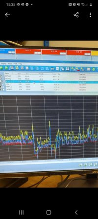

Hi,
I am having trouble with a diesle genorator that cuts out. It has died 3 times in a week , twice when we switched on some large heaters and once on its own but we suspect the heater switched its self on. Every time its within its load capacity but can't be coincidence its as it takes a large current. You can see in the picture where it spiked then died suddenly. My thoughts are its a problem with the governor and stalling when trying to change to keep the rpm level. We have recently had a problem with water in the fuel but this has been rectified but could be potential damage to components. Any thoughts on tests and repairs.

We changed the diesle cube ,filters ,fuel water seporater and fuel. It doesn't cut out at high loads only when it jumps from low to high. First to times the engine died straight away 3rd time it spluttered and you could hear it dying with plenty of white smoke
