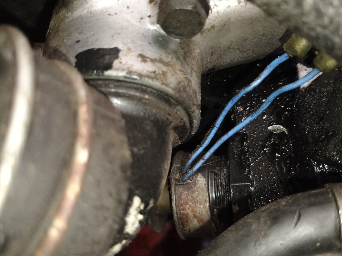

Hello. I have a peljob 750. Twin cyinder. Had it a few years now. Regularly serviced. It just died on me. The electric pump is pumping fuel through the inline filter to the injector pump. If I crack off either injector pipe fuel isnt coming through. The solenoid in photo which is screwed/fitted to injector pump isnt wired up and hasnt been since I had it. Any advice would be appreciated.
