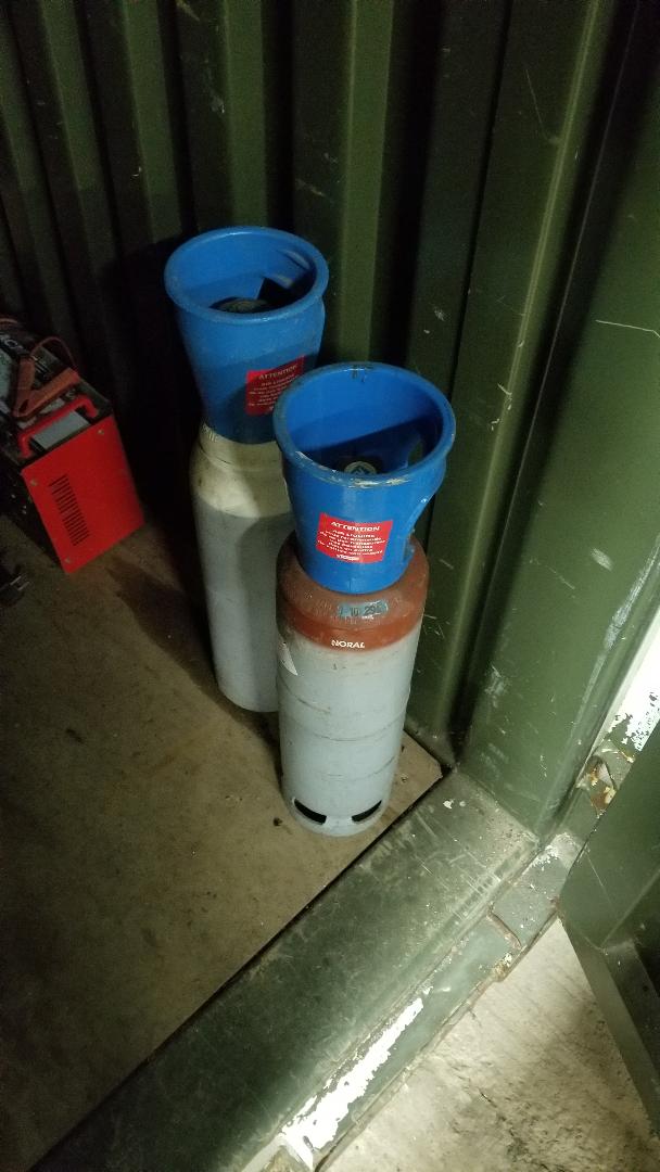

While back I picked up some oxy/acet equipment very cheap, small 1M3 bottles - the 6mm hoses were paggered and there were no arrestors in line , so ordered some replacement hoses and arrestors from L&S when they arrived the hoses were 10mm as opposed to the 6mm advertised (a mistake on their website), they have told me that the 10mm is fine for the
job, I know very little about this kit and wondered if 10mm was o.k or not ? I have heard something about flow rates on small bottles but I guess this is dictated by the torch more than anything ??

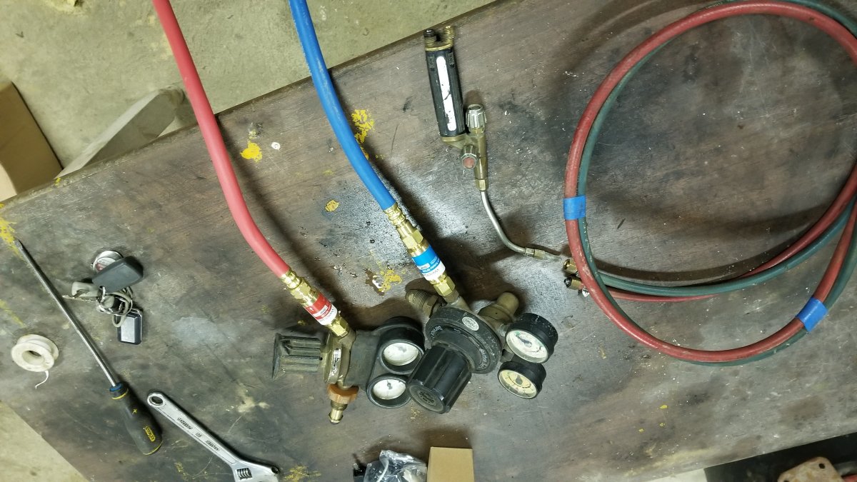

Cheers - They fit the bottle end but not the little torch -so I was going to get adaptors cos bit of a pain to send hoses back to the U.K......but now you point it out that torch is going to be a Tw*T with those hoses .......... might in fact be better getting a bigger torch but not sure what suits the little bottles... as you can tell its all new to me .......... what do you reckon ??
get yerself some 3/8 to 1/4 M/M adaptors and a couple of 2 or 3M x 1/4 tails for the ends of your new hoses to allow you to fit the FN torch to them and give you decent movement
On EDIT .... just noticed the PTFE tape in the pic .... don't use it ... the seal is in the cones/conical seats, not the threads ... always be careful not to damage the seats .... if you're going to do much cutting, get your self a decent NM250 torch .. bout 35 quid ... the combi cutting heads ain't great in comparison.

Good spot but Ptfe tape is there from something else - i havent used it on and fittings 👍

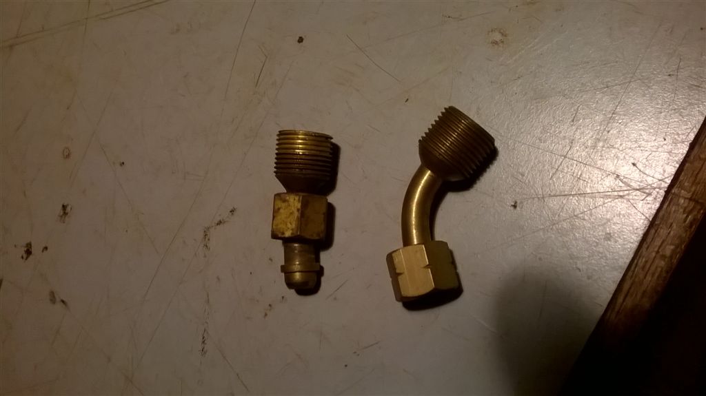

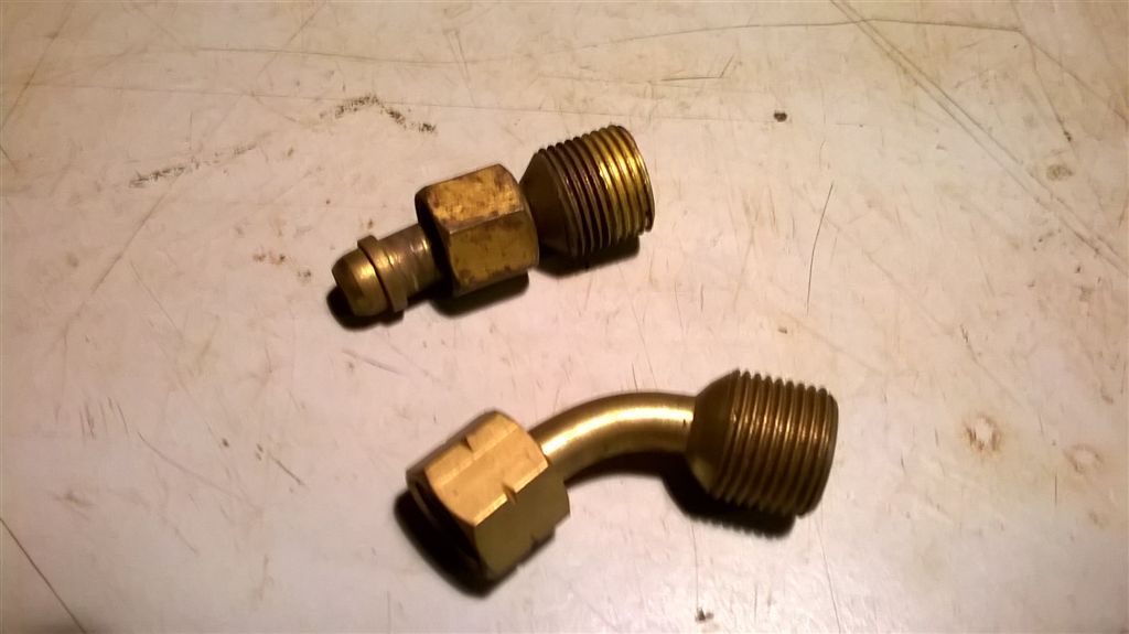

Here you go Kevin ;) ... knew I had a pair somewhere ... tripped over 'em today :rolleyes: .... 3/8 hoses are a bit heavy on an FN torch though, as said, if you're doing much with it ...
alright for a quick job though, if you don't use it too often
BOC do them https://www.boconline.co.uk/shop/en/uk/adapters-3-8-female-1-4-male-lh-straight-6356-boc
or these guys https://www.welduk.com/product/pair-bent-gas-adaptors-14-38-fittings ..... and a lot cheaper too
Just the job Graham tnx - I will order a pair off welduk - will do me for the bit of bodging I do :)
