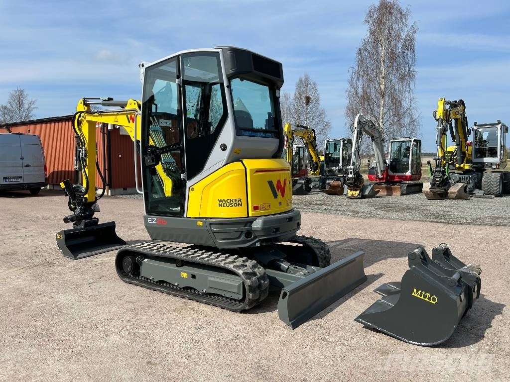

Do you have the additional counterweights on yet though? Most sub 3t machines will be lifting a track at far stretch over the side with a full grader
If what you see on the back of this example is the additional counter weight, then yes. wacker-neuson-ez26,434c6541.jpg
