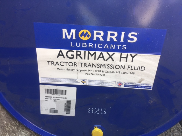

Not sure if 35 years is old enough for the vintage and classic section of the forum. But the recommended oils in the handbook are now obsolete also. After a bit of an online search for today's modern equivalent of 1980's Case spec TCH fluid for transmission and hydraulics, I have decided to use Morris oil's agrimax HY in the old digger. I have only one minor leak in one of the locking rams for the side shift of the back hoe, so far. Has anyone else had any problems with new oil in old machines? I would like to hear before I start draining oil. Any tips on changing oil in the transmission would be appreciated, thanks.

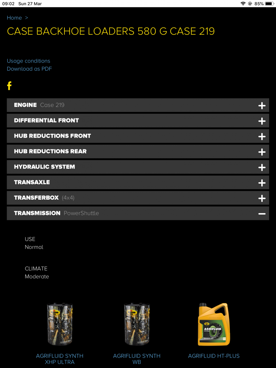

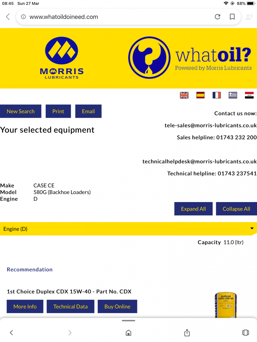

Try Morris oils they have an oil selector for off road equipment just input machine details and all oil needed for each component comes up.
