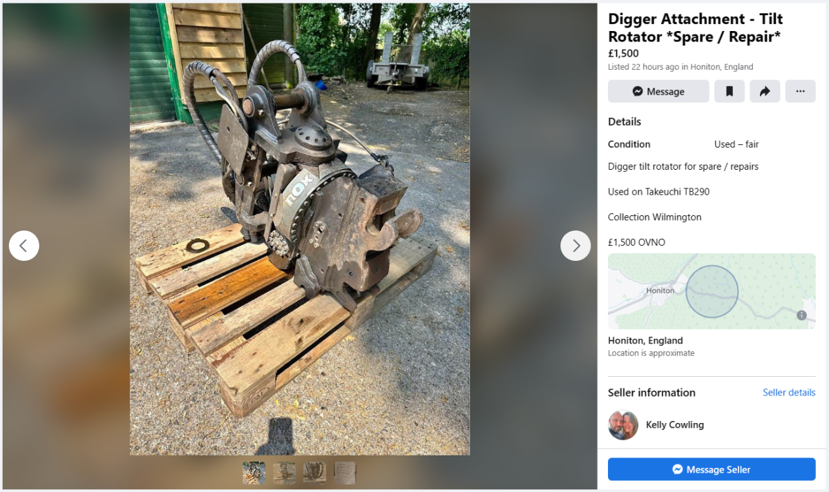

Already seen it and chasing, but someone else is looking at it first, and not keen to reveal why it's spares/repairs so I suspect either it's been robbed for bits or the tilt unit is pissing oil out.
See what happens but I'm not holding my breath, plenty of fools who will easily part with there money.

It's only 4 years old , you'd think that that would have to be repairable to someone like yourself whod be prepared to get in about it
Depends.
Either it's a auction/hookie find that someone can't work out the wiring for (4 pipe unit but likely to have a cable control for hitch and looks to have take off points for attachment)
Or it's been heavily kiboshed...... Think seals blown to kingdom come, etc.
It seems a genuine advert, but the fact they are saying spares/repairs rather than XYZ won't work says it's likely been in bits once and ruled uneconomical to repair.

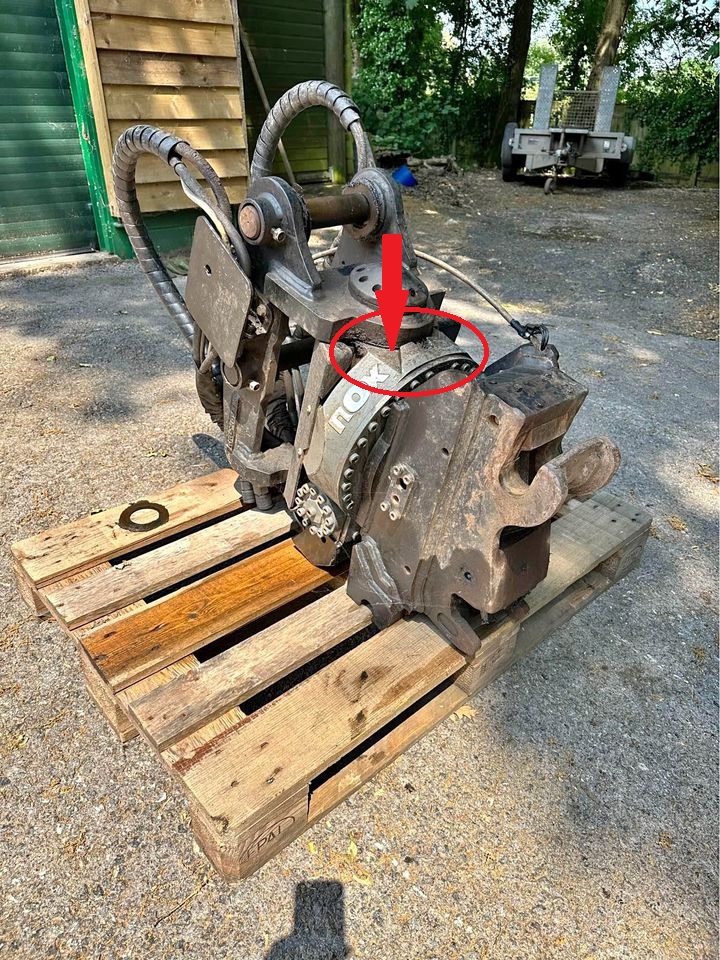

as said 4 piper, plus, plus ... would want to know how to deal wit it ..
looks a hell of a lump that'd be more at home on summat bigger .... and is way too cheap for a non terminal case ..... might not be the tilt side that has fault .. the ring and worm' d be eye watering pennies to replace

this looks a bit suspect
or is it a notch for full 90deg.s tilt? James @Shovelhands ??

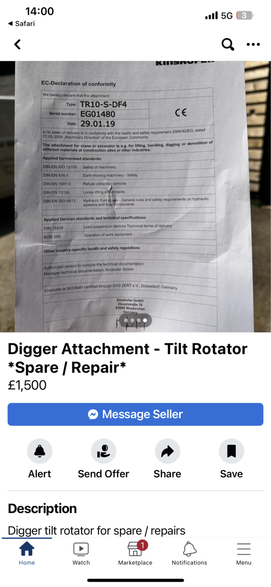

TR10 is an old model, at least pre 2019

It says 2019 in the paperwork he’s got on the ad
Sorry, I never looked at the ad. That date is legit then, one of the last TR10’s they changed revamped the range and launched a new lineup in spring 2019.

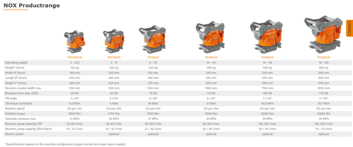

what Size range did that cover? as graham said it looks a big old lump
