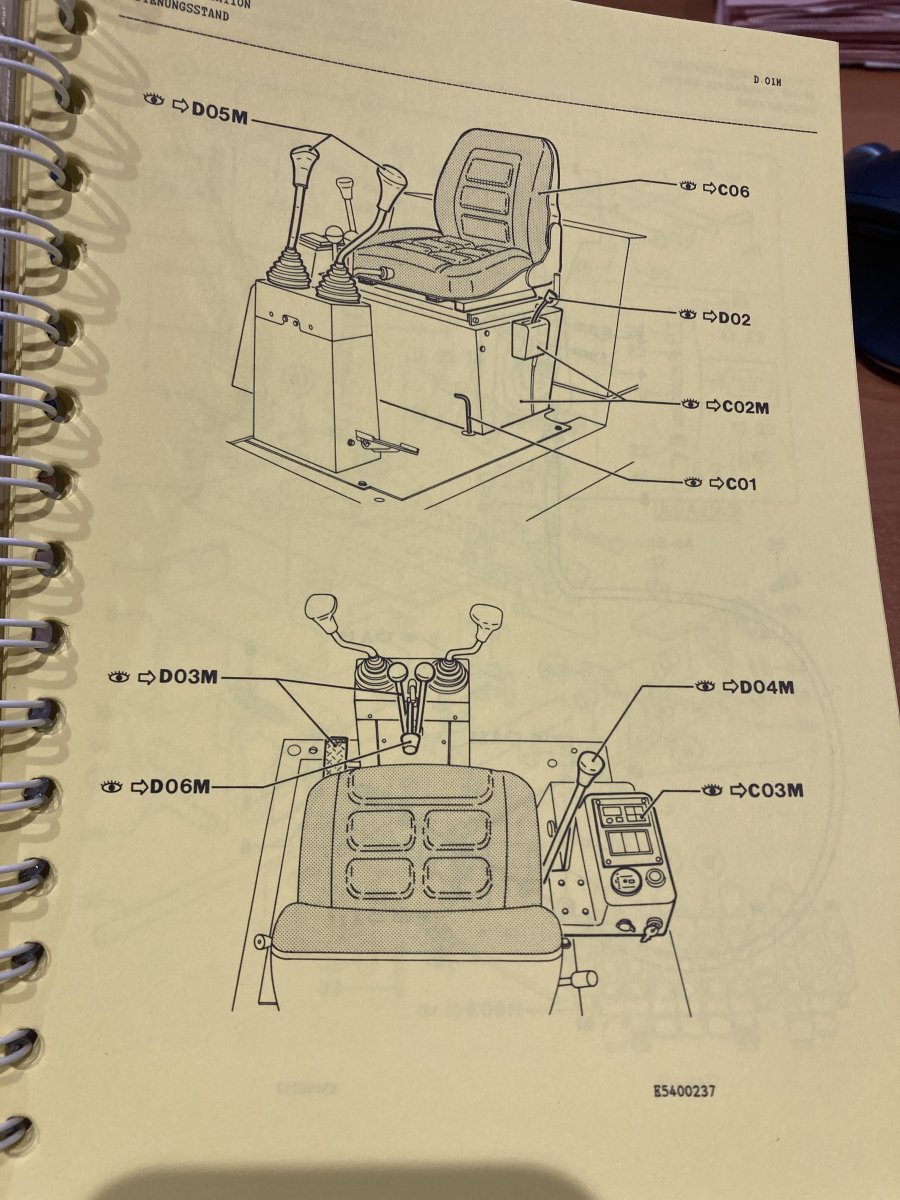

Think the peljobs were older Volvo's, which had the boom swing on one of the lever/sticks. Press it, then it switched the left stick to boom swing instead of slew.

The switch on the stick is the offset control. It's a change over solenoid for another slice on the valve block.
Press and release the switch. Then move your level left or right you should get the offset working.
Press and release the switch again and the lever should return to slewing the machine.
You are correct the floor pedal is a two way, two pipe supply for an attachment. You may have the attachment pipes on the side of the boom. If they are not there you will see two capped rigid pipes where all pipes exit the front of the cab.

Thanks for this, the switch on the stick isn’t doing anything, I will have to get it looked at, hopefully just a worn switch

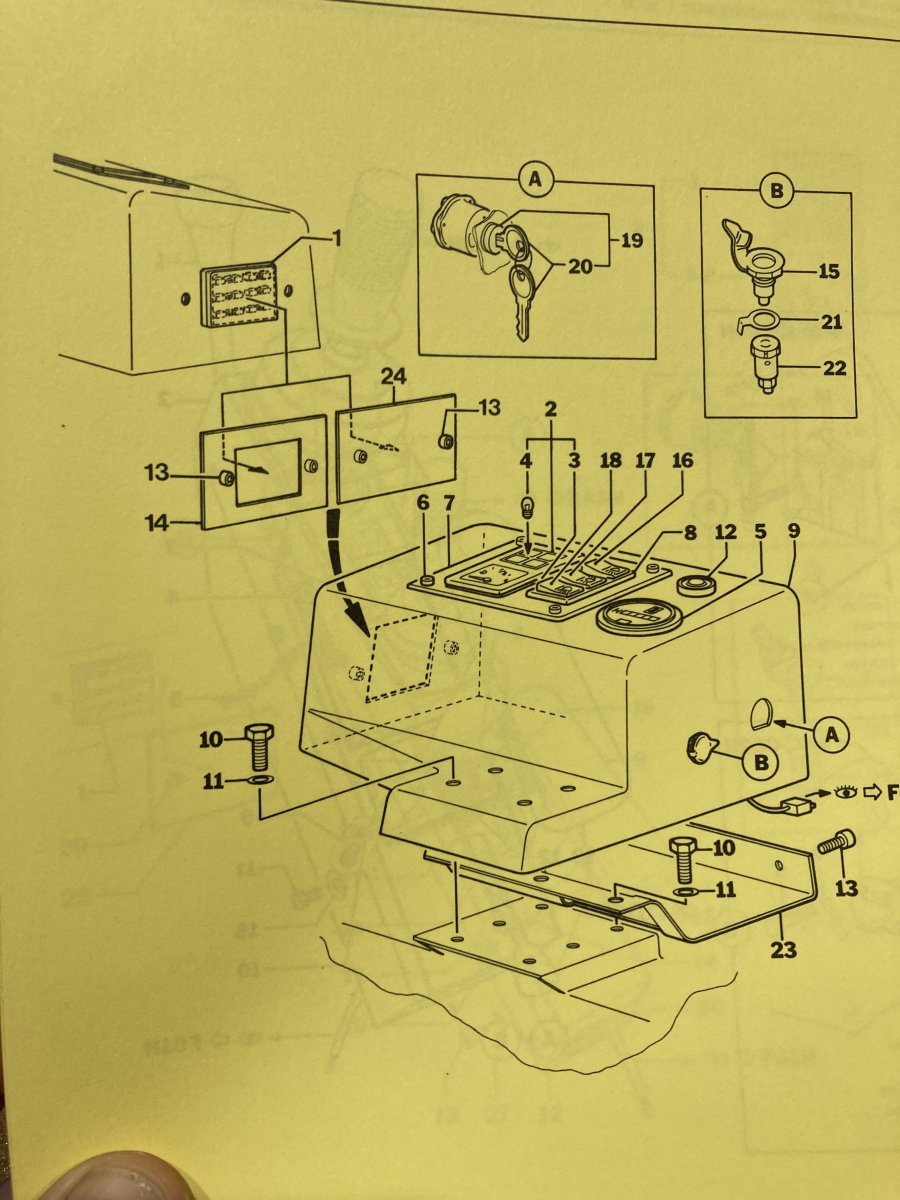

Might well be as simple as a fuse. The fuse box is down low on the right hand side at the front of the plastic "dashboard" above the hydraulic oil sight glass.
Worth checking the simple things first.
