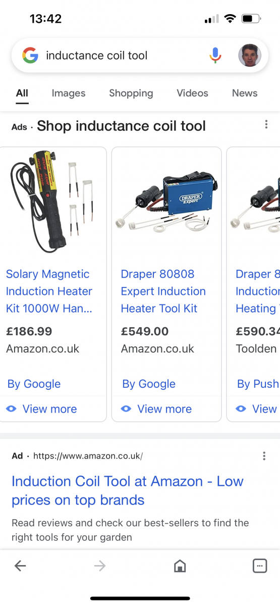

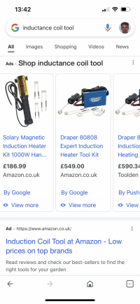

I have had a half inch drive ratchet socket on the bolt lots of spray, 6 foot scaffold pole and my halfords half inch ratchet blown apart and left me thinking I need a 3/4 drive bar no ratchet or anyone ever used inductance coils See pic

I don't think the inductance coil would get the heat where it needs to be- on the thread. Be easy enough to get a blowtorch with some MAPP gas and try that, although you'll be there a while! Also try a 'freezing' type penetrating spray.

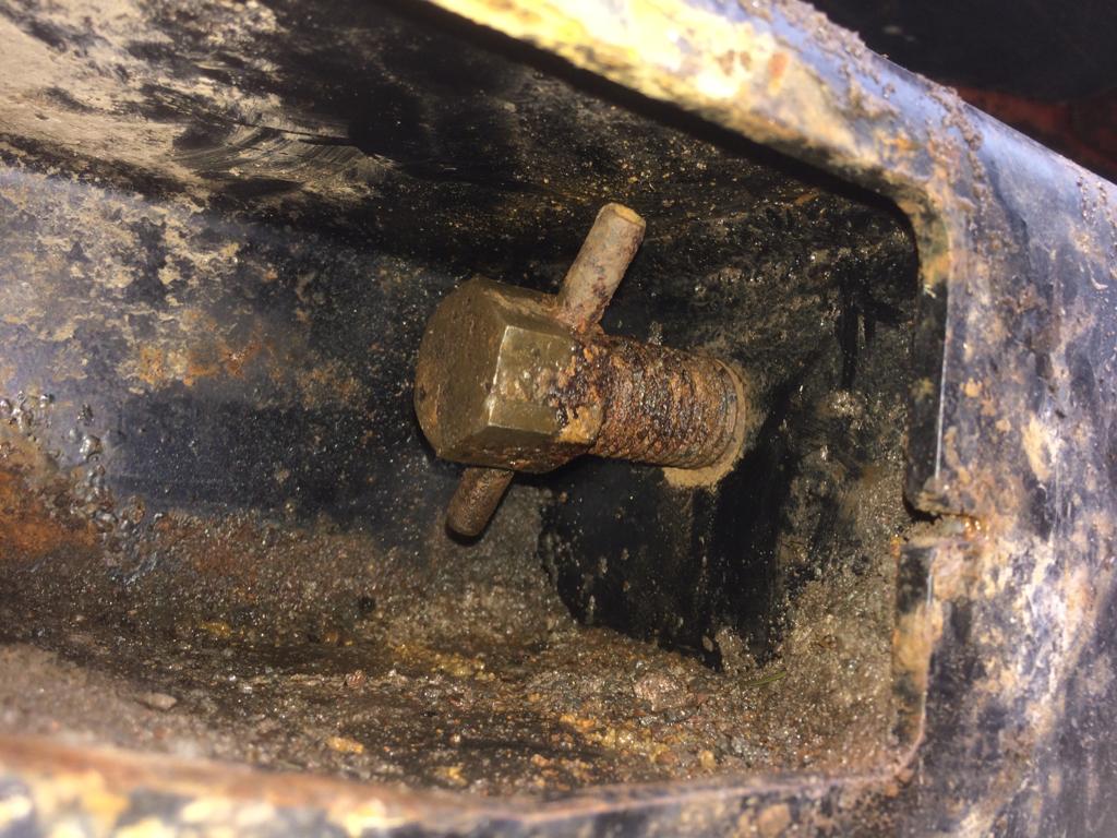

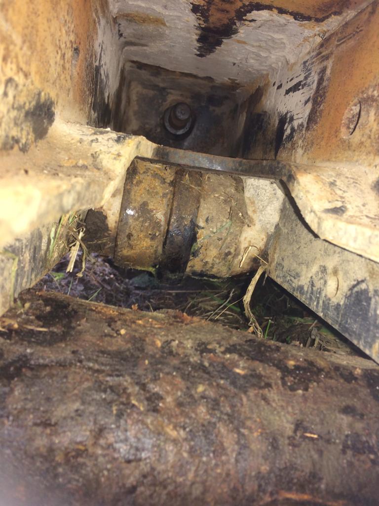

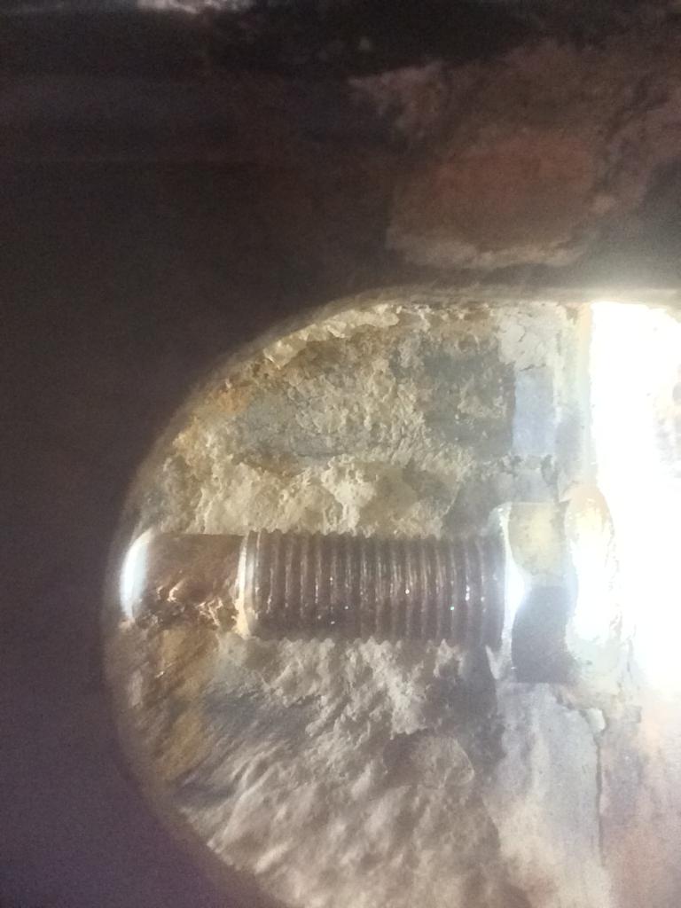

Had closer look, the nut is welded to the other
side of the bulkhead so the heat needs to be
on the nut which means taking off the tracks
and rollers to get heat onto the nut. The head
of the bolt is a slack 30mm socket but there is
a pin through the head ? Why ? I'm not happy
that the socket is only on half of the head of
the bolt? Need advice please. Ta

Soak with penetrating oil first and leave it to be well soaked in. Then if you can get enough heat pointing at that plate it should start to move
The penetrating oil will burn off and help loosen it up in my experience

Pin through head stops it rotating when cover is back on iirc
