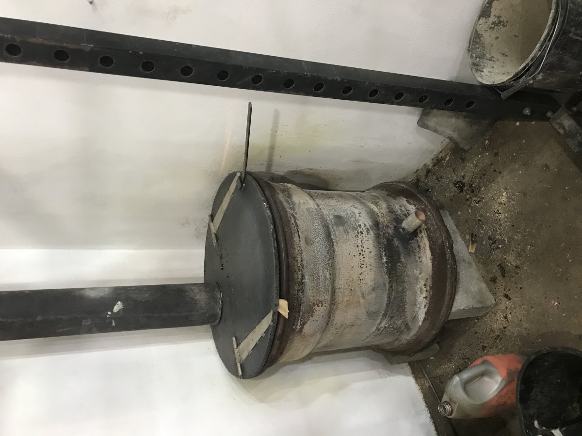

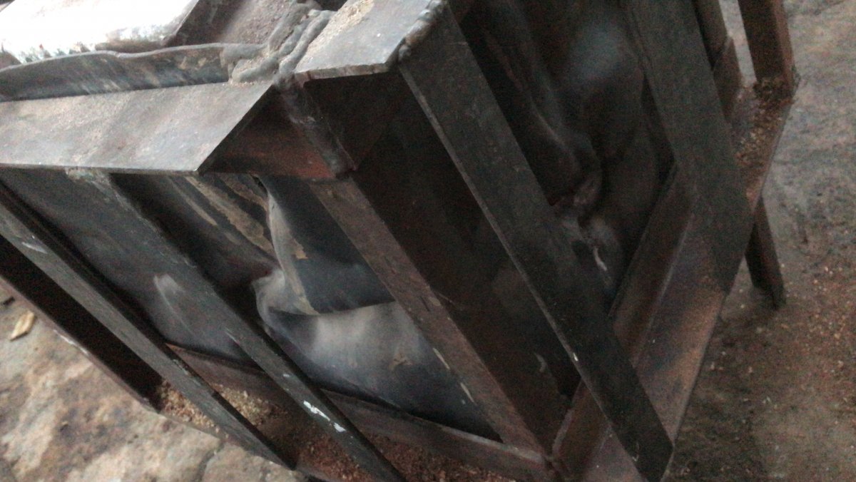

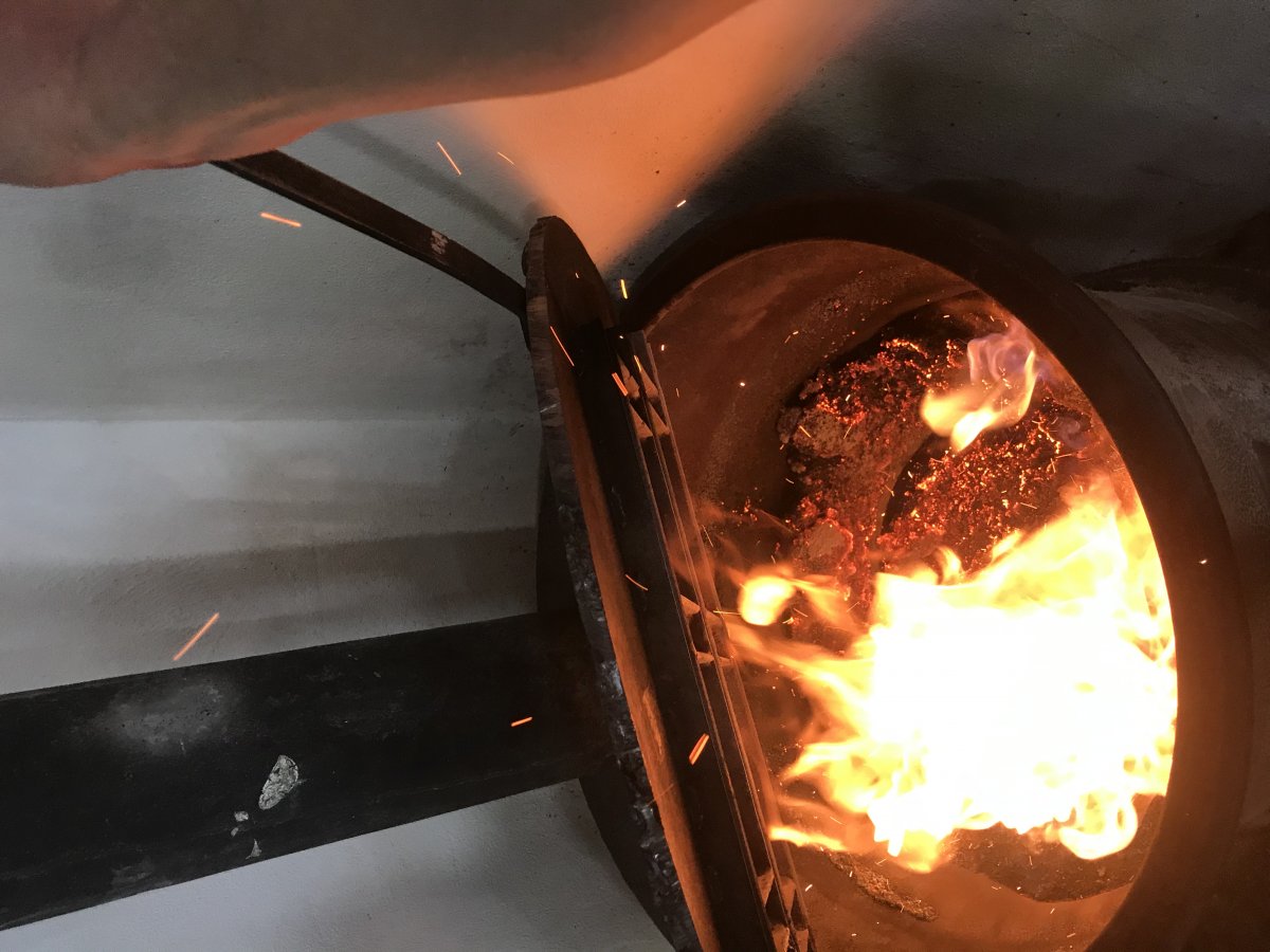

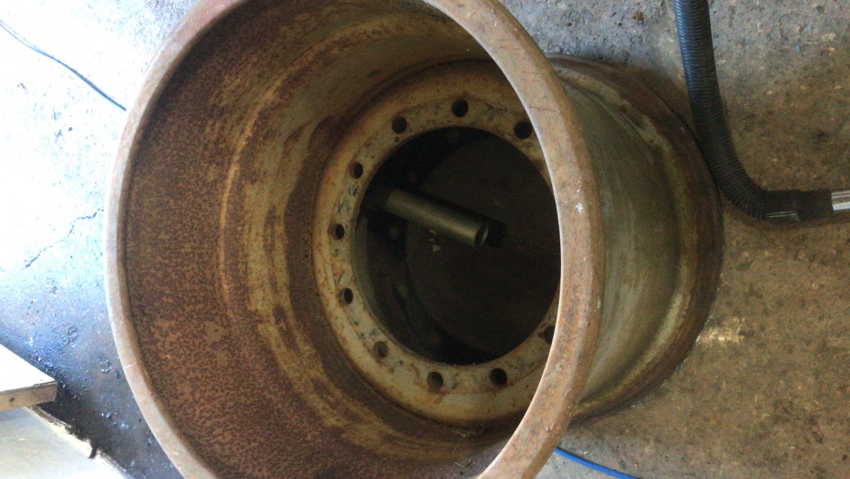

Finally got round to replacing my trusty (but well warped) sawdust burner on Sunday. A jolly morning spent cutting and welding (and wondering how I'd lift it into position as it got progressively heavier!) It's a forwarder rim (so super strong/loads of metal) with a scaffold pipe as an easily replacable bottom vent (this is the bit that will burn out over time, so was important that it was easy to replace). Just over two foot wide and almost three feet tall. Can drop a whole dust extracter bag of sawdust in her. Haven't decided what to do for a top vent, and might also do a rope seal on the 12mm thick top lid (plus some griddle bars on top for my bacon!) Really pleased with it for maybe £50 worth of metal. It's also got a slider in the bottom to remove ash which will make life easier.

how do you get it going Doob ... drop of kero and a blow lamp up the vent ??????
dash of diesel mixed with waste oil and light it at the top. It’s surprising how quickly it starts to draw from the bottom. You look up the tube and it’s glowing but it still looks from the top like a full load of sawdust.

Used to have one in place I used to work. Could be quite a beast when filled right up occasional chugging and blow the lid off if you mess about with the air. I always found lit really easy if you put a tube down when filling up to the bottom air intake. Pack around it. Pull tube out and light at top
Yes
Yes we sometimes use that trick but a lot of faff compared to just dumping the bag in and applying blowtorch 😂

It's taken a bit of getting used to. I originally tried to get it fired up quick and burn quick (plenty of diesel) but this just leads to it needing more air at the top or blowing back
. So added a second vent halfway down the left. The key is to let it get hot then turn it down as it's a huge weight of steel. With sawdust you slope the load so it can draw from the second vent and it's pretty quick then to warm up. Using solid fuel a lot also, as huge lumps can be fed, so burning lots that we would otherwise have thrown on the bonfire.
I've just stuck a scaffold elbow on the bottom and top vents, and cover this with a plate to restrict airflow for now. The procedure with the old burner was to run it hot and quick, with fans on to distribute heat. With this, once it's hot you can turn it right down and the temperature will slowly creep up on its own. It overnights well with a full charge of either timber or sawdust. It's five times the thickness of the old burner, so a learning curve and different way of operation needed, but overall a huge improvement.
The ash tray at the bottom is great- took a full wheelbarrow out today, first time I'd bothered emptying it! I will gas out the bolt circle inside when I get a moment, as it's not needed for strength IMHO and gets in the way somewhat. I'll leave an inch or so all around so it will still have reinforcement.
