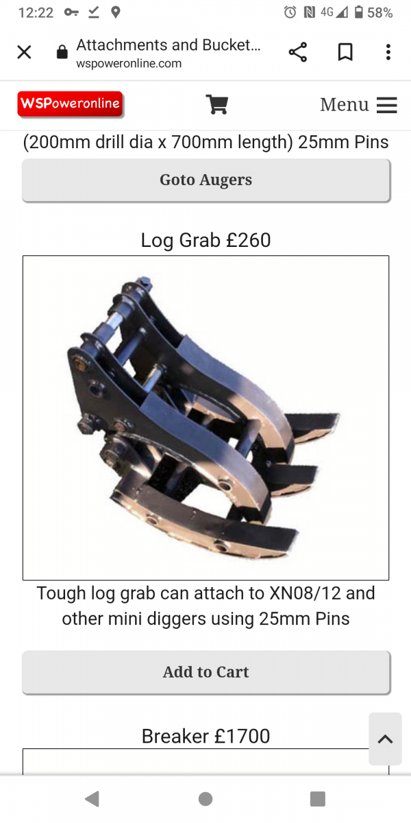

Thank you for the add, would anyone be able to help with where to buy a weld on bracket as per the picture (right hand bracket)
My 8015 does not have this and looking to install a log grab that needs it!

if the grab is new it should come with it ..... if s/hand, it wouldn't be difficult to knock one out ..... FYI 33.4 CHS (tube) x 4mm wall is damned close to the 25mm bore required. (y) .. couple of bits of 6mm plate for the cheeks .. job done
'spect Aiden @CPS 'll knock you one out otherwise ;):giggle: ... or find a local fabby ............................ then you gotsta get it welded on the dipper

No - just pivots off the existing Ram. Just need the bracket fabricating though.
