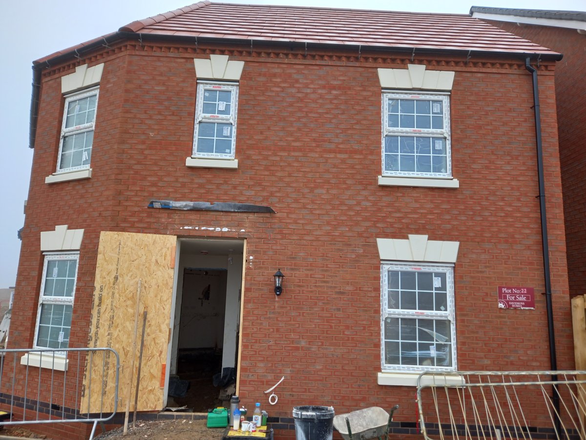

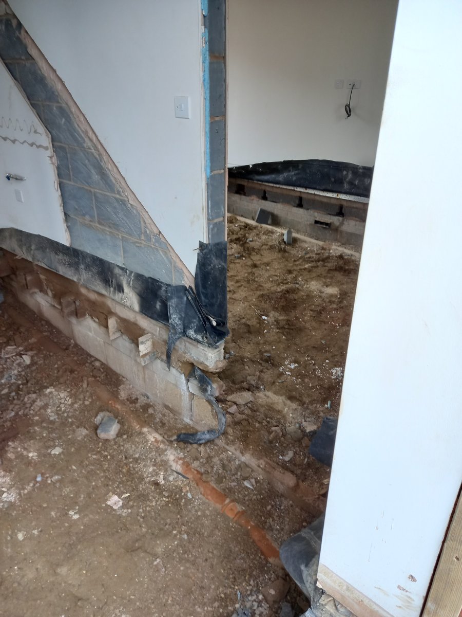

What about this one being underpinned on a site I was on few years ago think I already showed you guys
Jimoz
They should have been made to disclose that when selling but I bet they didnt. Imagine signing up to a mortgage to pay for that.
Jimoz
The garage started to fall down then they realised they were building near where they'd put a big drain in at beginning of the job. 6m deep iirc so think it was made up ground
