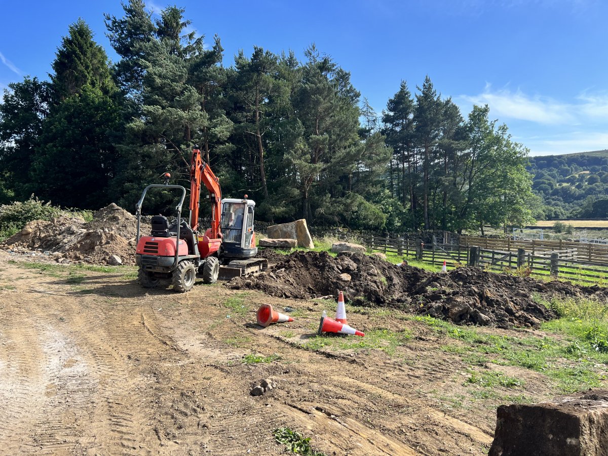

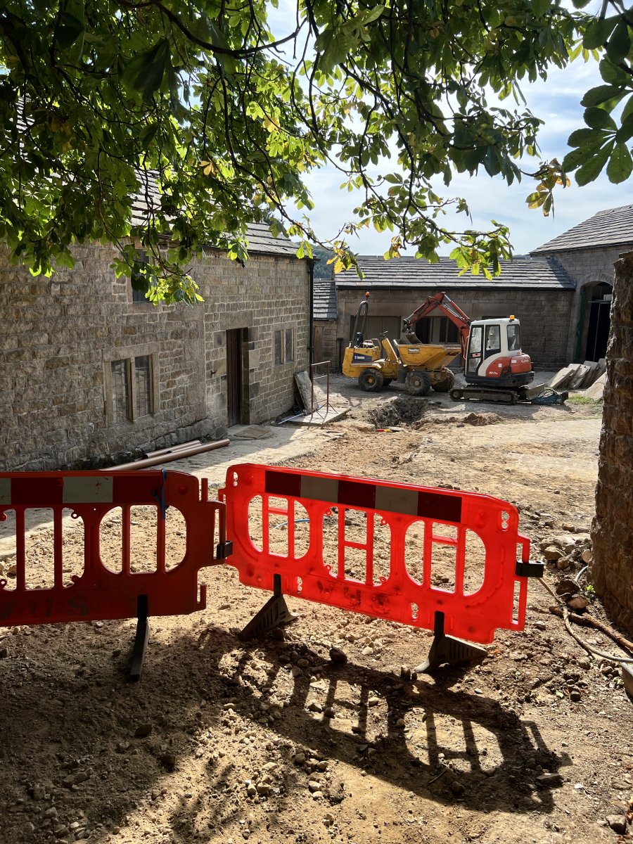

Noticed on the dumper today it’s creeping forward in gear or neutral have to flick brake switch and it holds but before it didn’t creep,
Was loaded and was on a slope,
Where to start? Hydraulic adjustment anywhere ? Does it have actual brakes or just in the motors.

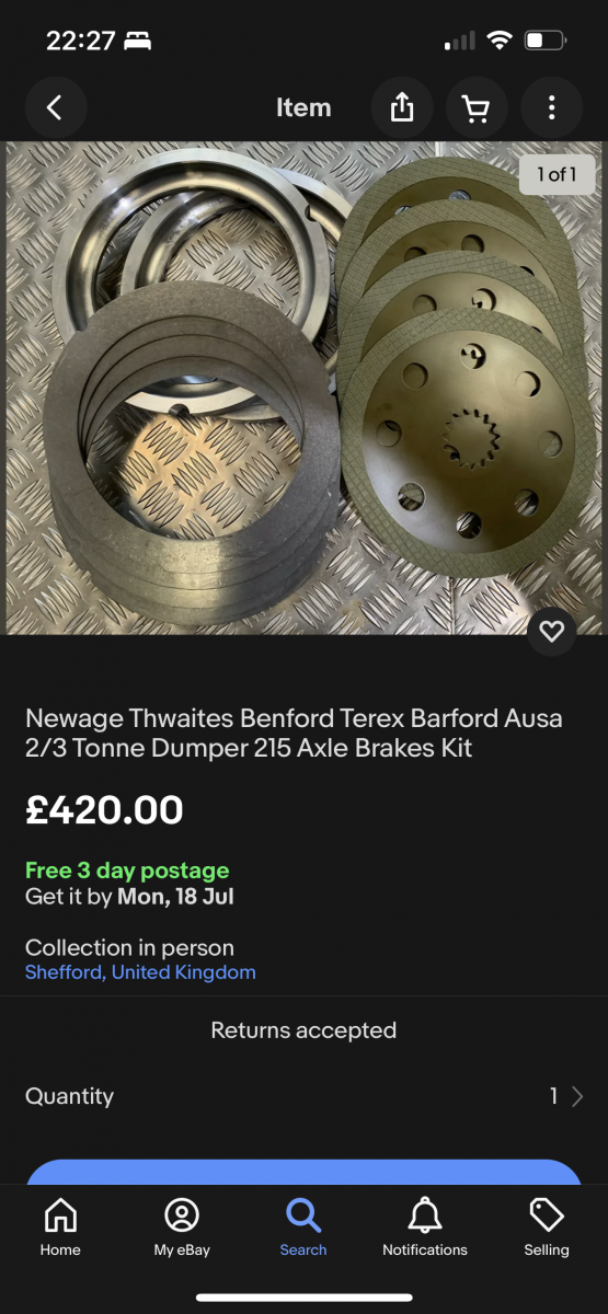

And while we are on it brakes on 3 ton thwaites sounding bad and crunching a bit and letting it forward again in steep slope and loaded.
Is it big job on the thwaites? Seen kits on eBay for £450 ish for series of disc etc.

Neuson will creep if in forwards or reverse mine always has. But in neutral it should put the brake on itself after a few seconds it will creep until the brake comes on. If the brake works on the switch but isn't working when in neutral could it be electrical?
Mick-the-fitter
Mick-the-fitter
It’s what I do!
Yep works through a timer relay, and f/r lever, but also the throttle switch has to be set up, so when no throttle brake on.
