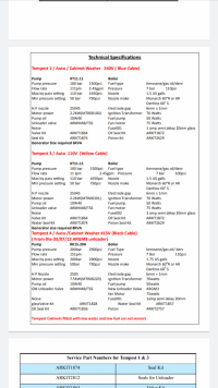

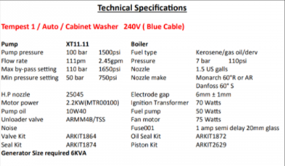

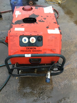

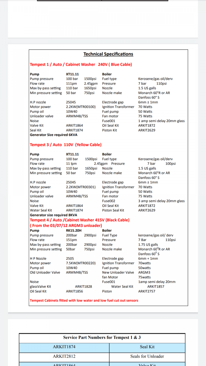

I have one of them demon tempest hot and cold pressure washers, from looking at the manual it needs 6kva to run it, heater is run off diesel or kerosene.
Never used it, no idea if it works or not, took a punt on it at an auction and never did any more with it other than rolling it to the back of the garage

unusual for it to be either .... nozzles are usually different bores for 28 or 32 second fuels
looks very similar to my old Andrews hot/cold .. and that was brilliant -- ran on red ... but needed a pressurised water supply ... wouldn't run from a drum and deffo would not pick up from below it ... was something like 15 or 16L/m - 180 bar

To be fair not looked into it, but assume it's different jets for whatever fuel

yeh two nozzles listed but think they're both the same size Matt @pettsy could probably shed some light on those numbers, but think the Danfoss is a kero number
