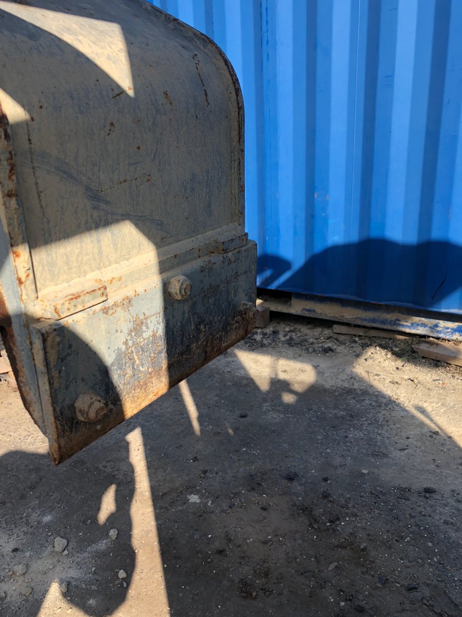

Mog & Leaky did a great job on one some time ago, but only got the one pic from him
