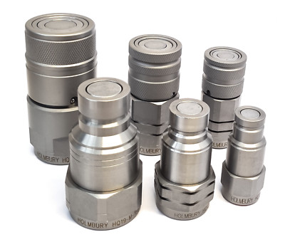

My logical head says when ordering flat face fittings you’d take the actual fitting size as the bit you want?

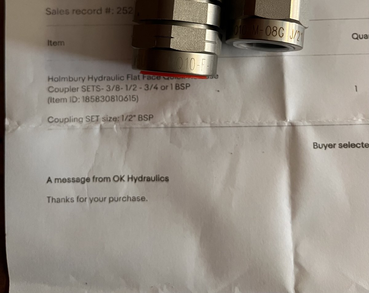

I ordered a 1/2 of the fella and got sent 3/8th fitting with a 1/2 thread…. To me that’s just wrong?
To be fair he hadn’t specified where his measurements were take from but the holmbury guide says they are 3/8th fittings with 1/2 thread? I have told him he needs to be more spesific in his listing.

View attachment 69392View attachment 69393
very difficult things to buy remotely ... need to go with the rated body size (and DN [HQ in his table] number in some listings) ....... so many variations :mad:
looks like you needed the HQ12-F-08G
Yep. I just realised some of his listings are really vague and some have sizes in etc which is odd.. will just reorder and keep for spares.
The faces have designations in multiple standards. DN and ISO are the most common.
So when ordering you order ‘DN06 with a 1/2” bsp thread’
However, I’ve had issues where suppliers don’t use this and say ‘so you want 1/2” body?’ This drives me nuts as literally no part of a DN06 body measures remotely close to 1/2”.
Using fractions as the denominator for both the body and thread is begging for misunderstandings.
If everyone used the DN or ISO standard there would be no confusion.
More the question is if he’s marketing them as 1/2 fittings, would one naturally expect to get a 1/2 thread with 3/8 face?
Also lesson learnt, I’m just going to tell them the holmbury product code from now on!
