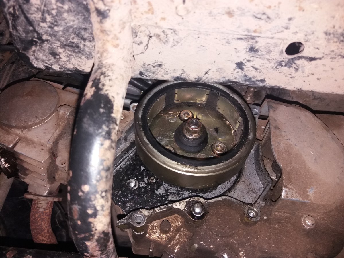

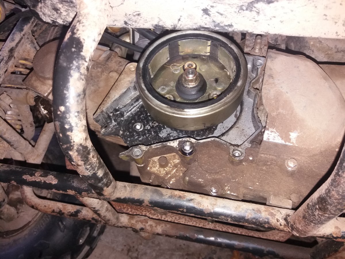

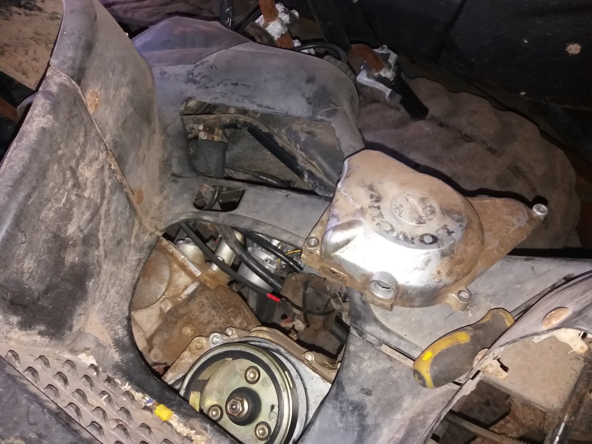

AnimalI reckon it’ll defo come apart if you dog it up to FT, it just might not go back together without some glue….
that's polite .... I was considering a few expletives before the word "animal"Animal
Which end of the shaft are you expecting to take it off?Not if you use the ugga dugga gun. Pretend it’s a formula 1 wheel change, you’ll be fine!
Just pull the whole end of the crank off and then if still tight use a big hammer and drift on the bench?Which end of the shaft are you expecting to take it off?
I thought you wanted the pull the crank through the flyweel and off the other end!Just pull the whole end of the crank off and then if still tight use a big hammer and drift on the bench?
That would also work!I thought you wanted the pull the crank through the flyweel and off the other end!
Will doI have an idea, can you put the cases together and show me a pic from back and front when together, see if somehow you can put it together on the bench with the starter in it!![]()
Do you think it would last/workclean off the worst of it and put it in the dishwasher, just before you take it to be TIG-ed back together .... needs to be VERY clean for best results
don't see why not, done properly ... plenty of room on the outside to build the case up a bit at the welded joints, even add a bit of extra 'meat' perhaps, where it doesn't foulDo you think it would last/work
