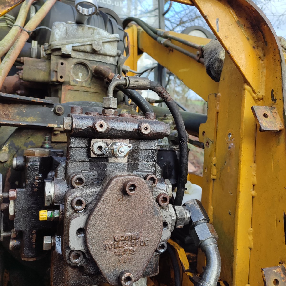

Hi all, Ive now rewired the Badger and have tons of notes to turn into wiring diagrams! I found loads of breaks in the looms! Now all valves are working but the hydrostatic drive is still not running! My understanding of it is the low pressure circuit is a closed circuit that controls flow to the swash plates on the high pressure open circuit? So would this mean as ive had the pump and valves off that the low pressure closed circuit be empty of fluid and needs bleeding to get fluid into it? I know the high pressure circuit dumps back to the tank, But the closed circuit dont, So no place for air to escape! Please if anyone can concur? If so where would the best place to bleed? Thanks!
Badgerman
I think I have found the problem with the drive, When I bought the machine, The bloke told me he had put a sleeve over the top hydraulic hose to stop it rubbing! Never had a thought about it until I cut the sleeve off today! Anyone else see the problem! :ROFLMAO::ROFLMAO::mad:
Unless I’m missing something it should still function as a hose if not leaking.
Badgerman
That ones on the suction side of the closed circuit, So would only suck in air rather than spit out fluid.
To be fair, I would have said the same until I received a few quotes to come look at the machine and nearly passed out! So paid for an online course for hydrostatic drives at a fraction of the price, To find that hose should not be bone dry but have a 25 Bar pressure and wet :LOL:
