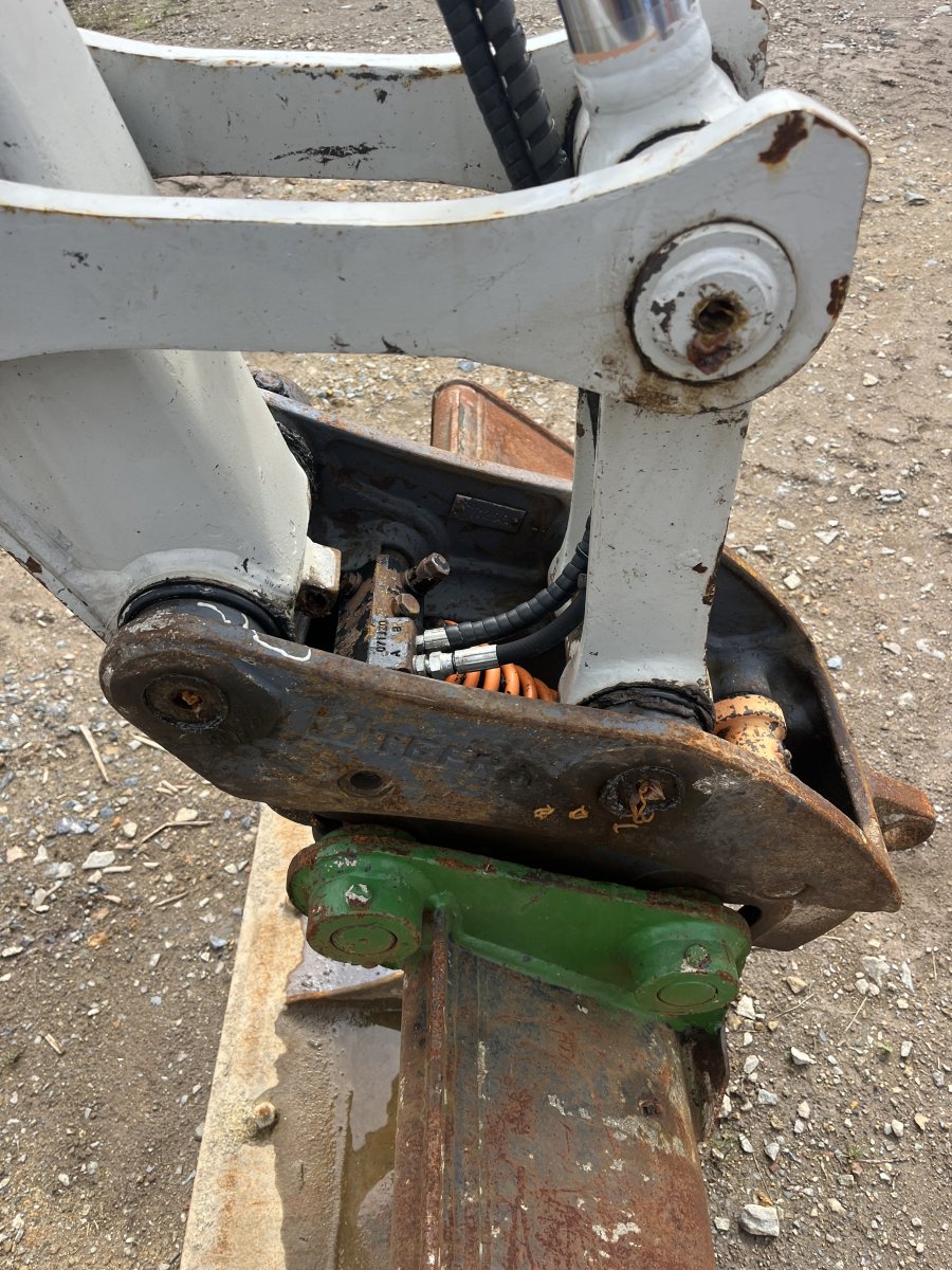

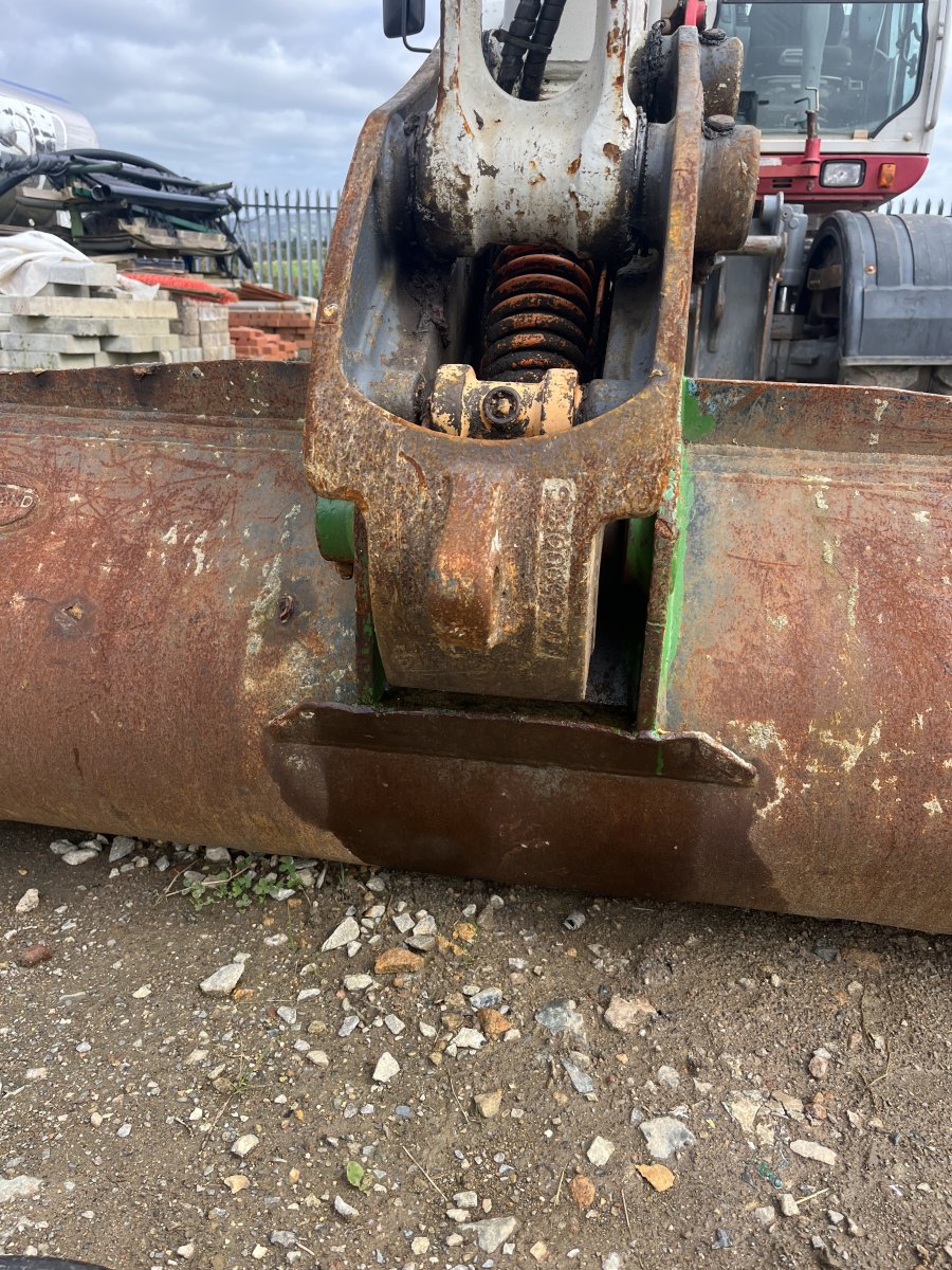

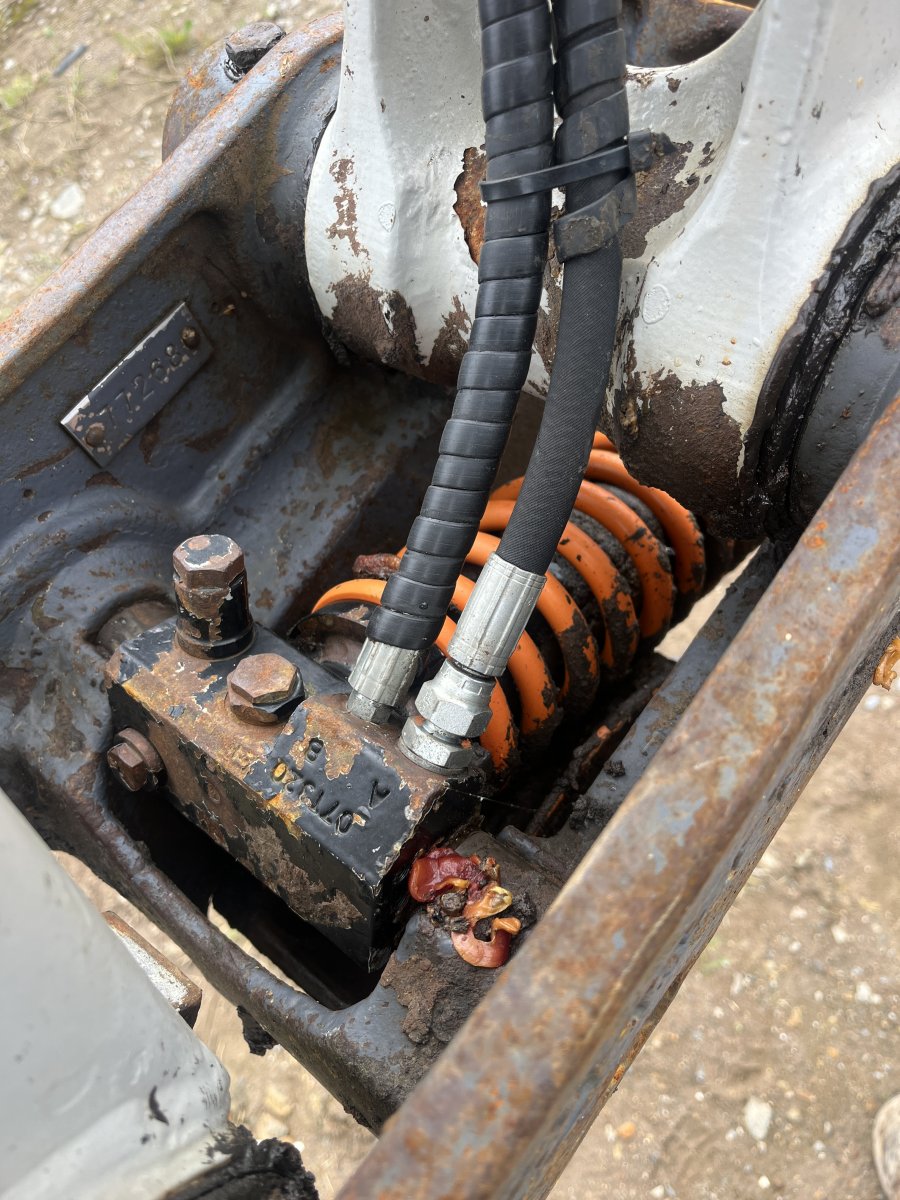

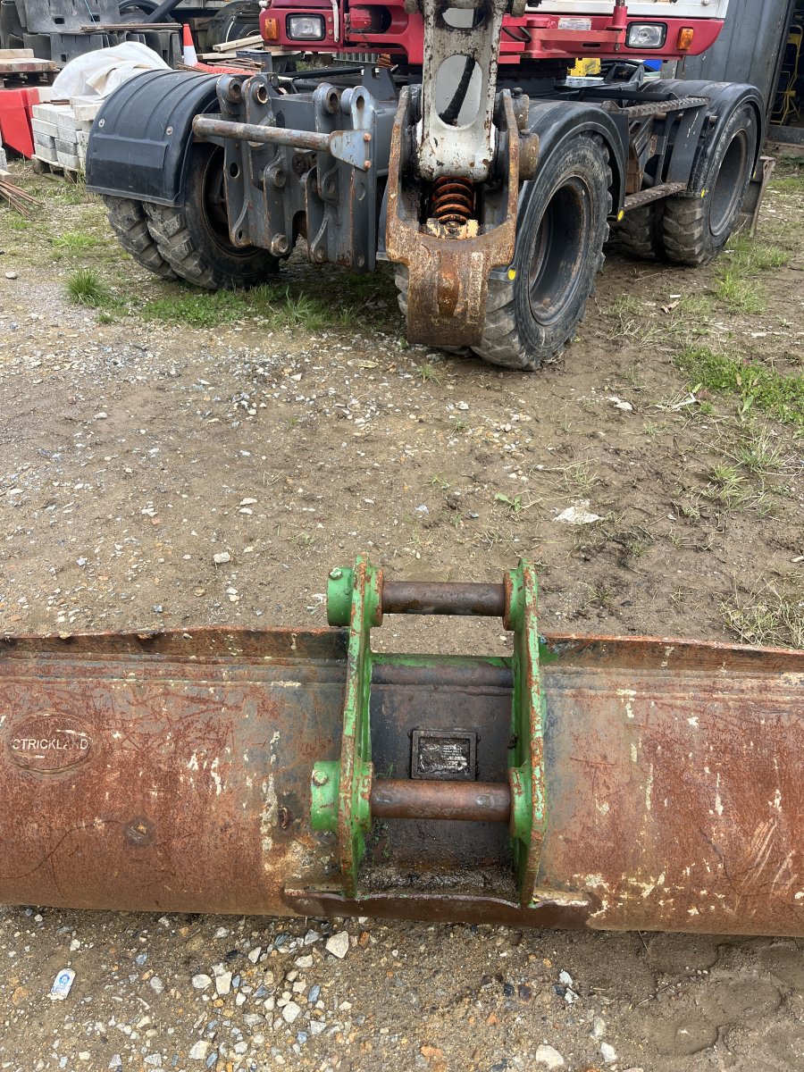

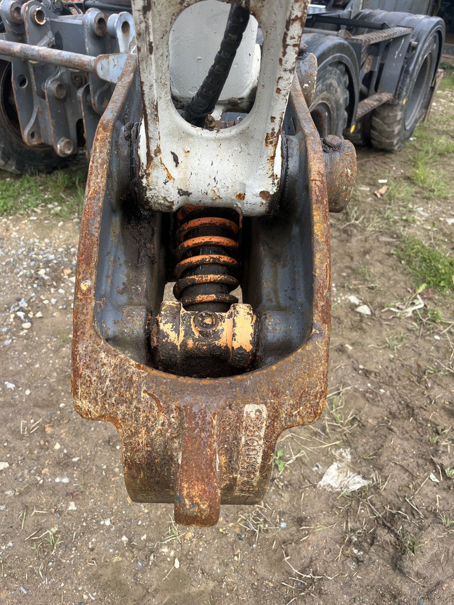

I just noticed on our rubber duck alot of hyd residue around the bucket area, but the hitch looks fine, and i can’t work out where it’s coming from. It’s a hill hitch. Has anyone had this before?

Might just weep a little bit when opening/closing up?

Its of out on a job tomorrow for a day so i will get the operator to keep an eye on it as i steam cleaned it all of and couldnt work out where it was coming from
leaking on releasing ... check valve will prevent it until release is activated?
When it’s back at the yard steam it off, then dangle it from the bottom pin, tying the tipping link out of the way. Activate the unhitch procedure a few times with someone watching.
Mine was badly crimped thermoplastic pipes. Very intermittent and a real head scratcher.
