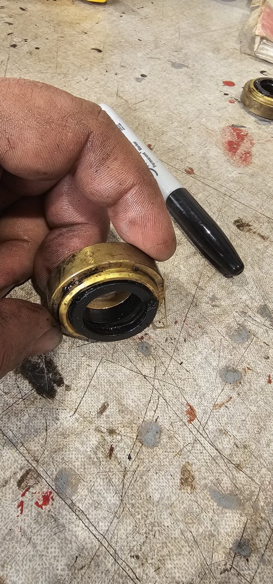

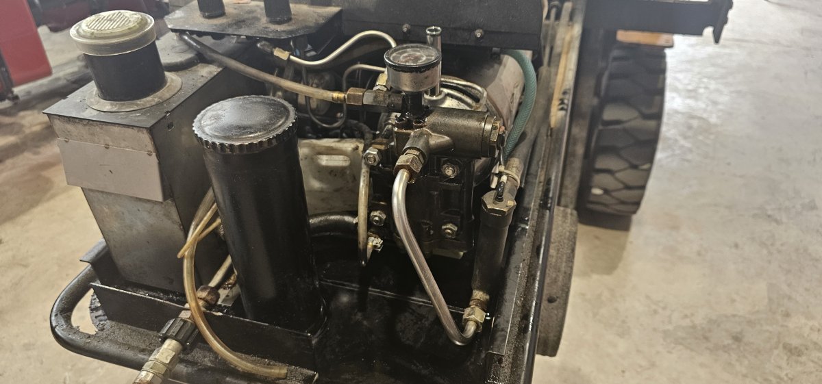

Is this Karcher knackered or is it an easy fix? It’s a big 3 phase steam cleaner and is still delivering good pressure and flow, but even I can tell this shouldn’t be leaking from here! 🤣
Would the current issue also lead to water in the oil, or is that something else wrong?….

I did out Kew that was leaking similarly and putting water into the oil.
I got a kit from perry pressure washers and changed all the seals in there the ones that came out were pretty hard and looking worse for wear, it all works fine now and there wasn't anything overly challenging in there getting getting to it was the hardest part
looks a real pleasure to work on :(
