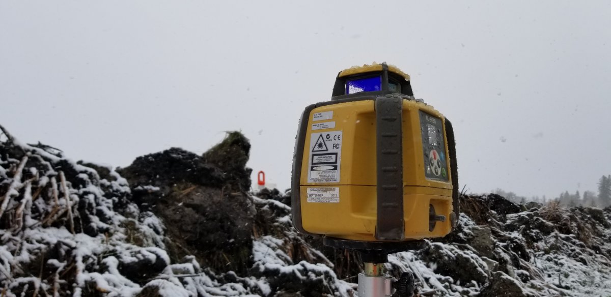

I have a topcon with single slope function that I use to lay sewer pipes with and been researching arm mounted receivers for a good one from spectra that has a plumb feature which most dealers come in at just over a grand to buy plus has a in cab screen also

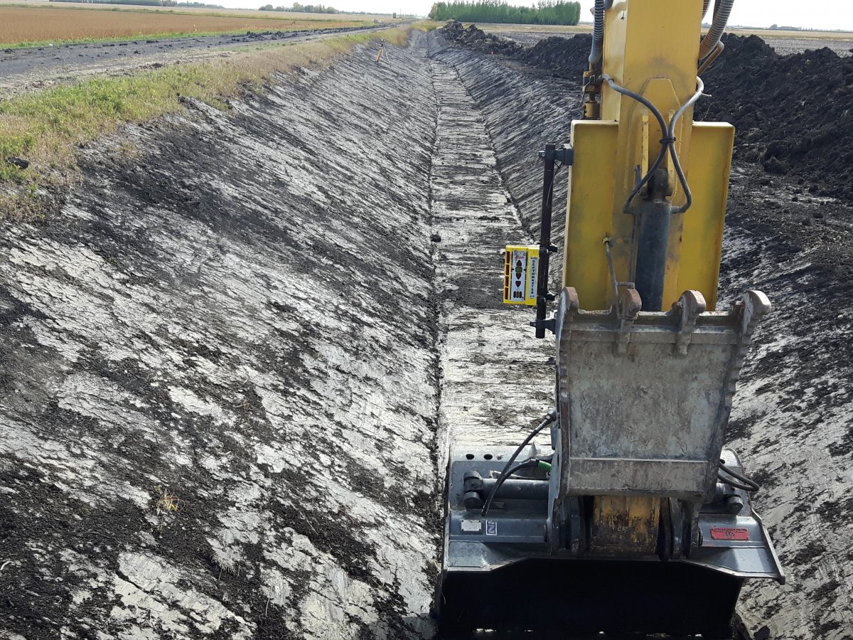

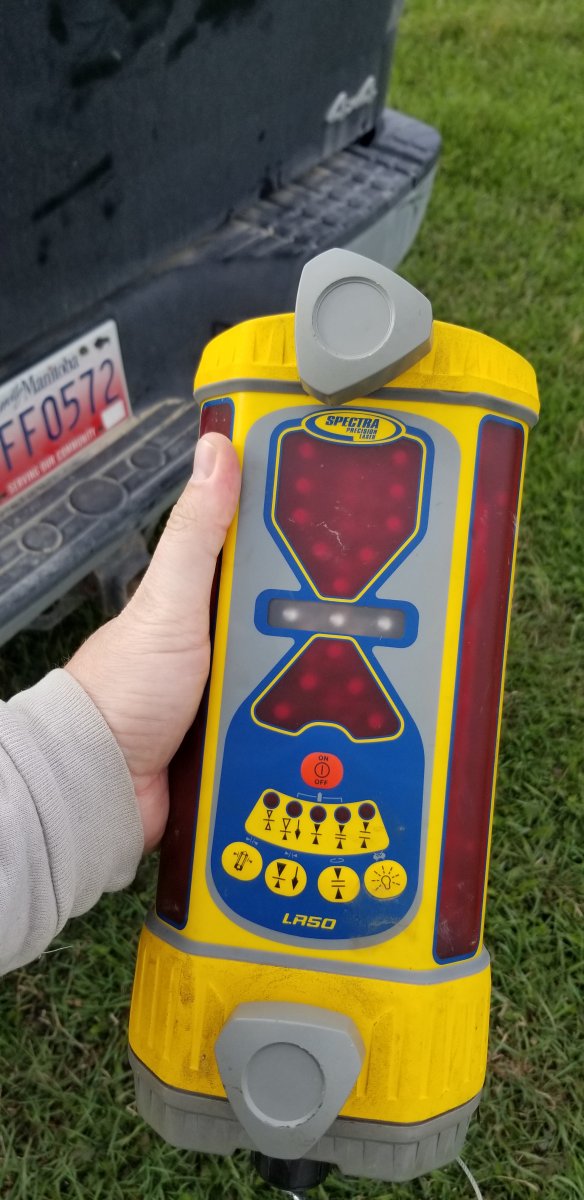

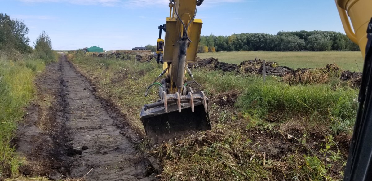

We've been using machine mounted laser receivers for years for everything from ditching to digging footings with the proper receivers like this LR50 I've been using for the past month or so it will indicate if the stick is plumb going in or out and from side to side. As for the magnetic bit we have a magnetic pipe that the receiver clamps to and it makes adjusting the receiver much easier as your not fighting with the pull of the magnet plus it has the added advantage that the receiver sticks out a little bit from the hydraulic plumbing. We also have a Leica receiver that I like quite a bit. When we set up we take our shots by rolling the bucket all the way open and this way you usually get a consistent shot and grade. But your grade can vary if you have a lot of wear in your bucket linkage and or quick coupler.
