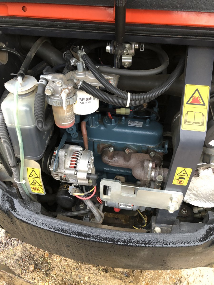

Send photo of engine with bonnet open, I will mark it for you,

My case mini, all the fuel pump etc. Is facing you. On the kubota mini its like the photo.🤔😣😁

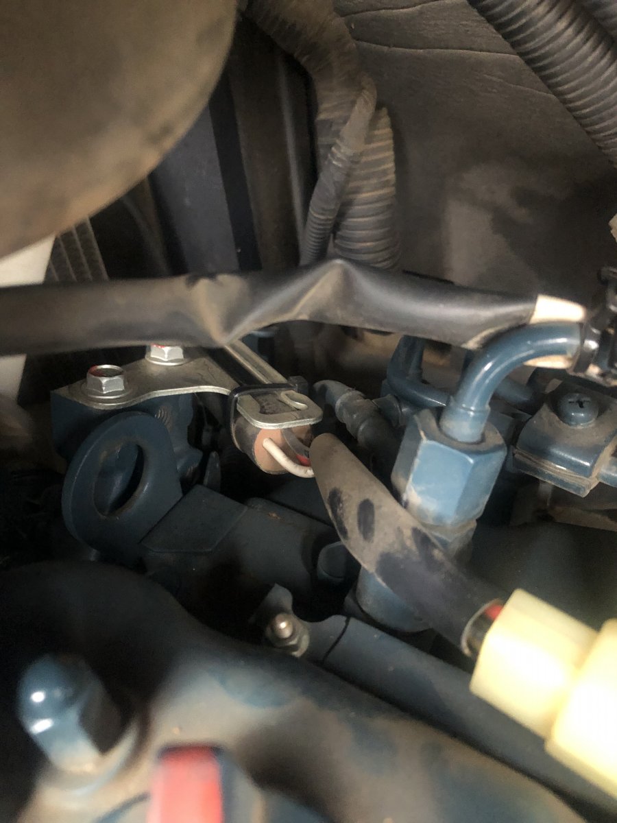

So I don’t seem to be having a lot of luck on here…. Is this the fuel solenoid with the three wires going to it? Something is draining the battery on this machine and I’m wondering if this is the culprit…. Charging up as I speak and I have unplugged this item…. Will plug back in when charged and seem if this gets warm with current drain

Yes that is the solenoid, you can unplug it, and manually operate the end of the lever to run or stop! Try it!
