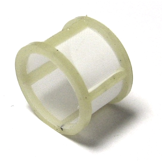

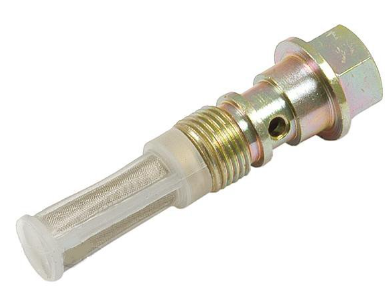

have you checked for gauzes in any banjo unions -- they're worse culprits than in line-ers for starving fuel
don't often see an internal gauze ... usually external like the above around the bolt, not inside it - but they do exist

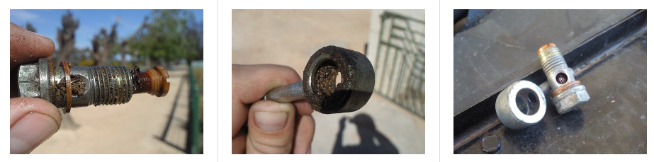

as do these

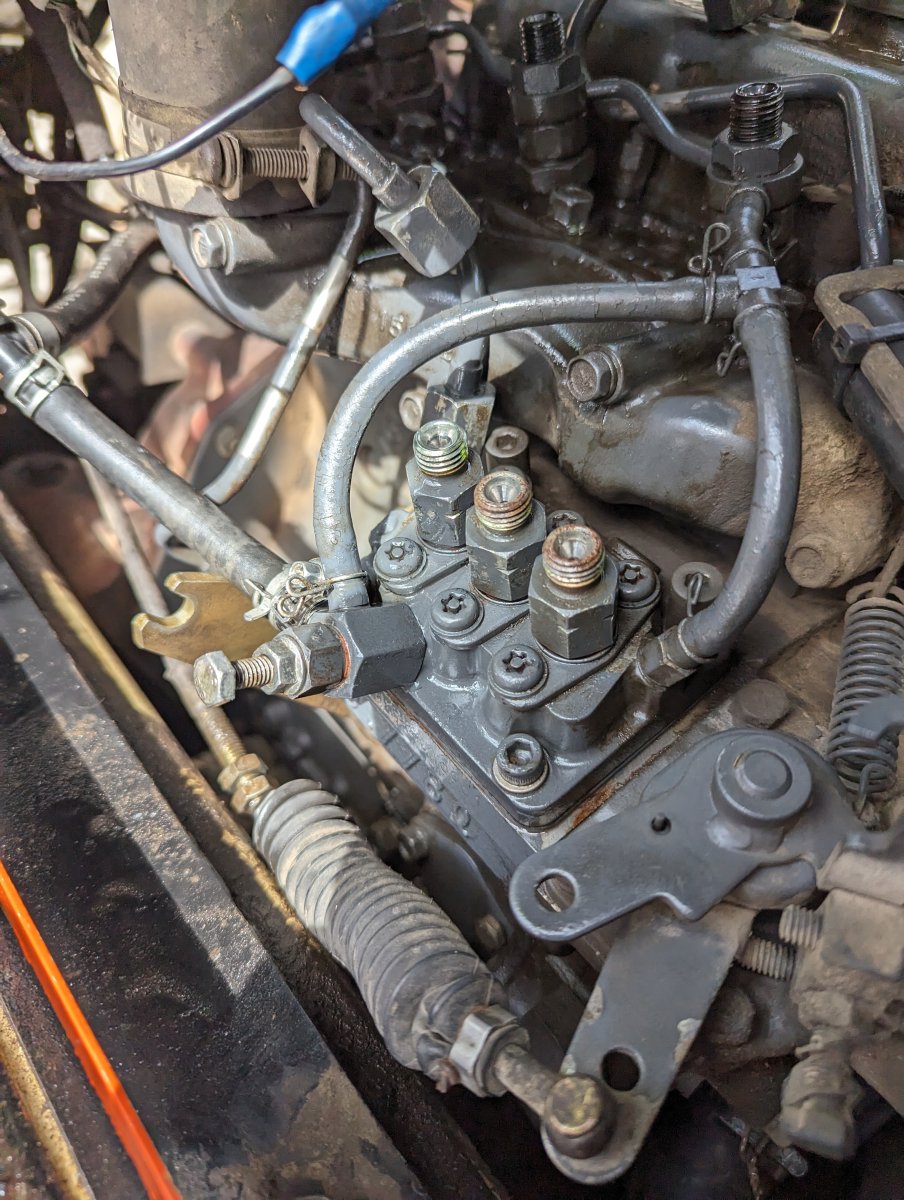

Had another look at this today (only been ten months)

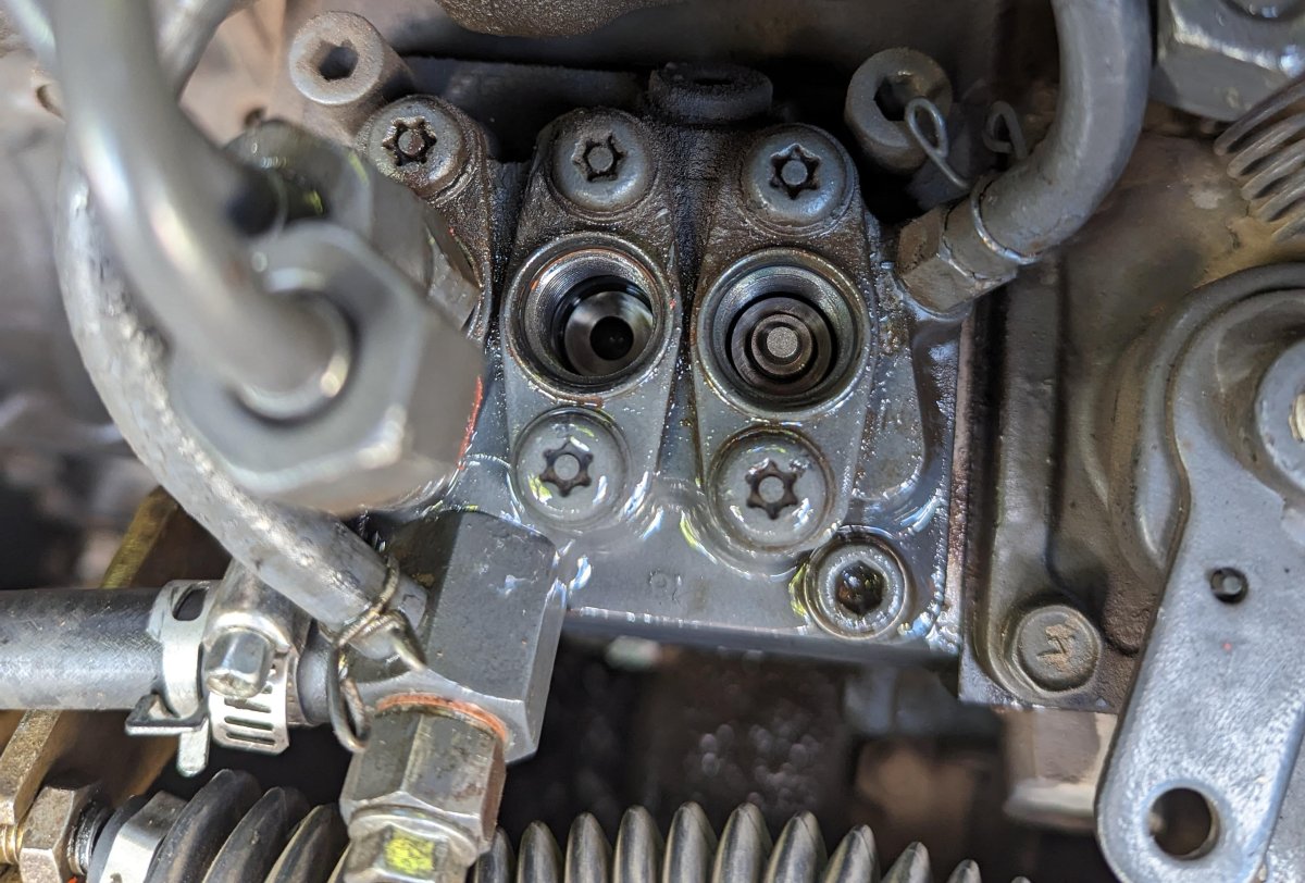

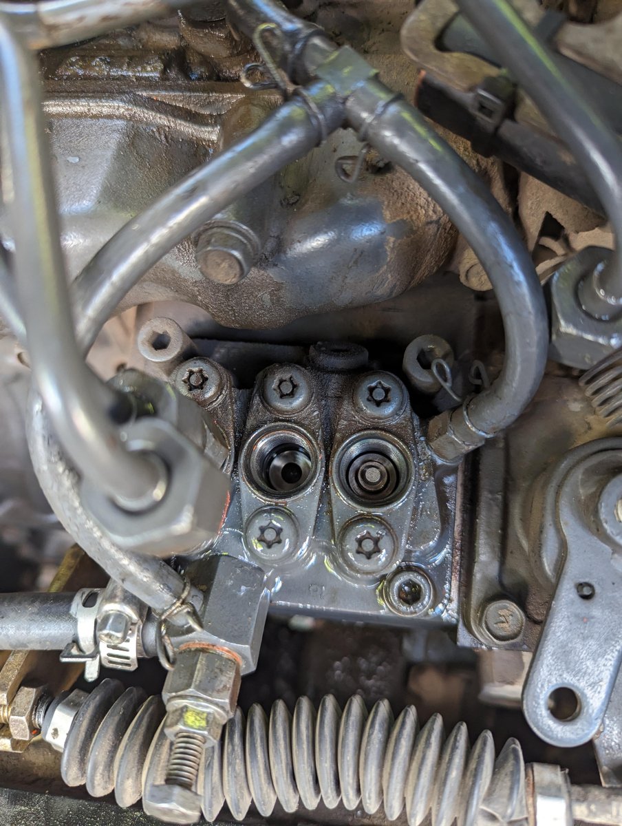

Took much of the fuel system apart looking for these filters^^. Put it all back together and it is not running on all cylinders and very quickly dumps a LOT of engine oil out of the breather. Can’t work that out at all so take it apart again and find this at the injection pump - middle port is different to the outer two.
Looks like I have missed a part or put it together back to front?

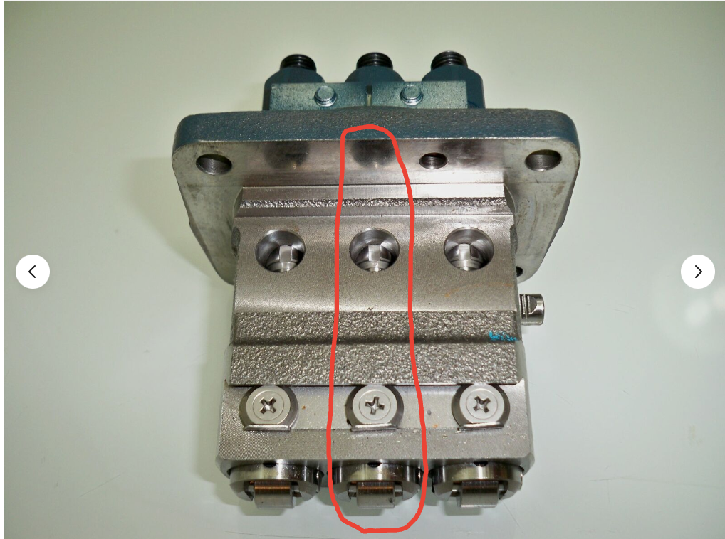

Find this pic on google, looks like rod/plunger has dropped down too far. Could this be causing diesel to be pumped into the crankcase?

Does it have the D782 engine? I think I read somewhere else that they had pump issues, seem to remember it was a common enough problem that you can get a pattern rebuild kit for sensible money.
Yes that's the one.

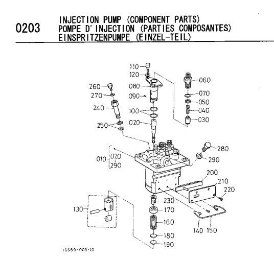

Just found this parts diagram from the injection pump.
I'm looking at that now thinking part 030 is missing and fuel is passing straight through, I don't know if that goes to the crankcase.
Definitely need to find that part, must have dropped down below the engine :(

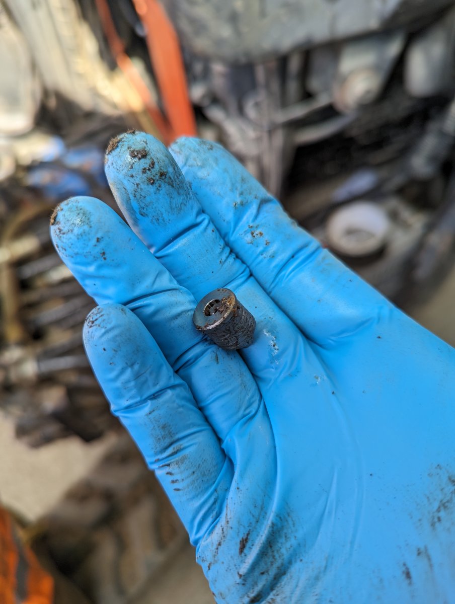

Actually managed to find it amongst the crud.
Fitted it and put everything back together expecting to run ok after bleeding but not getting any fuel last the injection pump.
Getting to the inlet but nothing out at all, any ideas??
