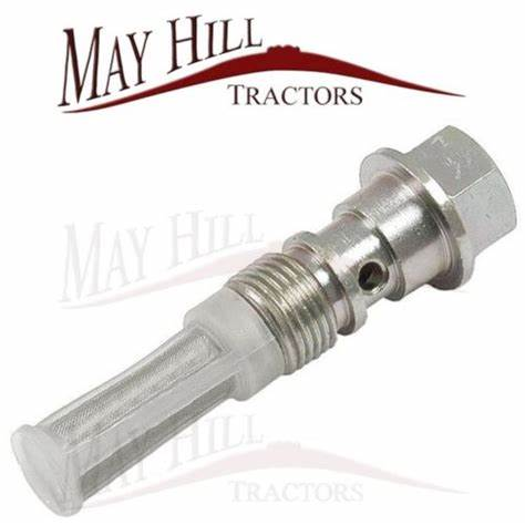

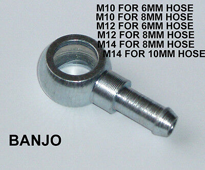

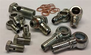

a banjo bolt is a 90 deg. fitting in a line

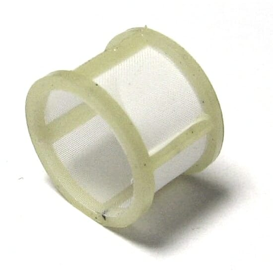

filters are sometimes one of these types
or around the bolt body inside the banjo itself
can't find a pic of one in situ
they're pigs to find and block very easily
