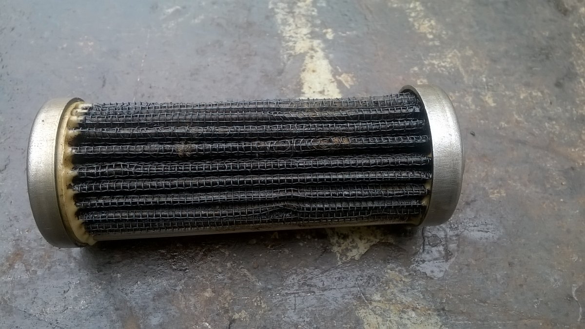

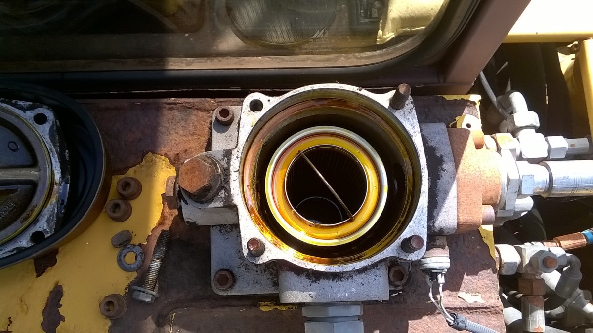

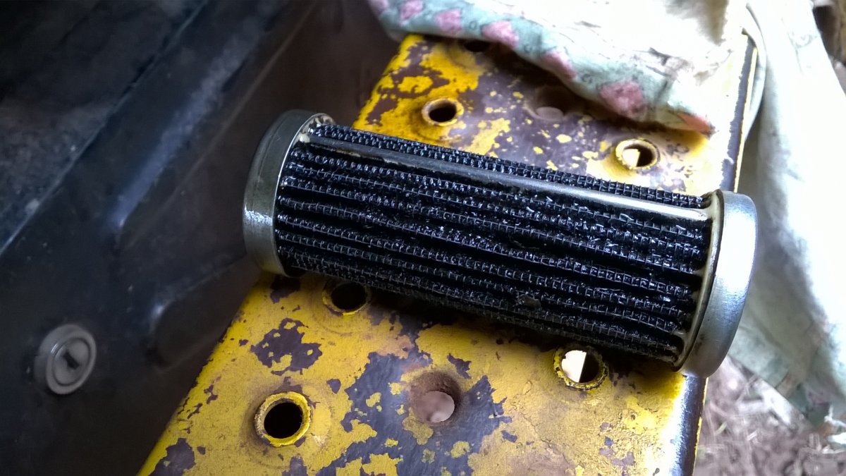

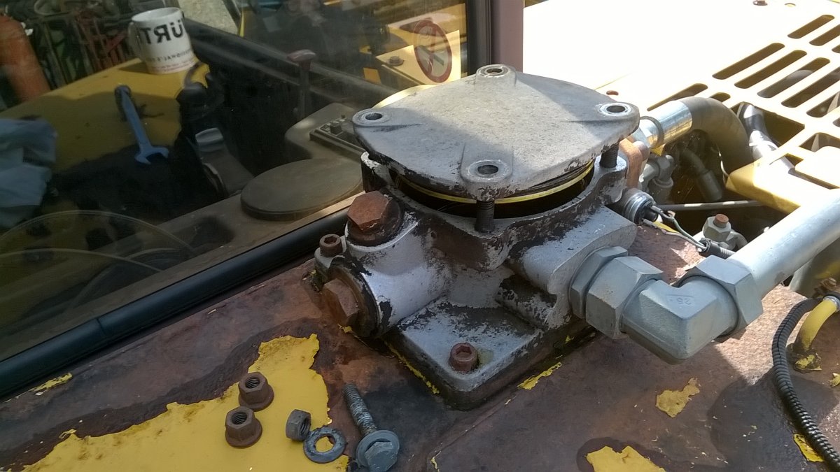

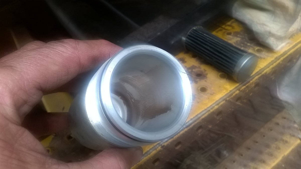

WP_20200824_14_34_51_Pro.jpgWP_20200824_14_53_25_Pro.jpg WP_20200829_18_29_26_Pro.jpg

my pilot is tiny too in comparison and got a damned good wash out and blasting with 150PSI when the main got changed a while ago .... was a hell of a lot cleaner going back in and didn't get anything major out of / off it .... ought to get her a new one sometime :rolleyes:
WP_20160902_13_42_30_Pro.jpg .. WP_20160902_14_25_42_Pro.jpg .. WP_20160902_13_42_07_Pro.jpg
screws onto the back of the main servo valve that kills the system on the dead man and feeds all servo pressure operated circuits
